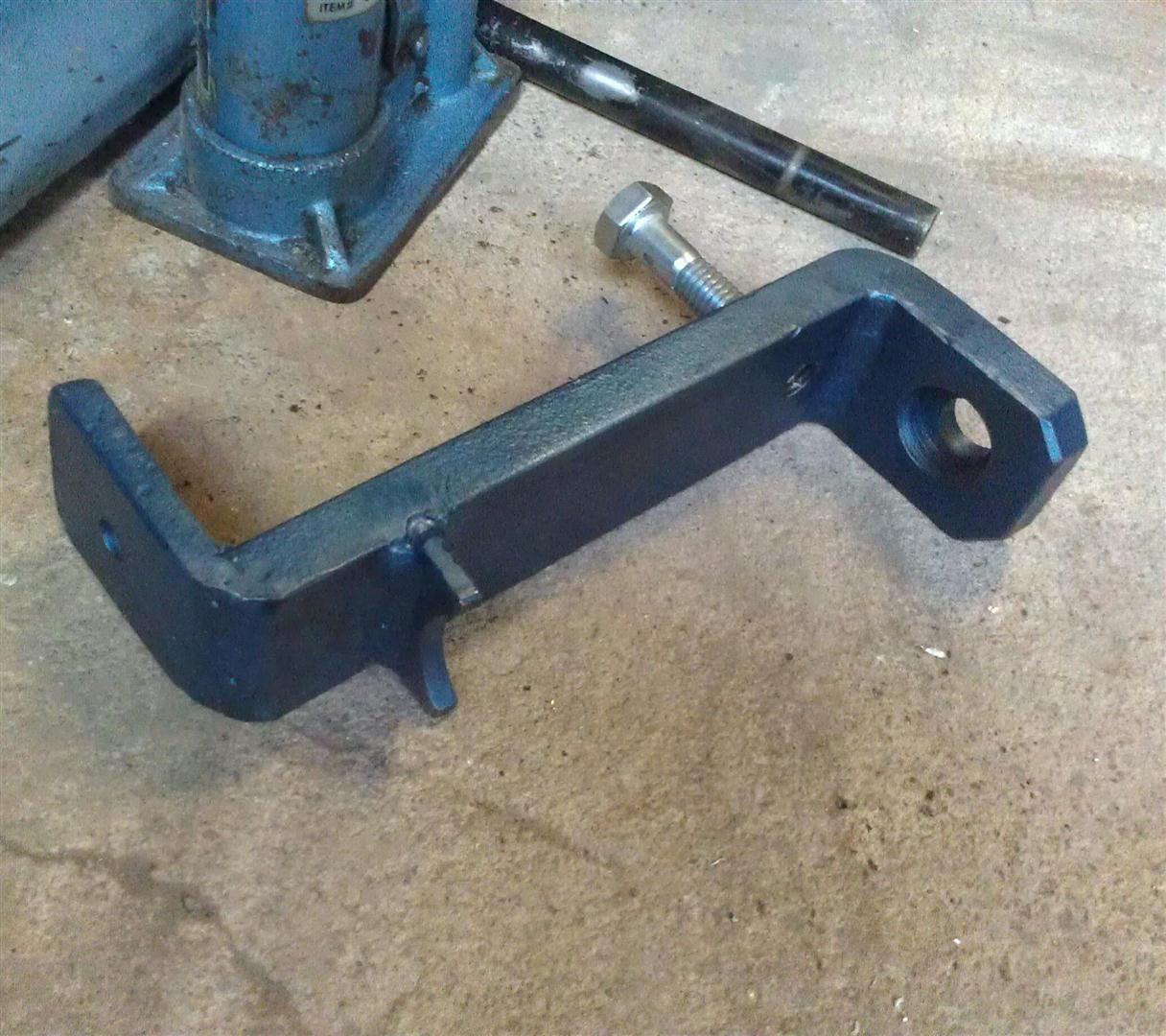

I Have a small cheap 2 metric on bottlejack. Sometimes a small toejack would be nice. Doeas anybody has a simple, but effective toe jack palns or picture to share?
I have seen some  some pictures of very crude ones, that put load on hydraulic slinder rod/seal. I don't like that. Then I have seen a picture of the one that must be a functional, but a bit overkill with all machined slides etc. I can relae to that, but this is chinese jack, I'm not going to chrome it.

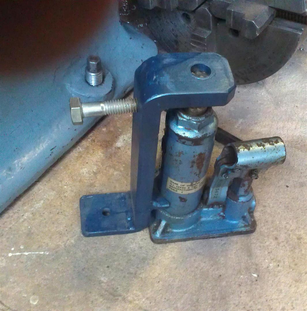

« Reply #4 on: January 01, 2016, 09:20:10 AM »

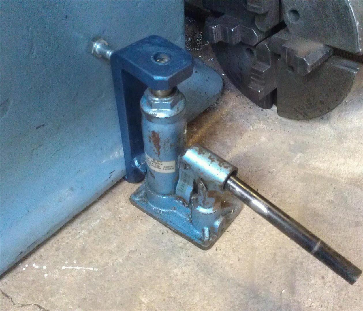

Here is a simple one I made. Someone copied it and found that it was better to have a baseplate with the 'toe' cut out to go under the machine.
Cheers,
Joe

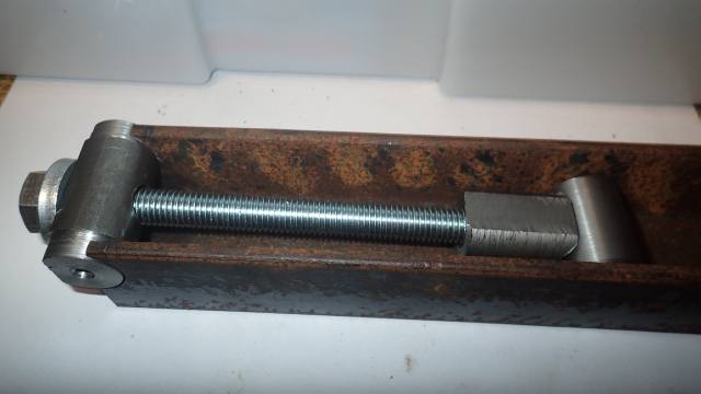

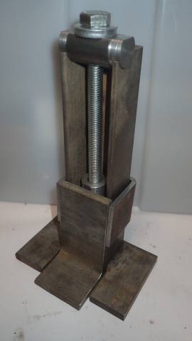

Last week was busy, but made a sketch of traditional hydraulic toe jack. Bought cheap 2t bottle jack and checked it. I could not trust it to support any load near my fingers - clogs, wedges and timber.
Therefore "Plan B": Screw jack type.

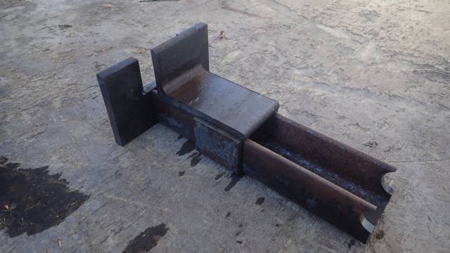

First scissor jack I checked seemed to have nice thread but plastic nut...don't get me wrong, I think that plastic can be used an lot of stuff but I would not buy cheap lift and use it, sooooooooo I looked up on table of the metric screws and whilst M10 seems to be a little marginal to lift one end of the 1t machine, M12 seemed to have enough security. Some more doodling and quick visit to local nut n' bolt shop produced 180 mm thread length M12 bolts with 19 mm AF hex. I wanted to have normal hex head - easier to use standard ratchet wrench and avoid using bar, etc.
Hard look on the corner of my dungeon and with a bit digging I found 50 mm C-channel, 40*100 mm L-section, flat bar and round bar. All hot rolled and least somewhat weldable. Hardest part was to decide how to mount the screw to minimize side load - all tables assume that the bolt/nut is mostly in pure tension (no bending). Decided to use classic round dowel nut/pivot design. Now this 180 mm length does not look too long anymore....on my disposable all welded structure there were no problems to reach effective 100 mm lifting height for dolly, but half way I got this idea of making it more professional and easier to repair and I'm watching my daylight disapearing. Also I found that one 25 mm bar that has carbon inclusions and eats my drills....now I have to paint/mark it to be used only where crappier iron will do.
Got to the point where I'm having most parts ready.
pekka
Re: Simple DIY toe jack plan?
« Reply #6 on: August 29, 2016, 03:30:23 PM »
Just got home - and it is about to hit the hay or tomorow will be even more proverbial....
Here is a consideration: How well stick weld will hold hot rolled parts together: I need to weld the bushing into "toe" to allow a degree of movement for the barrel nut. Longer the weld, stroger it will be, but at the expence of the lifting height.
The part is now near 30 mm long, two beads, both sides? If I could cut it 20 mm long it probably would allow just enough height.
Or I could buy 8.8 grade all thread and weld long nut to it if it really comes to that. But I like standard parts.

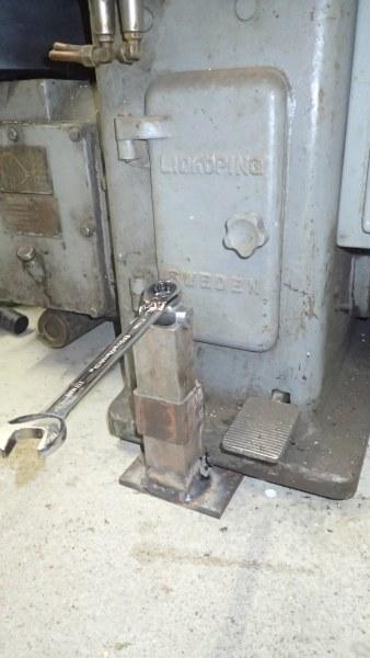

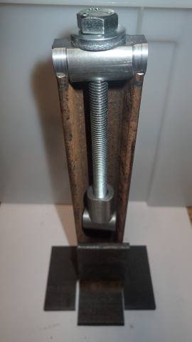

« Reply #7 on: August 30, 2016, 01:52:47 PM »
Bit more progress. One hour goes fast.
There is some extra material on column. One retainer and some minor features left, but at 100 mm lifting length is a bit marginal.

« Reply #10 on: September 02, 2016, 03:51:51 PM »
Pickeled hot rolled parts in vinegar overnight...better, but still some slag left. Looks like in the summer overnight is enough.
Took a picture and then sprayed them with steam washer, almost all came out, but dunk them overnight.

First jack has been waiting welding - my brother normally welds stuff for me. He has better welding machines and training. I have only 160A inverter, 3,25mm sticks are max.

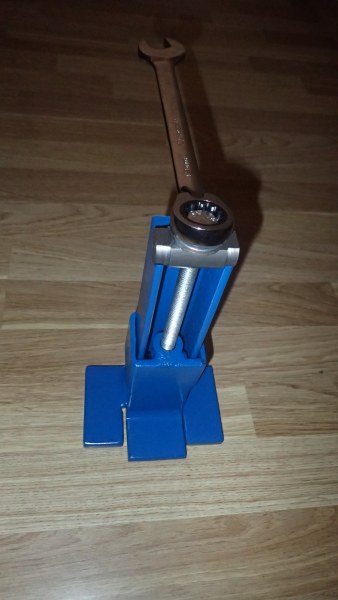

« Reply #19 on: September 22, 2016, 01:50:22 PM »
Like waching paint to dry :D
On Monday I visited brother and he welded parts together. I tested it today and it seemd to work. There were some scratches at the back of the column. Filed some corners down and now it looks like it would work.
Still thinkking how to shape toe. It is pretty long now and will not help stability.
I'm wondering if paint would hold on it. Probably light phosphating would work better.

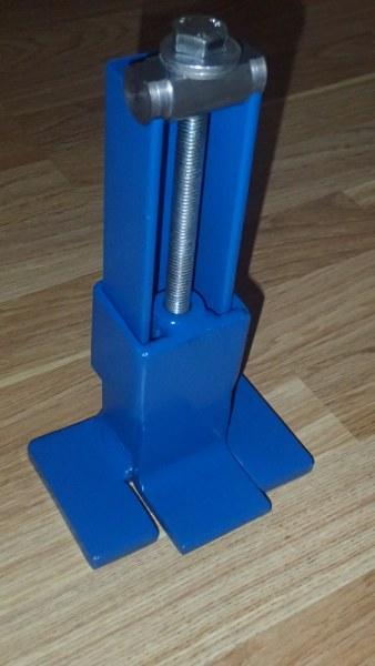

« Reply #20 on: September 26, 2016, 02:02:14 PM »
Let's beat this to death. Dead beat?
Sprayed it with 33% phosphorous accid, let it set for an hour, put it oven to dry and painted with firs spray can I found. It's very blue.
« Reply #22 on: September 27, 2016, 01:55:45 AM »
So the phosphoric acid spray was just a simple phosphate passivation?
