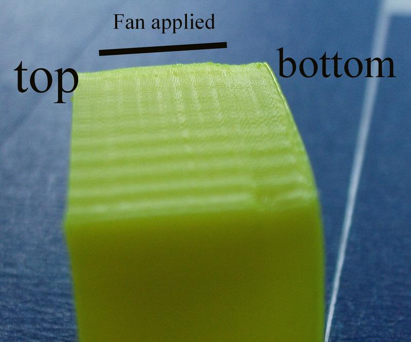

While perusing youtube last night I found a chap talking about cooling fans for the work piece and how it improves the print. I played around with this today (while waiting, fruitlessly for E.on to fit  new smart meters) ,  and boy! does it make a difference.    just waving a small fan at the test cube straightened up the sides .

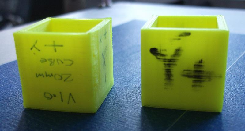

Bouyed on by this I designed and printed a fan adapter , and now I have a cube  that is 20.33 x 20.42 x 20.02  with beautiful straight sides .
Im not sure if I can just adjust the X&Y steps per unit or whether there is a better/correct way to tweak it to size ??????

The size is probably within normal tolerances for an FDM printer.  You need to test whether the extra material is a hardware issue or an extrusion issue.  If it's hardware related, you can use regular machining techniques to measure it.  If it's an extrusion issue, you can experiment with different settings in the slicer software or possibly in the firmware configuration file.  Have you mentioned which slicer software you're using?
