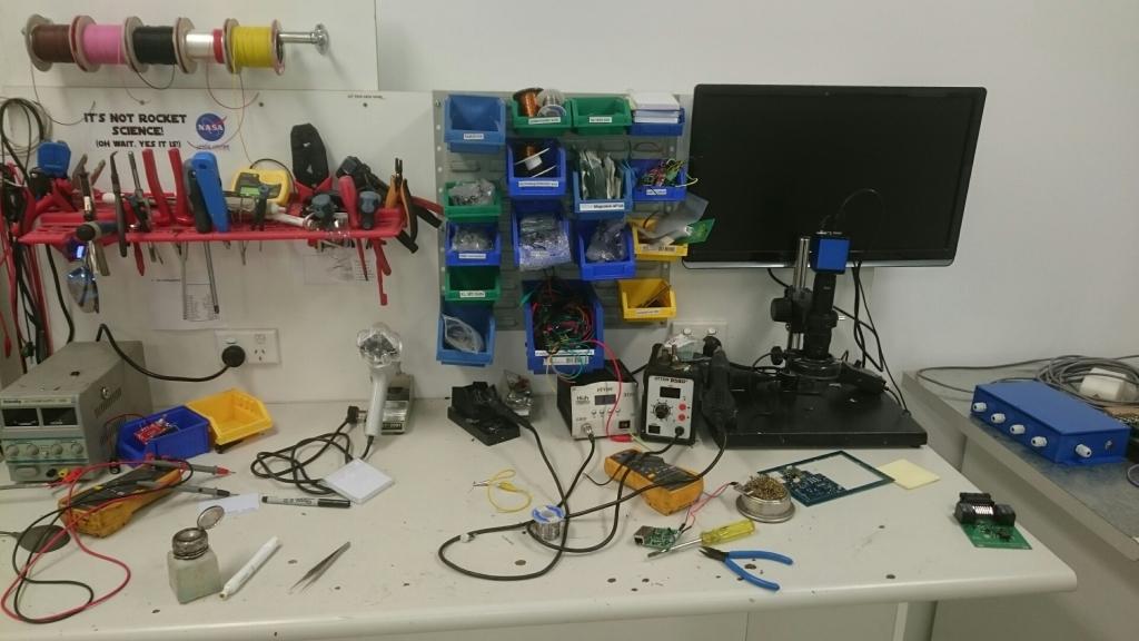

Thought it might be relevant to include a shot of our rework bench. This is where a lot of hand soldering happens.
From left to right.
Little PSU for bringing circuits up and testing them. (Current limiting is an absolute must have)
Fluke 115 Meter, we have a few of these, they are cheap and good.
Pot-o-flux and flux pen applicator. These little pump pots are handy, we use a bigger one for IPA..
Vacuum desoldering iron. Mostly crap, we don't use it much.

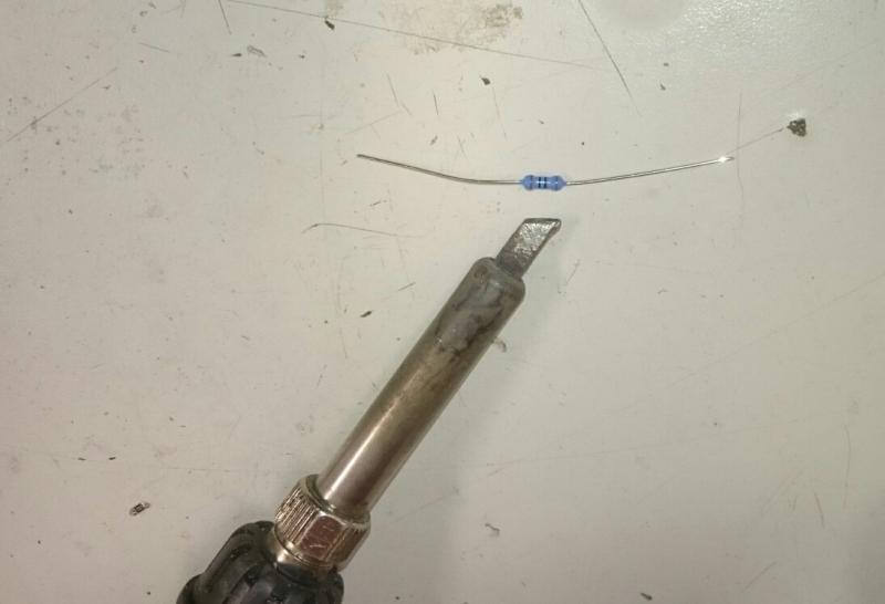

Atten inductive heating soldering iron. This thing is just fantastic, see below for a pic of the tip that pretty much lives on it next toa 1/4W resistor.. We solder quite a lot of 0.5mm pitch TQFP packages with that tip.
Another 115. (I said we have a few of them)
ATTEN hot air station.
Brass tip cleaner in holder.
Video microscope. This thing has a 2K output camera on it and a zoom lens. I often pull the whole thing forward and work under it if I'm doing anything smaller than 1mm pitch.

Looks nice
I have two Flukes too, often one has kleps and another has pointy cables.
I need to clear my table....too much stuff on it. I'm planning to hang isolation transformer under table and put two selves atop of the table to put PSU and scope there.
I have given some though to soldering "iron". I think I will partially retire my old trusty Weller magnanast and replace it with modern iron instead of buying hot air station right away.
"Atten inductive heating soldering iron. This thing is just fantastic" Is it like Xytronic LF iron?
http://www.partco.biz/verkkokauppa/product_info.php?cPath=2072_2188&products_id=16268&language=en
Another question "Pot-o-flux and flux pen applicator. These little pump pots are handy, we use a bigger one for IPA.."
Is isopropyl alcohol for cleaning PCB before soldering and cleaning no-clean-flux? Does it has to be water free (100% pharmacy quality) or is 30-50% w/ detergent quality enough?

Well, that iron has the word 'induction' in its name, so I guess so... The things we like about ours:
Tips are cheap and easy to get.
It goes completely cold if it's idle. This is perfect for us as it means we can leave it on all day, pick it up and it's hot before we can find the solder. Seriously, heatup times are in the order of 5 seconds!
