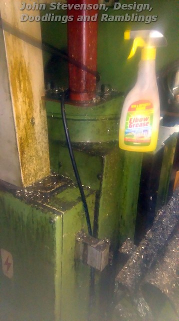

Family Bargains / Home bargains or similar chain sell a spray on bottle of Elbow Grease for £1.00
Idea on really ditched paintwork, spray on, leave 5 minutes and wipe off. You have to see the result to believe it.

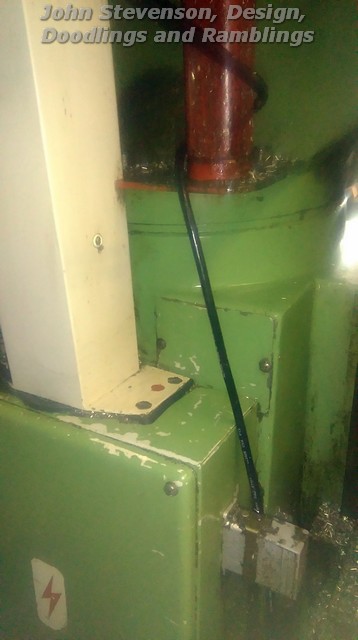

When in search of John’s Elbow Grease, having visited 3 of the correct type of store to no avail began to wonder if it was a wind up.
Eventually found it in Pound Stretcher.
Re: Degreaser cleaner
« Reply #13 on: April 12, 2016, 11:14:43 AM »
No not a wind up in fact just been round the workshop to find a dirty bit of machine.
Backside of a Beaver milling machine, not been cleaned in at least 15 years.
Spray on, leave 5 minutes and wipe off.
Speaks for itself.
