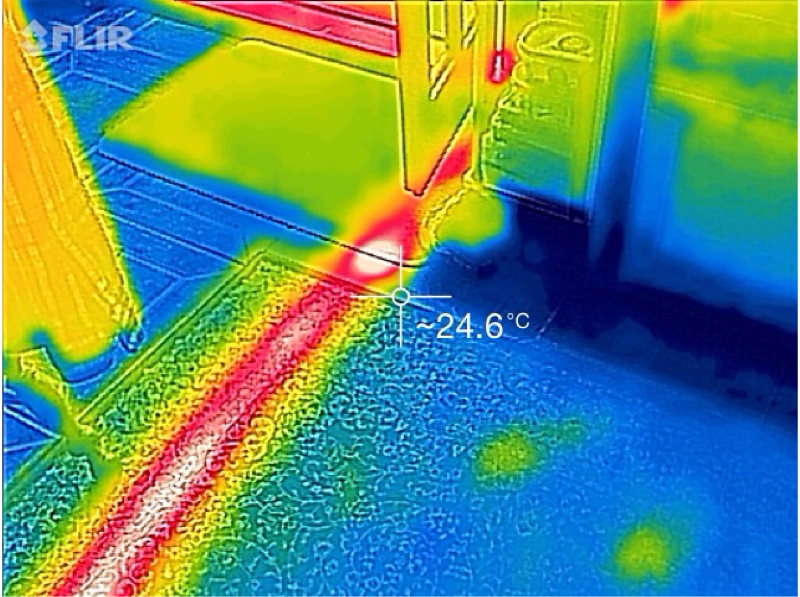

  • Posts: 1274
Re: THERMOGRAPHY...ANY HINTS?
« Reply #6 on: June 23, 2016, 01:49:48 AM »
I borrowed a FLIR One to inspect some central heating pipes buried in concrete below a tiled floor.  The camera costs around £200 and adds on to an iOS or Android device.  Is this the sort of thing you're  after.
Offline ieezitin
  • Posts: 662
« Reply #7 on: June 25, 2016, 09:29:15 AM »
Joules
PK early in this thread mentioned the same thing, i take it that's the quality you get from this FLIR Device? if it is its well worth the money spent on it.
