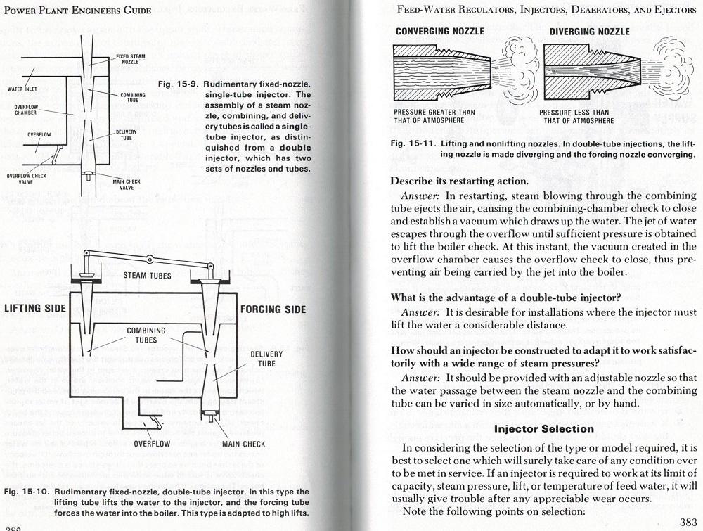

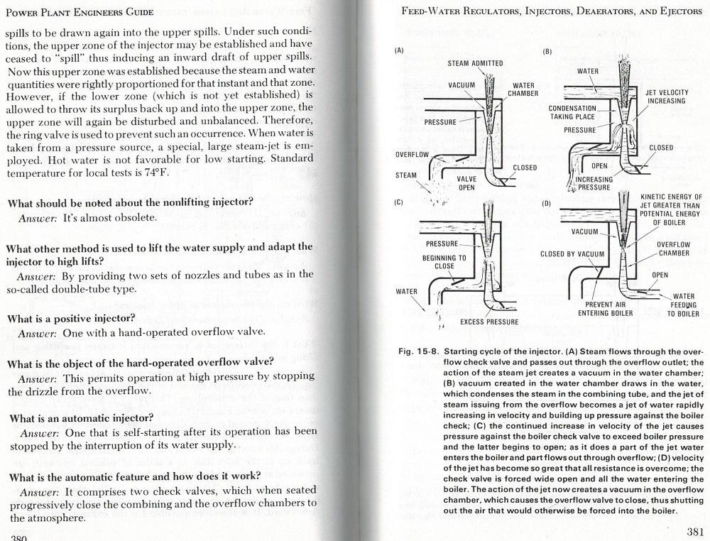

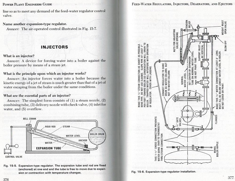

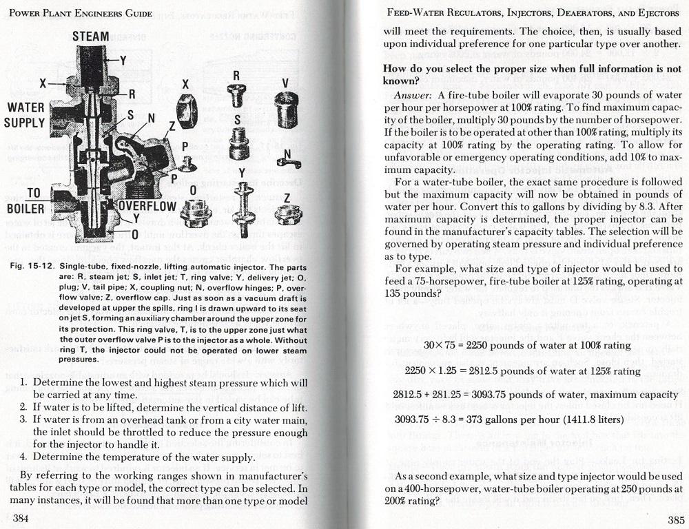

Hello PICCLOCK as a stationary engineer I recieved instruction on thier operation. They are finicky to operate and if found in a modern power plant are used only for emergency back-up. For model engineering they would be a great project. I believe Model Engineering Magazine did an article on this years ago, if you have access to an index you may be able to find it.
Below are 8 page scans from one of my stationary engineering books covering thier design, construction and operation with questions. Hope this helps. :thumbup:

Hi inthesticks
That is the best info I have ever seen. Many, many thanks for taking the time to post it. I have printed out the pages and hopefully the dark clouds of ignorance are moving away.
The info you provided clearly shows and the sequence of events initiating the process (p381), something which I have not seen explained elsewhere.

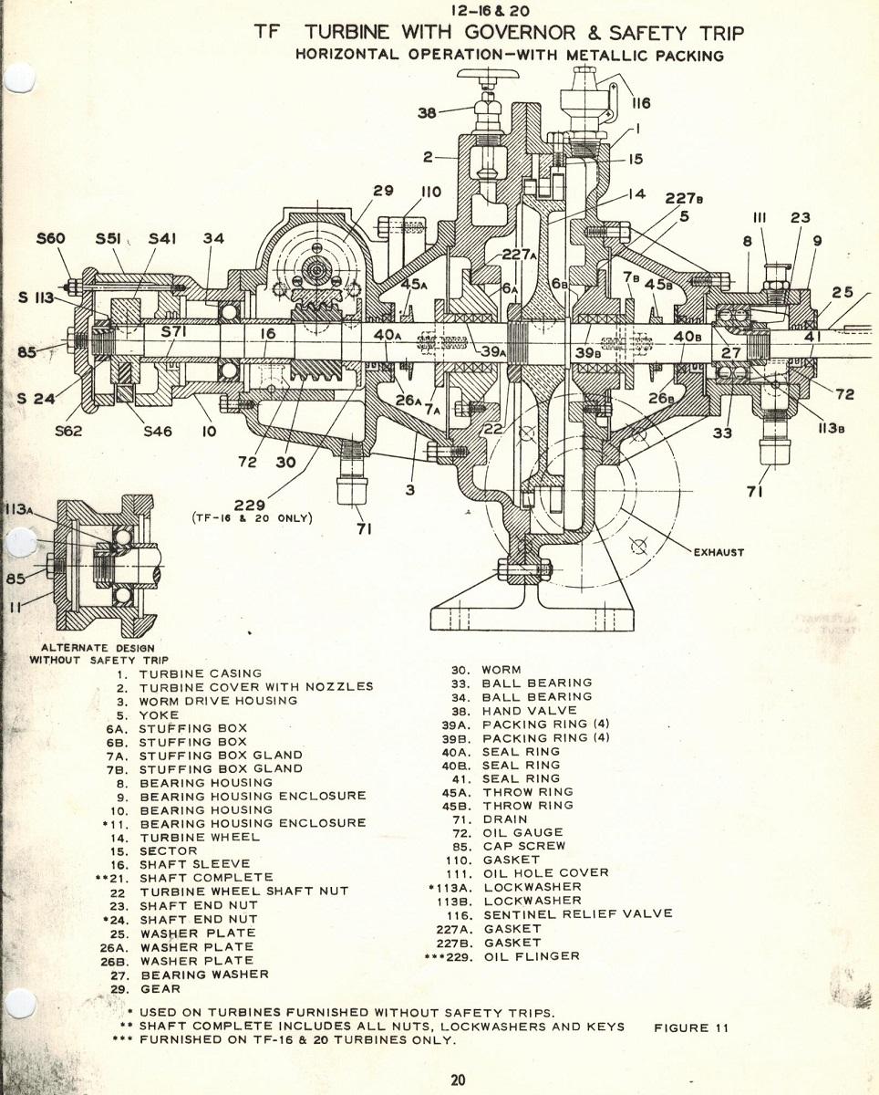

Glad you found the info. usefull PICCLOCK.You will not find injectors in lage industrial plants thier feedwater volume requiremants are to high for injectors.In smaller heating and cooling plants they can still be found. I worked one hospital heating and cooling plant with 3, 25,0000 lbs/hr. Cleaver Brooks firetube boilers.
Thier 2 main feedwater pumps were electrically driven. In the event of a power failure each boiler had its own injector mounted in its feedwater supply to provide water during the shut down proccess. Clean feedwater is important, as noted in the earlier text they will gum-up quikly. The majority of plants use electrical and steam turbine prime movers for their feedwater pumps. Steam turbines probably logging more hrs. than any other method.
Below is a section diagram of a tipical steam turbine used in feedwater service.
