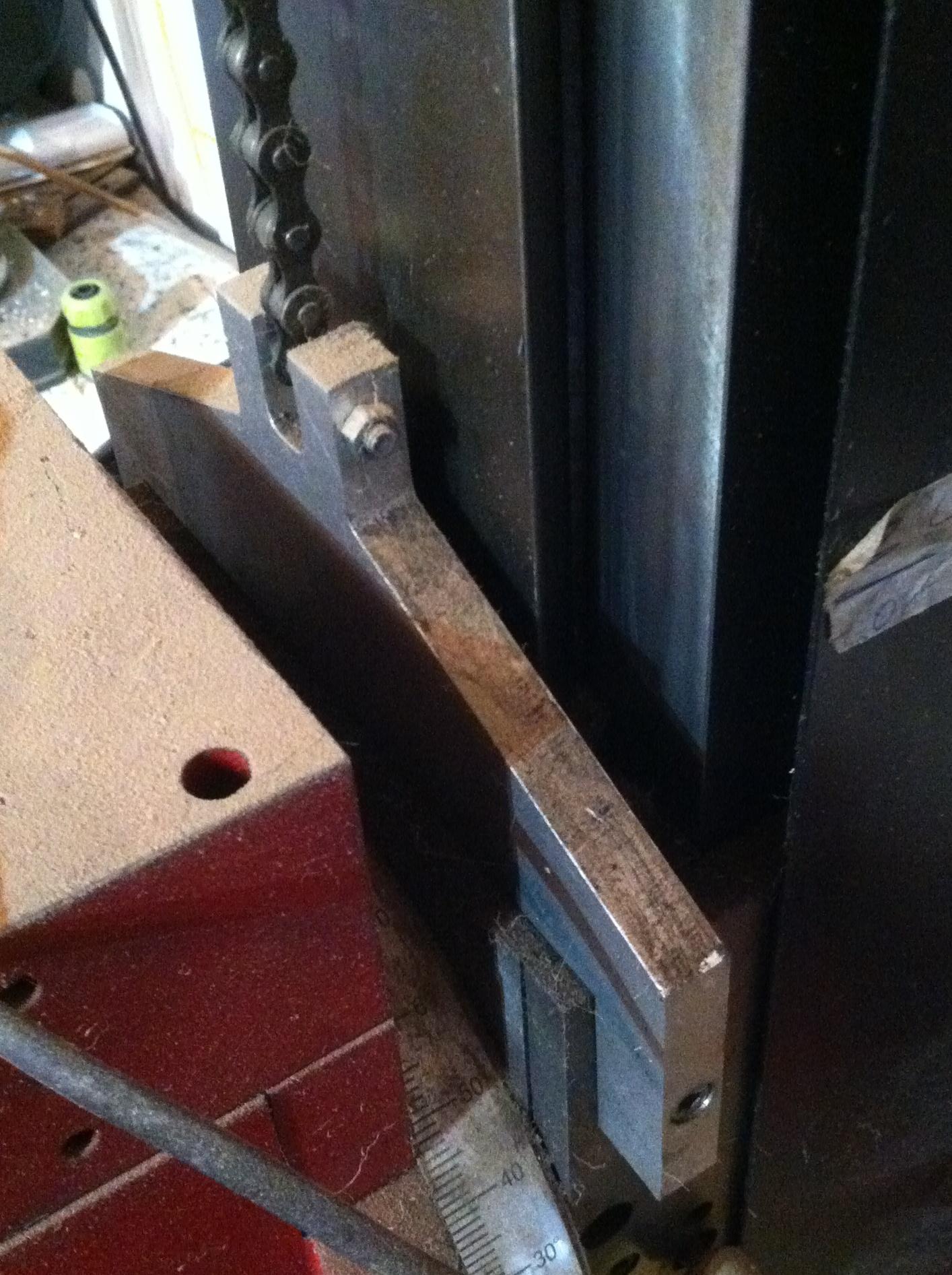

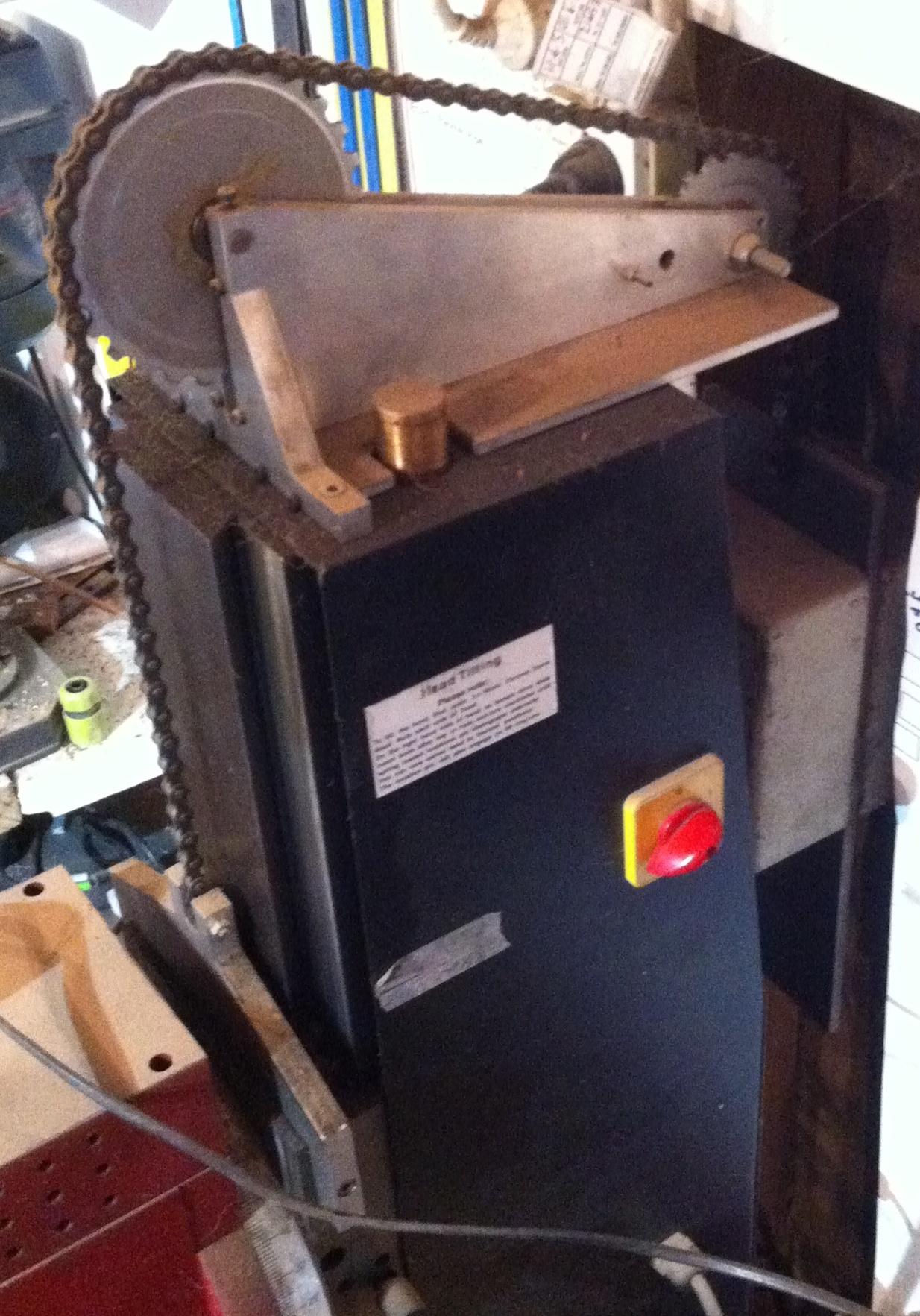

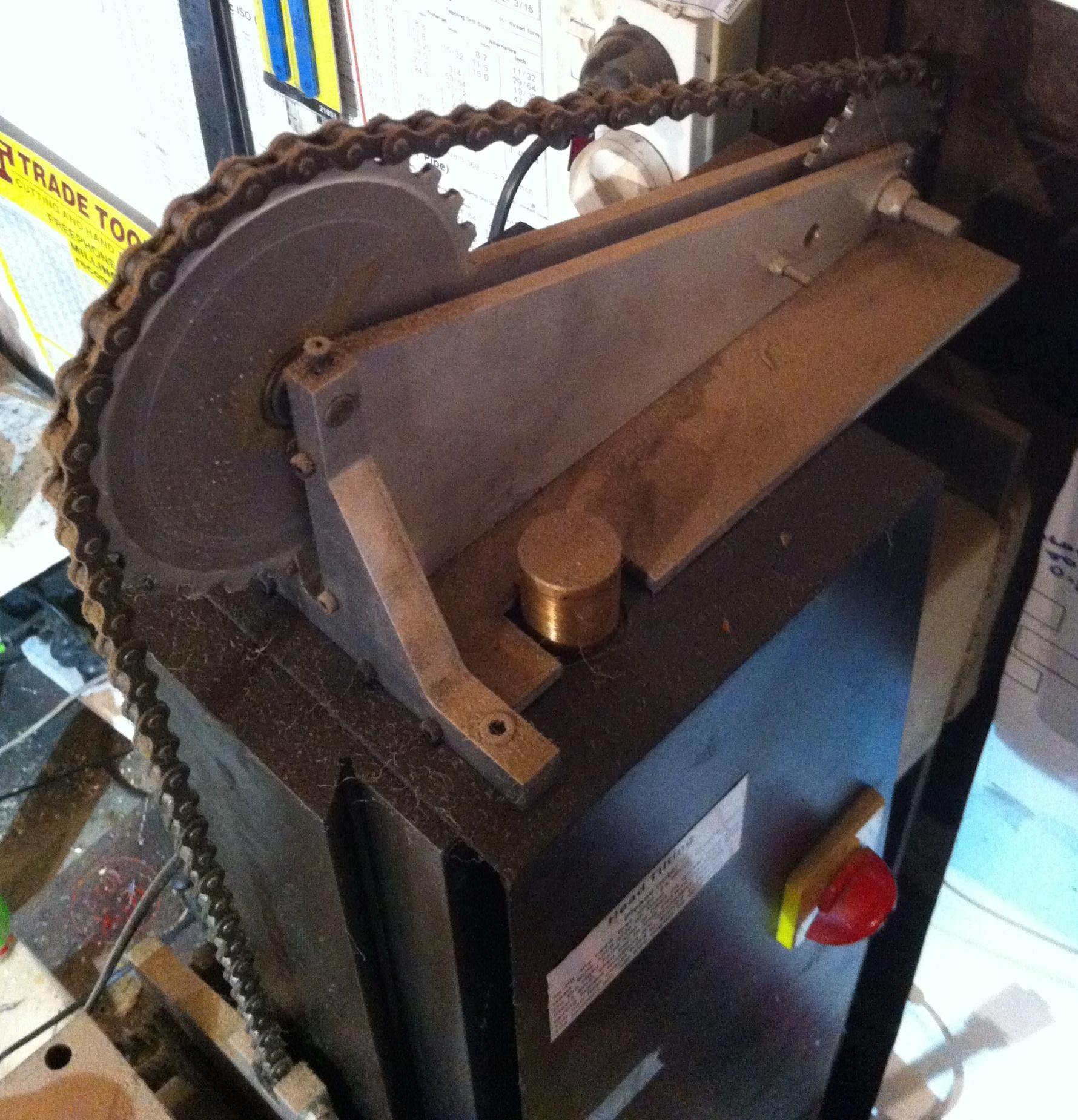

« Reply #26 on: July 24, 2016, 06:50:45 AM »
I did the same with my Z Axis for the same reason. I rigged up a Sprocket above the Spindle Head and another at the back of the Column. This carries a Bicycle Chain running from the Spindle Head to a 16Kg counterweight at the back.
I'll try to get a Photo tomorrow. Nice & simple, and works perfectly.

Counterweight System for my SX3 CNC Conversion as promised.

Re: The basics
« Reply #36 on: July 27, 2016, 04:18:26 PM »
Why a counterweight ?
Done over fourty X3's and SX3's and none needed counterweights and any that had a gas strut fitted it got removed.
350 oz/in motor at 2:1 reduction on 5mm pitch screws
