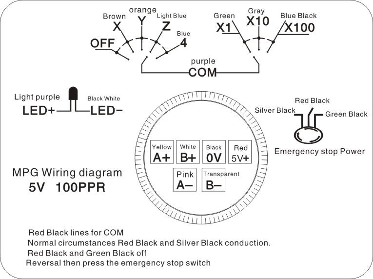

Can I have some more info on the pendant please?
Is it a separate driver controller or does it integrate with the DDCSV1?
Can you post a link to it please?
Still learning and waiting for my controller
Will

Here you go Will
http://www.aliexpress.com/item/CNC-Pulse-Generator-4-Axis-MPG-Pendant-Handwheel-Emergency-Stop-for-Siemens-FAGOR-GSK/2009058806.html
It wires straight into the back of the DDCSV, though I will use a 25w D connector for through the case connection, and transfer to other machines.  The extra pins on the D can also support the tool probe sensor  2.5mm mono audio jack built into the D connector shell.

Thanks Joules, do you have a wiring diagram for this pendant?

 I saw that diagram Joules on the makers thread!
Its just that the colours of the wires bear no relationship to the connections on the DDCSV1?
Or am I just being incredibly stupid?

Yeah, tis a little confusing.  However all the important stuff is there, you don't have a line out for the LED and the emergency stop on the DDCSV only uses two wires not three.   I'll do a wire to pin chart later, probably after I have wired mine up so we know its right, or WRONG.
Also confusing is the E-stop has two options, one for the pendant 5v and an external E-stop 12v  My guess, they won't appreciate being cross wired.

Finally got the pendant working....   If you're at all colour blind this will be a challenge.  I had a really bright light and the colours are still awkward.  Wiring direct into the DDCSV is lets say tricky, it wants to be a socket of some sort and thicker gauge cable off the other side.   The other thing that caught me out was setting the logic levels in the parameters and remember to select MPG using the mode button.  I cracked open the case and tested every wire till I realised I wasn't in MPG mode
 :palm:
Oh well, at least I had continuity and everything was wired correctly, if you are colour blind this is actually the best way to attempt wiring it as the board has some silk screen labels and the encoder connections are as per the diagram.

Will, I just took a look in the manual and saw the wire list you must have looked up.  Ignore that unless you use the pendant they specify, this one isn't the same as that, hence the different wire colours, but they do the same job, main requirement being the pendant has a 5v encoder, NOT 12v.

Here comes the beautiful pendant wiring...   :lol:
http://i7.photobucket.com/albums/y253/joulesbee/CNC%20Misadventures/CNC%20Mill/IMG_0113_zpskqi1yzzz.jpgDesktop Mill CNC Conversion
Colours and connection as below.
GND      =  Black
WHA+   =  Yellow
WHB+   =  White
A-IN      =  Blue
Z-IN      =  Light Blue
Y-IN      =  Orange
X-IN      =  Brown
+5V-W  =  Red
WHA-    =  Pink
WHB-    =  Transparent
GND      =  Purple and Green Black
X100     =  Blue Black
X10       =  Grey
x1         =  Green
ESTOP   =  Red Black
You end up with 3 wires left over, this means the GND could be common'd up and reduce the pin count to 14 so a 15way D could be used, but the connector shell would be very tight so think the 25way is still the one to use.  The above ONLY applies to the pendant linked to earlier in the thread, the wiring is not universal so check before you follow the above guide.
http://i7.photobucket.com/albums/y253/joulesbee/CNC%20Misadventures/CNC%20Mill/IMG_0114_zpstuclqrl2.jpgDesktop Mill CNC Conversion
These are the MPG (pendant) settings used for this particular pendant.  Note top left of the screen it's displaying MPG (Pendant Mode)
