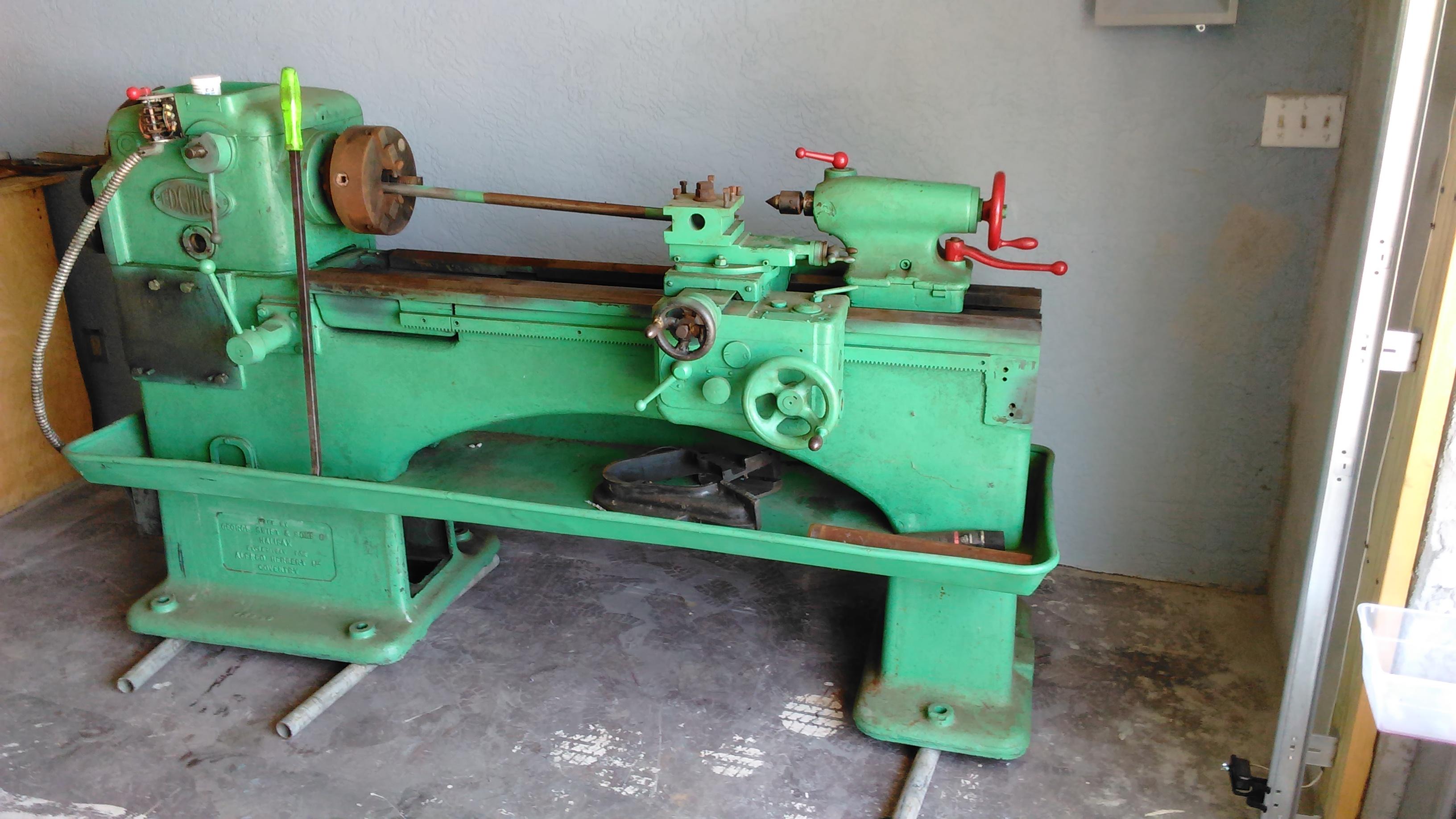

Would anyone happened to have Manual, photos and/or Info of the EDGWICK lathe. I picked one up a few years ago in bad shape at the scrap yard. Been restoring Her the best I can with what little info on line. Someone ran a forklift into her.
