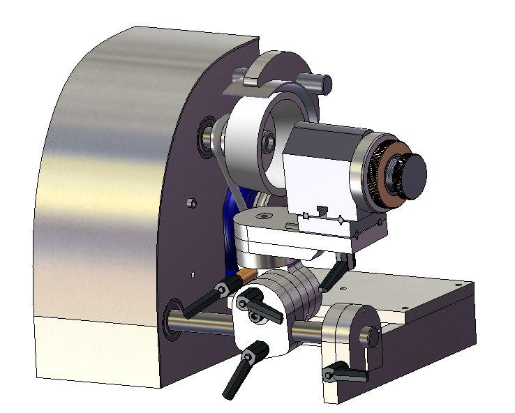

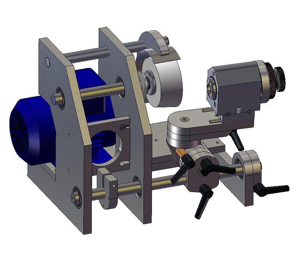

The work's Byjet 3015 water-jet has been busy cutting half metre diameter rings for an oil support company and I , being always aware of such things, have been keeping my eye on the ever growing pile of too-good-to-scrap but to-small-to use of HE30 discs.
So, having watched Dan Gelbart's excellent you tube videos , I been scribbling a T&C design using as much of the IKEA flat pack technology as i can.
Lots of work still to do of course but, I thought you'd be interested (particularly if there was a kit perhaps) :)

That looks very good and functional design.
Those linear stages looks intriguing. How does it holds dow? With T's? Lock?
You are using linear stage to grind instead of swing over the round bar like on quorn.

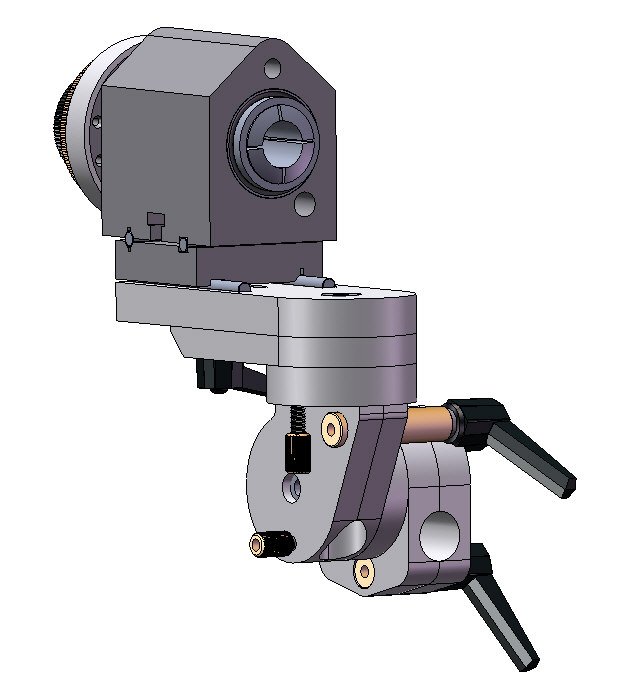

The design is is based on the Deckel S0 single lip t&c. The grinding is mostly done by swinging the head around the bar at the bottom, this moves the tool face on a circular plane flat across the edge of the wheel.
To grind radii the bar can be fixed and the tool swivelled around the top most joint . The little cross slides are for adjusting the radius and offset from centre.
The cross slide design will have to be prototyped , i was trying to minimise precision parts, making the water jet do as much work as possible
The Byjet is an impressive machine (positional accuracy is 0.025mm i believe) and will cut to better than 0.25mm (the previous operator, RW "the fifth beach boy", cut me a stainless steel part with a 5mm curved guideway slot that was better than 100um with an almost ground surface finish on the edges), it will cut up to 100mm steel yet it can engrave a 1.2mm thick aluminium plate.

Just a few points worth considering.
The Quorn has a micrometer feed screw on the bottom rail which is used to put a fine cut on.
One desirable feature is to be able to withdraw the tool being sharpened for close inspection and then being able to put it back without losing position.
Is the rotation of the bottom bar stopped by the clamp between the two main plates? The Quorn uses another round bar to stop against and there is a screw to adjust the stop position.
Grinding wheels on the Quorn are mounted on arbors similar to an 8mm watchmakers collet. They are very easy to swap.
I assume you'll have screw adjustment for the various adjustments on the workhead.

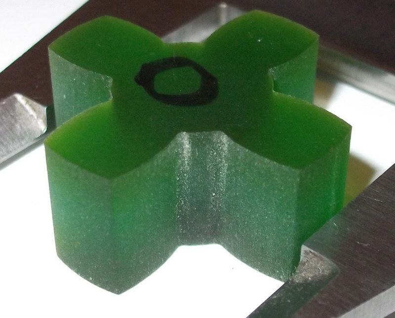

However, I had  to interrupt him long enough today to make some urgent repair parts for the Agie wire eroder. The motor couplings had softened with age and were creating too much backlash  (10um) .
You might be interested in how the WJ cuts something rubbery (this is a neoprene I believe) . The '0' is so I could differentiate it from the ones that i cut 100um bigger (I wanted a snug fit)
The coupling is about 30mm diameter and was cut at 400mm/min - 3600bar
