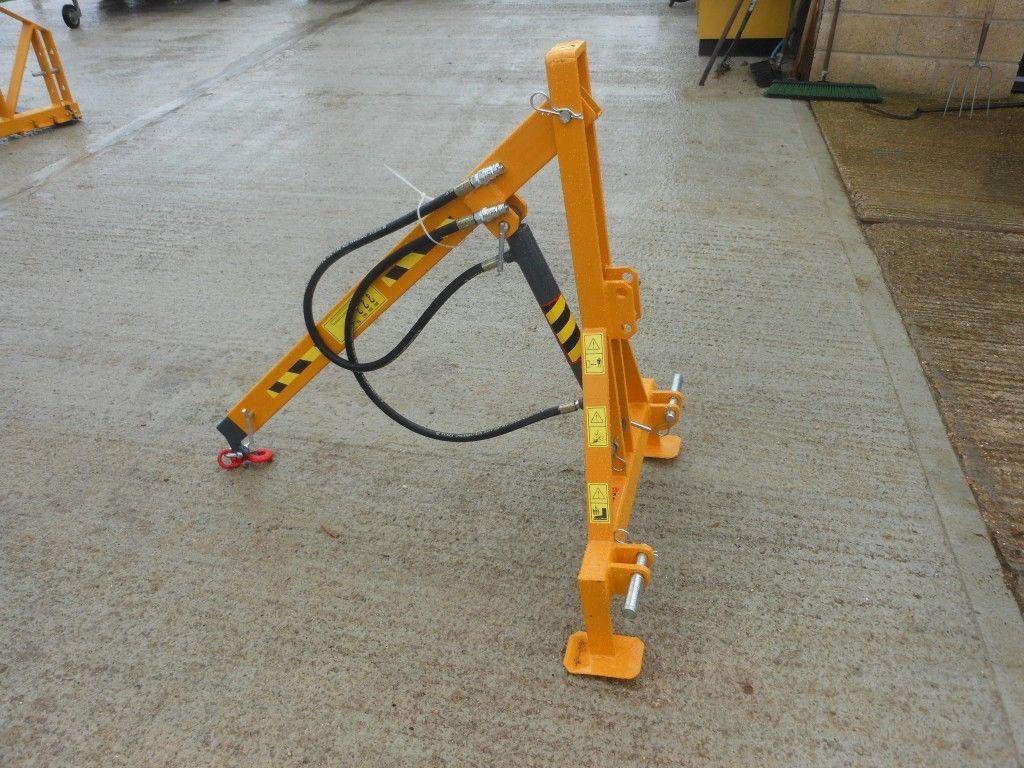

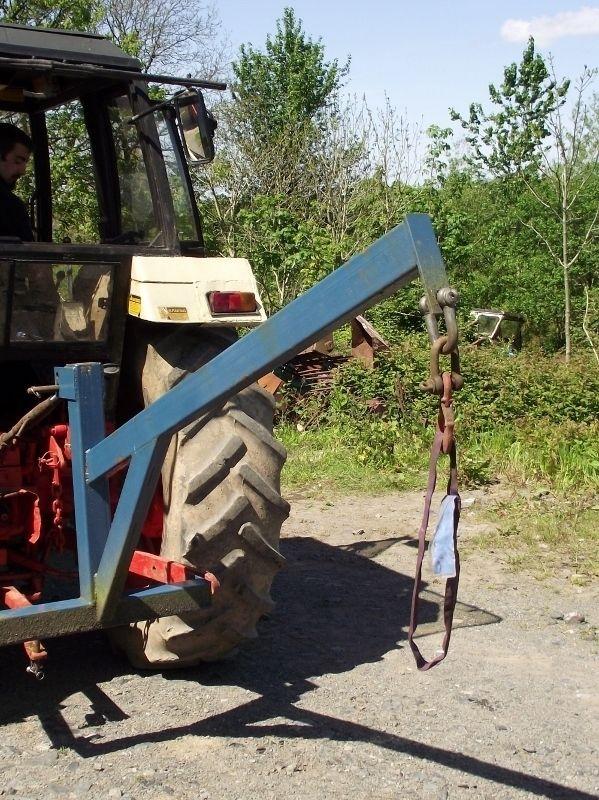

There are two designs that I've seen. The first is a simple gallows shape with the lift entirely provided by lifting the linkage arms. The second is essentially a conventional engine crane mounted on the three point linkage with the hydraulic cylinder operated off a spool valve on the tractor rather than a hand operated pump.

Here are the two designs that I mentioned
