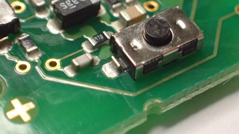

My rusty ford developed an annoying fault: Would lock as normal, but would not lock up ocassionally. Sometimes need one touch, sometimes four, sometimes I had to resort key.
I measured the battery, changed the battery, tried contact spray and canned air. Not much help. Sometimes worked sometimes not.

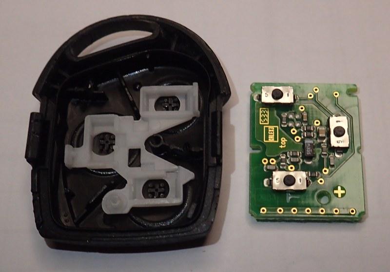

There is a plastic bridge that holds circuitboard down. Used scalpel to cut off the mushroomed heads of board stand-offs.
Micro switch was loose...looked like very little solder on the pad...bit solder and sorted!
Now the question: if the plastic standoffs fails, how to fi it. I had to cut the heads of to gain access to innards. There was left very little plastic to heat/mushroom.

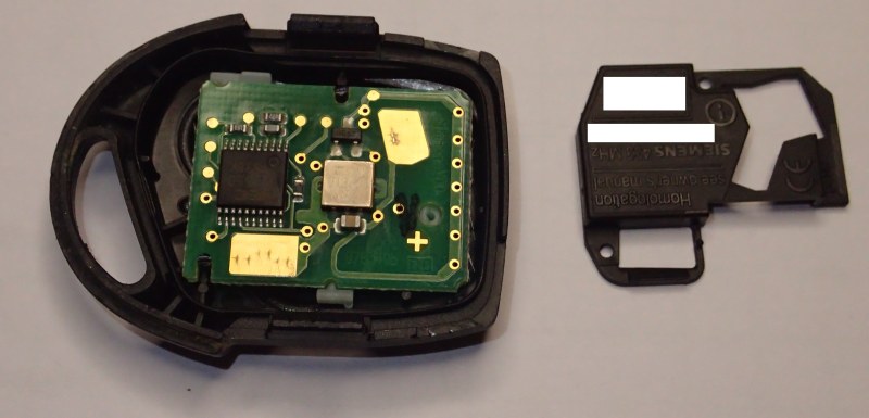

Why did't I think of that. I have plastic "welding" rods for hot air gun. I could shave off a little and try that.
Now it is fine, but since I cut the mushroom that kept circuit board and a plastic carrier in check, there was limited amount of material left and I'd like to have plan B if that fails. The standoffs were pretty small I think the esessive monkey forces must be diverted somewhere else than on those small mushrooms.
The roots of the standoffs were really thin and would not take any even smallest screw or such.
Here are the pictures. I blanked the areas that had codes in them.

I also had problem recently which I thought was one of the switches - turned out that there was iffy contact to the chip on the PCB - a quick re-flow of all the legs of the chip fixed that.
