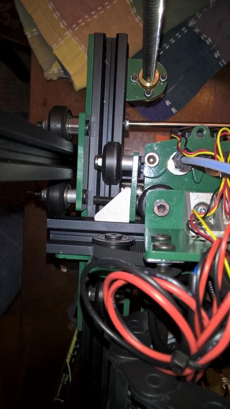

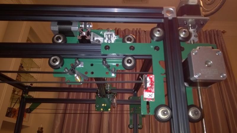

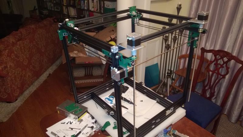

Offline WeldingRod
  • Posts: 401
Re: Sheet Metal Brake and 3d Printer.
« Reply #35 on: September 10, 2018, 02:23:42 PM »
Since this thread is worthless without pictures, I dug some up!
You can see my base using triple wide extrusions in a kind of double-barred H; this lets me bolt through without having stuff intersect.  I use the side pocket for the power supply and brain.
One shot clearly shows the wheel-on-flat system I use on the far end of the Y and Z axis.  The idea is to only constrain one thing: rotation around the other extrusion.  Another shot shows the controlling Z and Y plates; these all run in the V-groove.

I appreciate the pictures. I also appreciate seeing a machine where the gantry moves up and down. It seems to be a rare arrangement for some reason.
I really like the look of the whole drive mechanism. Every time I look at coreXY and similar stuff it just seems overly complicated and prone to more problems than it'd solve (I get the feeling stuff like H bot and CoreXY is just trendy renaming of older plotter ideas). It's also interesting how you've refrained from joining the two vertically moving struts to make a box, but thinking about it - it does make more sense to do it that way and avoid over-constraining.
Is that machine a work in progress still or is it working?

Offline WeldingRod
  • Posts: 401
« Reply #38 on: September 12, 2018, 12:22:05 PM »
There are about a dozen of my bots out working, and mine has been banging out parts for years.  There's even instructions!

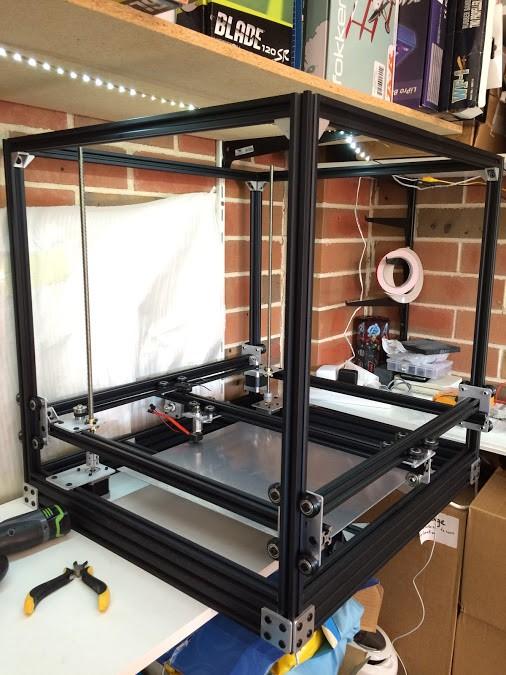

Been putting this off because I just can't settle on a design.
Went back to CoreXY since it fit into what i'd already come up with the easiest. It's a little over-built though using the 40mm extrusions. I can't help but overbuild the wrong parts. It's often said that any idiot can make anything work, but it takes a real engineer to make something that barely works. I might use 30mm extrusions in the end.
I really like the look of your machine WeldingRod, and it's clearly a superior design to what I can come up with. But i'm not sure how you'd enclose it without making its footprint huge. The area I want to fit the machine is about 600x600, and id like the build volume to be at least 350x350x500.
So assuming I continue with this design then... where would be the best place to put the Z axis screws?
In the middle seems most obvious, but I can see it tipping as the gantry moves past the center point. But at the ends seems like there'd be alot of leverage to flex stuff...

Fully enclosed, my printer is 690x690x660 deep for a 380mm build cube.  Yeah, it's pretty big!
Offline WeldingRod
  • Posts: 401
« Reply #47 on: September 14, 2018, 05:52:38 PM »
I would make choices to minimize and balance loads.  Your 3d model with the screws has good locations.
Btw, speaking from having two screws... I highly recommend coupling them with a belt (if posdible), even if you have steppers for each.  When the power is off they can get desynchronized and tilt your z axis.  Also, watch out for backdriving the z when the power is off.  I use multiple constant force springs to counterbalance my z carriage and make it so it doesn't backdrive when it's off.  Belting helps this too, as you have to turn multiple motors to get in trouble vs only one.
