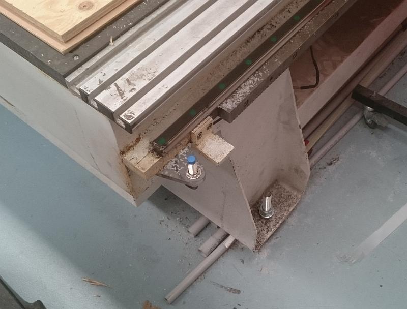

We recently noticed that our router wasn't cutting squares. It looked like the bed got a bit of a warp in it when it was moved to our new facility.
Part of the fix was to add a second home switch to Y (Y was driven by two steppers, two drives, but one set of step and direction signals) and then drive the two motors independently.
Our machine startup routine then homes both sides of the gantry, initially together, then independently.
Assuming your controller supports this, it's a fairly bulletproof way to make sure everything stays square.
 The pic shows one of the homing proxes and the other thing we did which was replace the feet with 25mm all-thread sunk into the slab so we could pull the warp out of the bed..
