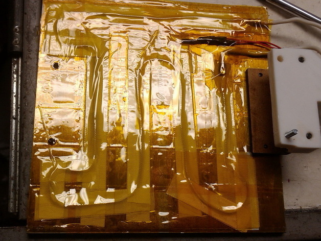

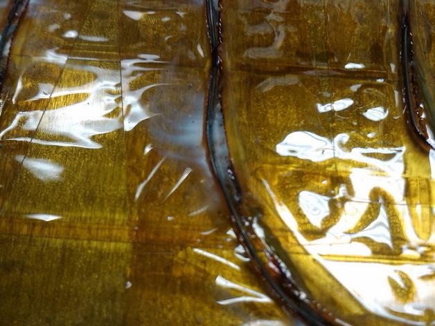

That's an interesting method of making a heater!  Mine runs on mains power too (120 VAC).  I have a dedicated temperature controller (and sensor) that limits the maximum temperature during heat up.  The controller board has its own thermistor screwed into the side of the bed that is able to regulate a bit below the big guy's set point.
My other 3D printer uses nichrome wire taped to the bed with fiberglass and Kapton tape (but running at 12 Volt) (second photo).  To make this sort of thing work, you need to keep the Watts per inch of wire down.  The challenge is that areas of wire that are in good thermal contact with the bed stay near bed temperature, but ones with poor contact get hot.  I had areas that got hot enough to evaporate the Teflon insulation the first time around (first photo)!   :zap: Also, terminating Nichrome wire is a PITA.  Your best bet is to either use really low Watt density and crimp on high temperature rated ends, or solder on ends.  To solder, you must sand the surface of the wire, use acid type plumbing flux and, (ideally) silver bearing solder.  Lead free plumbing solder should be ok.  The reason for the acid flux is that Nichrome has an adherent oxide layer that solder doesn't normally wet.  https://www.thingiverse.com/thing:13939
I used a siliconeheater on mine, and had Keenovo make one the right size:
https://www.ebay.com/itm/35x35cm-110V-Silicone-Heater-Cobblebot-3D-Printer-Heatbed-w-Digital-Control-Plug/281704332422?hash=item4196e2fc86:g:HB8AAOSwc1FXZgm4
You really need to get the plate flat, at least if you want the bottoms of your stuff flat.  If you use mesh bed levelling you can live with merely flat-ish as long as the shape isn't too complex.  The laziest flat surface is glass.  You definitely need a bit of thickness; 1/4" or better should work fine.
I LOVE the PEI coated bed I have; zero hassle factor!  non-zero $$, though.

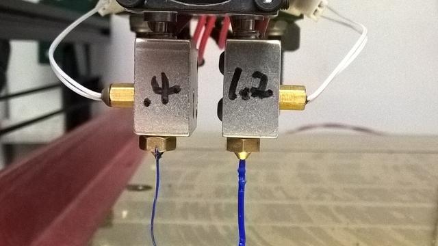

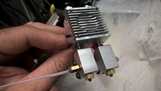

I can't recommend making nozzles, but heat breaks and heat sinks are definitely do-able and may be worth your fun time, especially if you want something a bit special.  I made a special dual-Volcano heat sink to fit my bot.
I should mention that dual nozzle are a PITA on a big printer; the tiny nozzle is always dragging on the big nozzle's work.  I have #2 raised way up to get it out of the way.  At some point I will switch over to a filament changing nozzle (basically a Y junction in the bowden tube).
