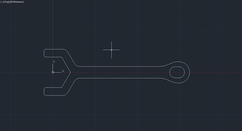

Today using Autocad I added an opening on the end of the previous spanner that I had cut for the Baruffaldi powered tooling to hold the flat on the 90 degree unit.

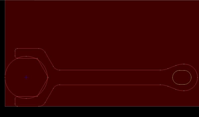

All looks exactly as I want in Autocad, as a .DWG. I then save it as a .DXF and within Autocad it still looks fine. If I then import the .DXF into SheetCAM in preparation for cutting on the plasma table, a mysterious circle appears between the jaws of the original spanner.

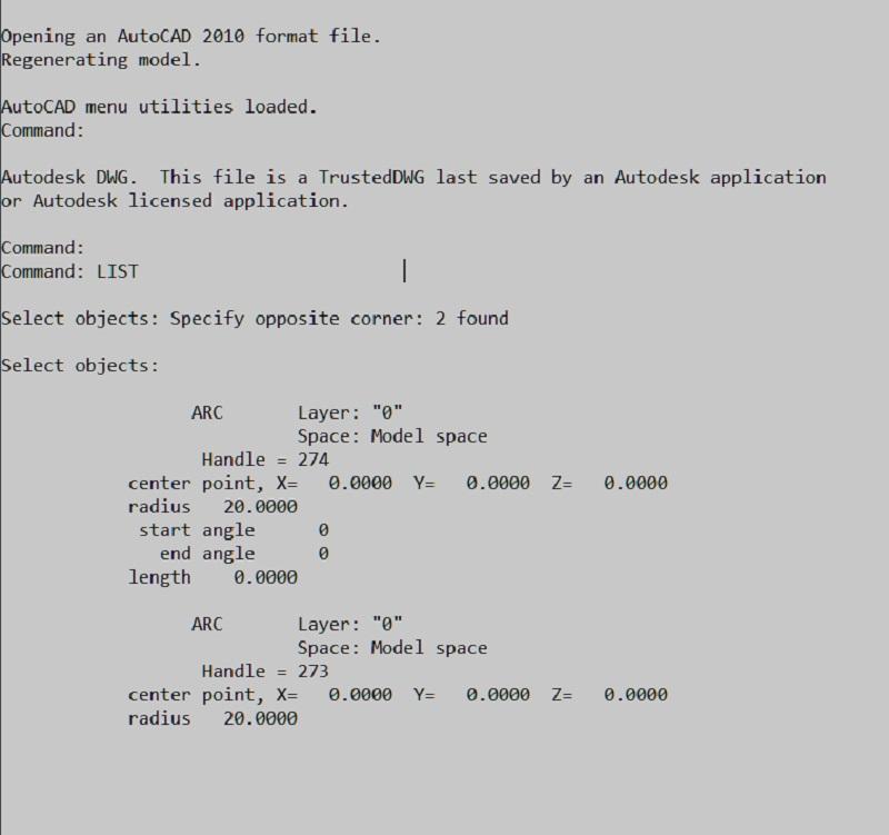

If I go back into Autocad there is no sign of this circle. Only one layer is in use, and if I do a 'LIST' selection of where the circle is, there is no circle listed  :bang:

Andrew,  If I open it in Alibre Design the circle is there.
In eDrawings the circle isn't there.
In EasyCAD the circle isn't there.
In eDrawings and EasyCAD there is a tiny dot which looks as though it coincides with a point on circle diameter in the V of the jaws.
Not sure what that tells us....   your image from ACAD also has the dot when zoomed right in.

When trying to delete the circle, I found there are 2 copies of it.  They will delete.

By zooming in on that point you spotted (well done eagle eyes!) I found the two circles and could delete them and now all is well in Sheetcam - very odd though that they don't display in AutoCAD
Spanner now made  :thumbup:
Here are the properties in AutoCAD :

Yep radius of the circles is 20mm.
My guess is that AutoCAD and other software treat start/end angle differently.
Both being zero probably gets interpreted as 'don't draw any of the arc' by AutoCAD, but as 'draw full circle' by others (on grounds that 0 = 360 ).   The centre of the circles is at 0,0.
