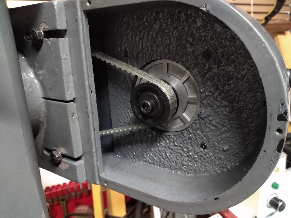

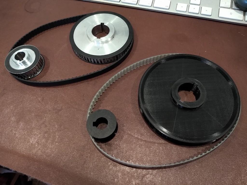

Some may remember my attempts at getting this machine CNC ready.   Well, that got shoved on the wish list.   So for now I am setting the little mill up permanently for horizontal use as circumstances changed in the workshop and I got a vertical mill.   One issue with the SU1 for horizontal work is the powered spindle that can be swapped between vertical and horizontal.  It's speed range is 200-2500rpm, thats not really very useful.  Too slow for small cutters vertically and too fast for horizontal cutters, you can slow the spindle down further but it starts to get a bit unstable and cog below 150rpm.
I figured I would print some new pulleys and see how it goes.   My assumption was the belt included would be a T5 or XL style belt, sadly it isn't and doesn't seem to be any sort of standard.  Rather than waste more time and prints I converted it to T5 belting.  No big deal as I know the spindle and motor are 130mm between centres so easy to calculate the required belt and get one ordered.
I could have bought the small pulley off the shelf, but heck, if you do 3D printing....    :D

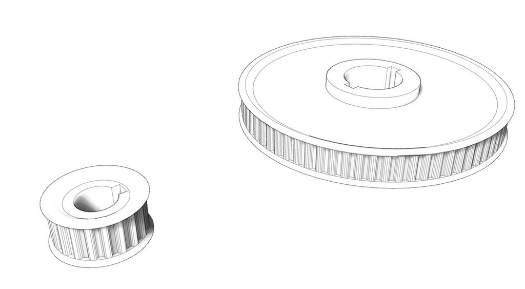

I set too designing new pulleys, 18 and 72 tooth.  Whilst the 18 is cheap to buy, a 72 is not, another bonus of printing your own pulley is you're not stuck with standard sizes.  I printed both pulleys.  Picture below compares the original set with the new.   The printer did a good job of accurately printing these, I used the 0.3mm nozzle so they are a longer time printing but with good detail.   I cocked up a bit printing the large pulley, as that print took 11hrs, if I had made it a spoked pulley it would have printed faster, but even an 11hr print is quicker than waiting for a replacement from a 3rd party.

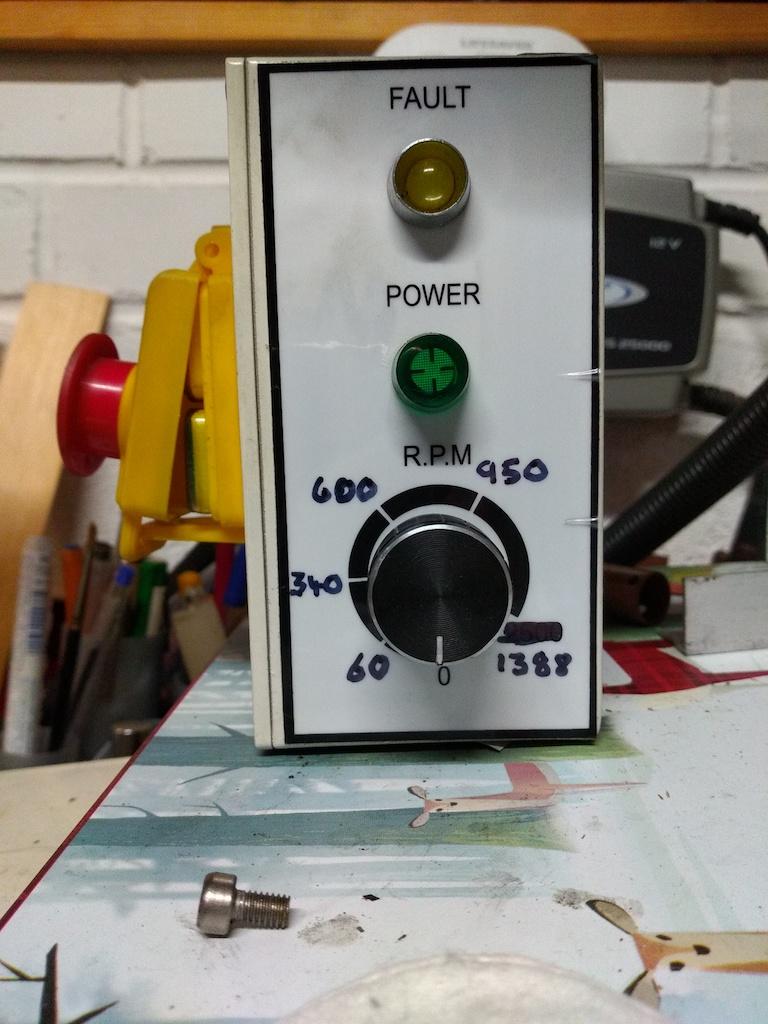

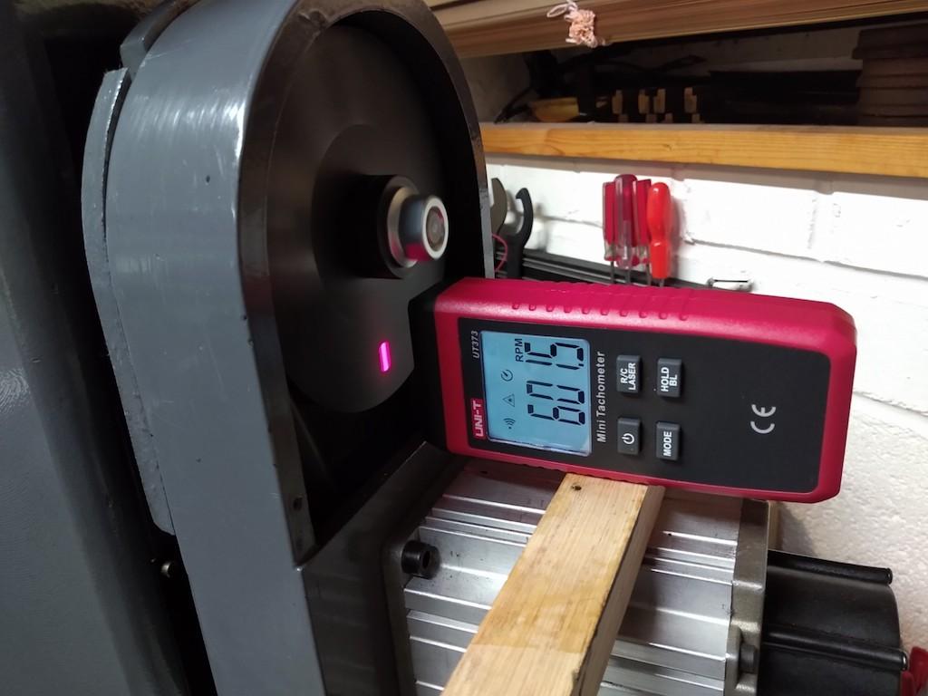

Both pulleys installed easily and aligned using a straight edge.  I recently got a UNI-T Mini Tachometer from Banggood for very little money.  Useful bit of kit and it can also be used as a counter, handy for winding coils.    It verified the new speed range from around 60-1388rpm, an ideal speed range for the cutters I intend to use.  A couple of arbours have been machined for other cutter sets, but I got a reasonable set of Mod 0.5 cutters from Banggood that have 16mm bores, same as the SU1 horizontal spindle.

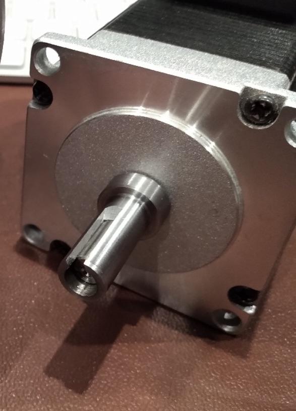

The pulleys and belt are holding up just fine, and here's an example of some serious work.  A stepper motor adaptor to take a key.  The keyway was cut with a 3" x 0.125" slitting saw, no chatter or belt slip.   The stepper will be part of a CNC indexer for gear cutting on the SU1.

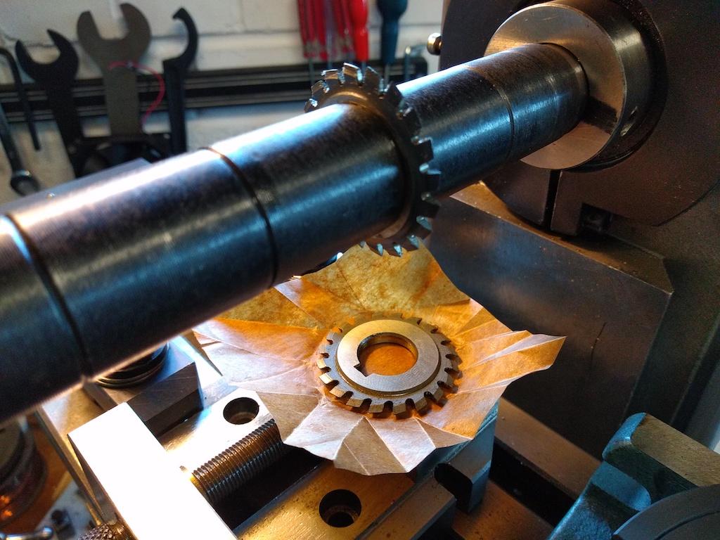

I was wondering about the relevance of the gear cutters in the first post. :scratch:
  • Posts: 1321
Re: Sieg's SU1 Horizontal Mill Setup
« Reply #3 on: March 11, 2019, 08:41:59 AM »
Thats OK Russell, not my best descriptive post.  It would probably have been better posting a picture of the slitting saw in place.  I pretty much use this calculation to determine my blade speeds.
SFM (80) x 4 / diameter of cutter = RPM
My 3" saws should be run around 110rpm, I pretty much use that as a guide for the smaller gear cutters too, so they are around 210rpm.  The new pulley ratio helps a lot with the increase torque at low speeds.
