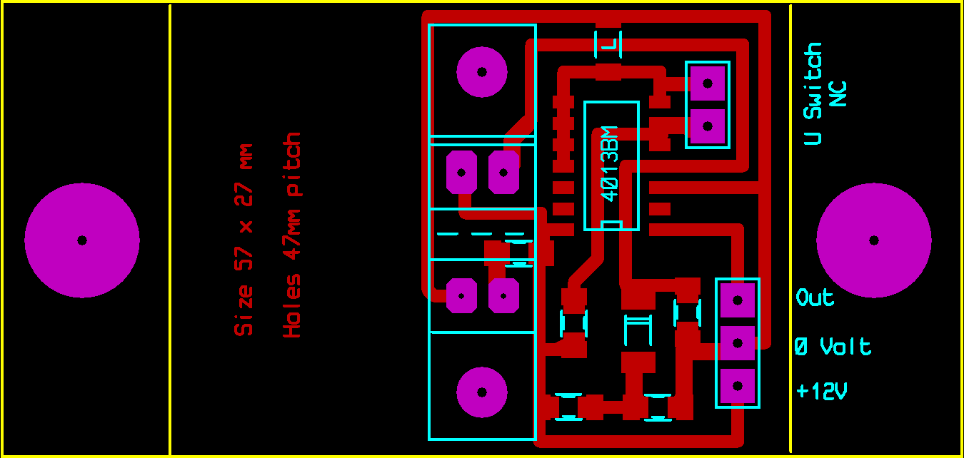

This is idea I read about some time ago and am now implementing on a mill. The limit microswitches are reliable but not so good accuracy wise. This method works by latching the microswitch high when it is opened, but pulling the output low by means of an optosensed disc attached to the ballscrew. So the sequence of home events is the ballscrew rotates until the home microswitch opens. The controller then reverses the screw to sense and set the home position when it closes. However a small opto circuit makes the closing event only occur when a slotted disc aligns with the opto interrupter. Using a 36mm disc  and a 5mm pitch ballscrew I have calculated that the accuracy to be .0025mm or a tenth of a thou. The slot in the disc has to be radial but can be of a reasonable size, say 10 degrees of arc as the position is sensed by the edge.
I have designed a circuit to do this and am currently waiting for parts from overseas to build and test. The pcb is made to work with my DDCSV.
Best Regards
picclock

I considered implementing it on my original CNC lathe for the X axis, but the opto slot sensor I used never showed any noticeable variance on a 0.01mm division DTI, so I never bothered, and I never had any tolerance issues.
Does it really make that much difference that you can home to a tenth accuracy, when your stepper is only likely to be accurate to within a half step depending on load/stiction?

Have you also mapped the ball screw lead error? Having a home position repeatable to a tenth will not add much to the complete system accuracy if the home position is a foot or more from the commonly used area of the table.
If you start needing that sort micron level accuracy, you would be better off closing the position loop with a glass scale encoder. The Heidenhain LS-403's on my MAHO were delivered with test reports for each scale, mapping the error every 10mm (it never exceeds a µm). They also have home indices at micron accurracy.  You could program this error compensation table into LinuxCNC.

The absolute accuracy is not the reason here, its the repeatability of getting back to the exact same position  - within a tenth or so :-).
I am going to fit the disc on the end of the 'plum' type coupler and the pcb will go underneath.
