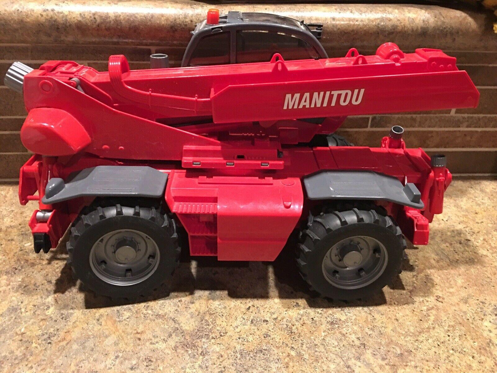

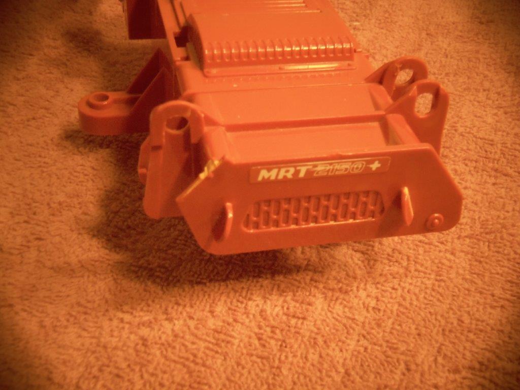

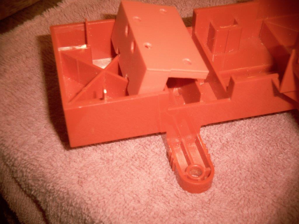

This is going to be a slow build.  I've got a boat-load of other projects going on, along with that 4 letter work that starts with "W" and sounds like werk.

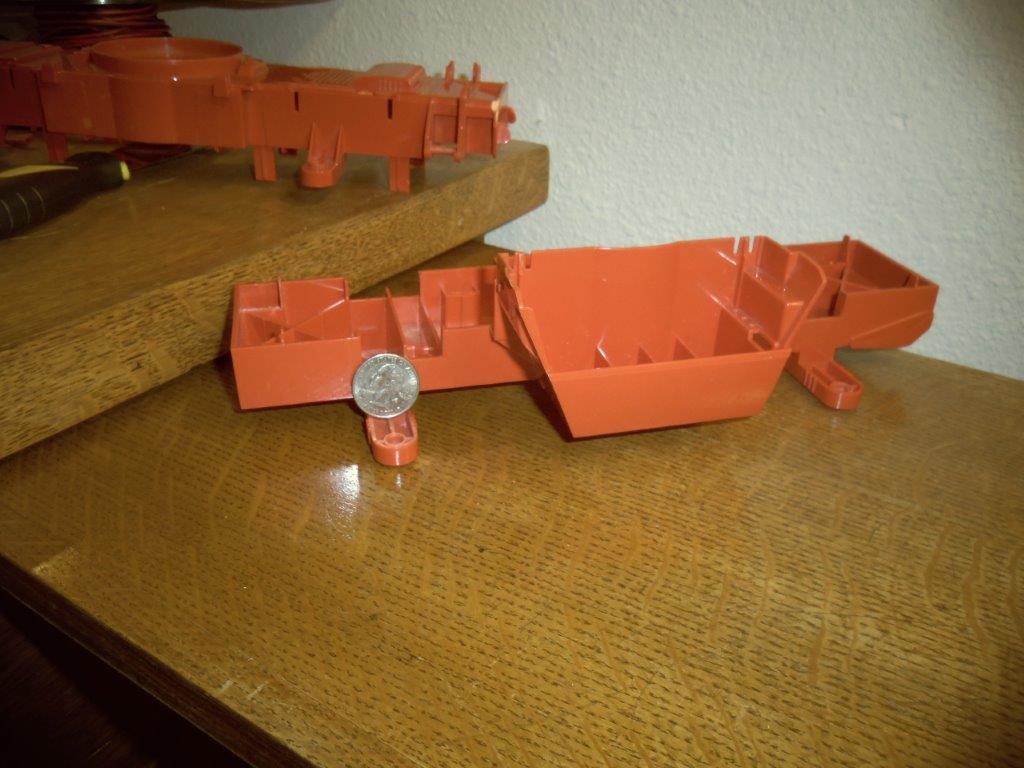

I got the starting point of this project in the mail a couple of weeks ago, see first attachment.  I got it used off Ebay.  It's missing a few parts, but most of those parts would have been heavily modified anyway.  At $11 plus shipping I couldn't resist it.  The missing hood and door are available from Bruder as spare parts. as is the missing extendable part of the boom.  I'll probably order the door and hood, the rest of the missing parts I may try to 3D print.
I've been working on the 3D model of this thing, I'm nowhere as good as Joules, and not nearly as fast, but it's good enough to print the parts I'll need - see second attachment for 3D PDF.  I'm using Adobe Acrobat Reader DC version 2019.021.20056 to view this and it seems to work just fine for the 3D PDF.  I'm able  to manipulate the model and turn various parts on and off in the model tree.  I can see I'll need to change how I've got the components grouped together to make it a little more user-friendly in the PDF version.
I'm planning on working on the running gear first and get that operational.  The current plan is the print 3D replacement parts that are as close to the Bruder originals as possible.  I'll print the front and rear axles, the rear axle will be fixed to the lower half of the body and the front axle will pivot up and down to follow the ground contour, I think that's the way the real thing works too.  I'll keep the 4 wheel drive and 4 wheel steering as on the original.  I'm planning on using four N20 gearboxes at 100 RPM, one for each wheel.  That will give me a scaled top speed of about 16MPH, the real thing has a top speed of about 22 MPH so I'm close-ish.  The current plan is to 3D print inner rims that will allow me to adapt the N20 gearboxes to the Bruder wheels.  These motors only pull a couple hundred milli-amps at stall, so I should be able to run all 4 motors with one 10 amp brushed ESC, at least that's the plan.
One of the big problems with Bruder conversions is that they are too light in weight, being made of plastic and mostly air. I plan on adding weight to this model wherever I can, starting with the wheels.  I'm going to fill the empty space in the Bruder wheels with BB's and silicon.  I should get some added weight, and wheels that won't collapse under load.
If the "plan" turns to crap, well then I won't feel too guilty about it since I won't be out that much.  Mostly just my time, and I work cheap - when it's for myself.
« Last Edit: November 14, 2019, 02:57:42 PM by ddmckee54 »

The Bruder line of "toys" were designed to be "sort of" detailed kids toys, in 1/16 scale.  They make reasonably well detailed models and are not too fragile.  The not TOO fragile part is a necessity to be kid-safe, they are also not too expensive.  I want to build a construction fleet, but I don't want to spend mega-bucks doing it.  I've got 7 vehicles in my fleet to be converted so far, and I'm still looking for more.  I don't think I've spent more than $250 so far.
Regarding the steel donuts in the wheels, I don't have anything that size, the tires have an outer diameter of about 84mm, or about 3.3", depending on which side of the pond you are on.  I do have a 3D printer and plenty of BB's.  Silicon caulk of various colors is fairly cheap.
There won't be much traditional machining in this build, mostly it will be amputating various bits of the original model and 3D printing replacement parts.

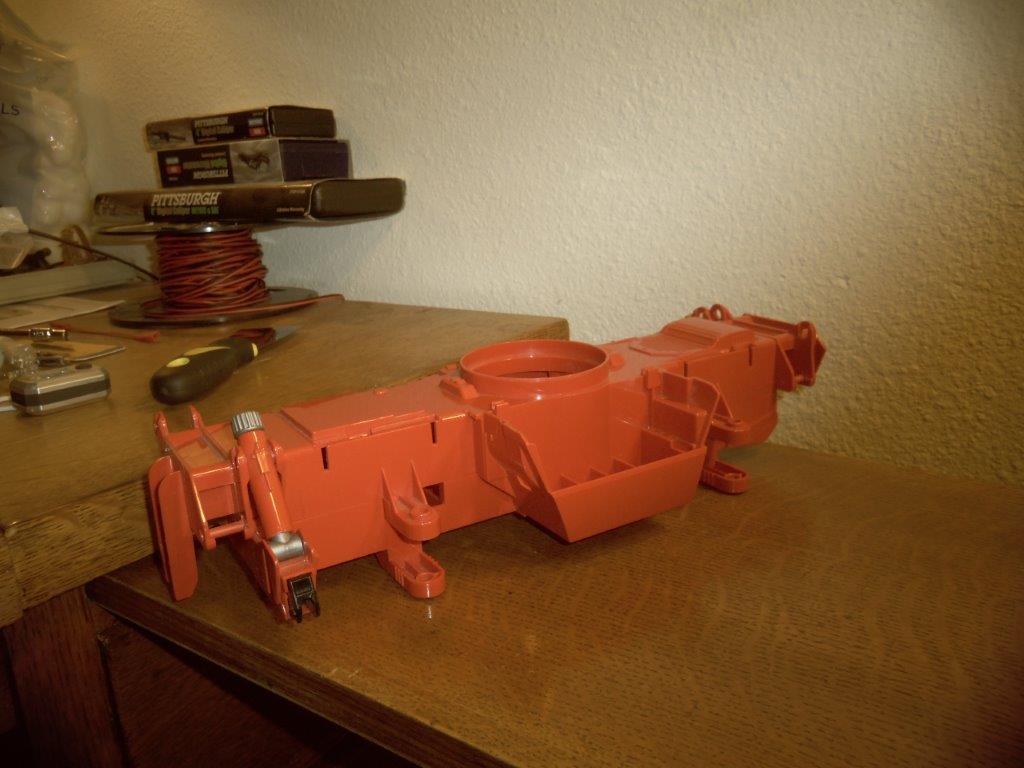

Right now I'm tearing down the original model and making the 3D model.  An accurate 3D model will help me determine what will fit where.  It also will tell me what, if anything, needs to be removed in order for it to fit.  It also lets me design the replacement 3D printed parts at the same time.
I made some more progress on the 3D model last night, see attachment.  I did some work on the upper body and on the fenders.  I still need to split the Body components into the Upper Body and the Lower Body.  That way you'll be able to turn then off to see the inside of the model, along with the various Bits and Bob as they are added.
I got ahead of myself on the fenders, the front and rear fenders are almost the same.  I copied and pasted them into place before I should have.  As I was quitting last night I realized that I hadn't completed the design of the lower part of the fender before I duplicated them.  Now I've basically got 4 times the work to do to correct  that issue.

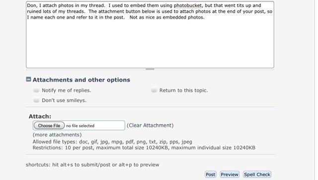

  • Posts: 1276
Re: Bruder Manitou 2150 - RC conversion
« Reply #15 on: November 21, 2019, 04:34:16 PM »
Don, I attach photos in my post.  I used to embed them using photobucket, but that went tits up and ruined lots of my threads.  The attachment button below is used to attach upto 10 photos at the end of your post, so I name each one and refer to it in the post.   Not as nice as embedded photos, but safer to have them here on forum storage.
Hope that helps, posting 800x600 jpeg seems to be a good size these days.

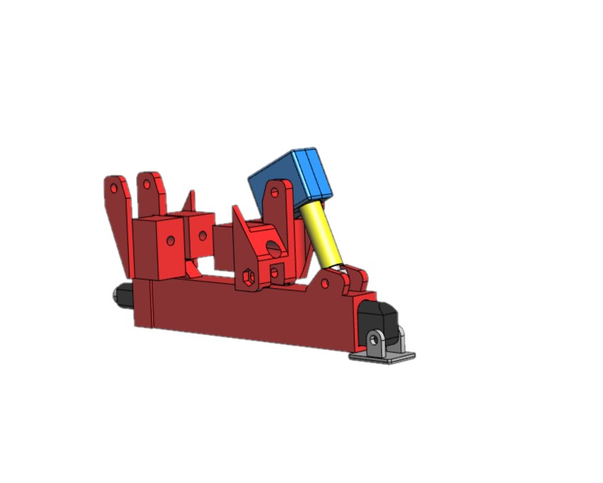

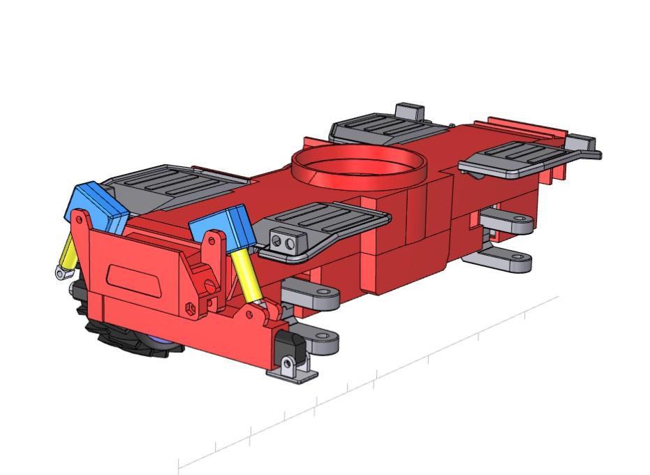

The first attachment will be the overall view of the 3D model.  In this view I've changed the model's rendering to 3D Outline.  I think it makes it a little easier to see the individual parts of the model like this.
The second attachment shows the outriggers and the various Bits and Bob associated with them, also rendered in the 3D Outline format.  Most of what you're looking at in the 2nd attachment will be 3D printed.  The outrigger housing, re red part at the bottom is roughly 15mm wide by 20mm tall and about 120mm long.  The extendable outrigger, the black part on the right, is about 135mm long overall and will extend about 110mm.  The outrigger will pivot from the red block on the left.
The blue rectangle at the top is the cover for the N20 Type 7 gearmotor that will turn the screw to lower and raise the outrigger.  I've printed test examples of the covers, found Boo-Boos, and hopefully fixed same.  The entire gearmotor, with covers, will fit in a space that's 12x25x25mm.    Other people have used these gearmotors in linear actuators that seem to be handling higher loads, so I'm hoping that these will work out.  The hole that runs through the gearbox covers is for the M3 bolt that will be the pivot for the ram.  I'm a little concerned with these covers only being 1mm thick. but that's all the room I had.  Time will tell if these covers will handle the loads.  I'm not going to be lifting tons, just ounces, so I THINK I'll be OK.
The yellow part below the gearmotor is the "cylinder" of the ram.  This will be a piece of 5/16" brass tubing that will be fastened to the gearmotor's output shaft by a set screw, a grub screw if you're from the other side of the pond.  The other end of the cylinder will be threaded M3 to fit the threaded rod that will be the "piston" of this ram - the piston will be fixed.  I know, I know, the cylinder is spinning and the piston is fixed - so sue me.  I'm pretty sure that the crankshaft for the LeRhone rotary was fixed to the firewall and it worked fairly well.  I'm not the first one to get things backwards.  Back on subject, the Bruder outrigger rams move about 20mm, I've got about 25mm of travel in what I've designed.

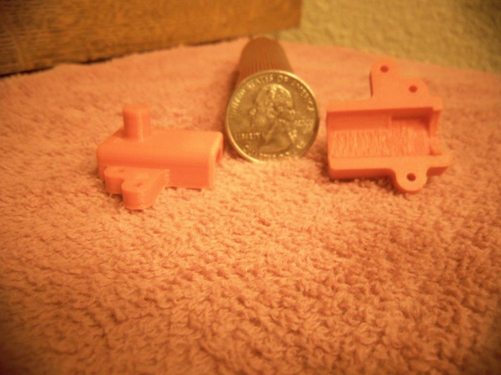

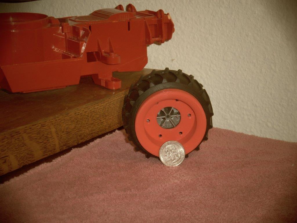

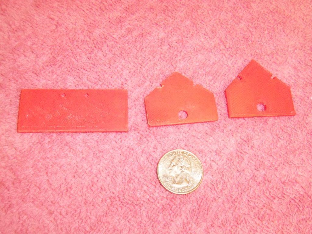

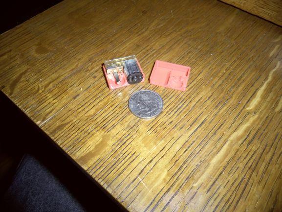

I know that I said today would be the axles...  Well I lied may have stretched the truth a little.  I WAS going to print out the updated axle last night, but by the time I got all the modifications to the gearmotor covers done it was late enough that I'd have had to leave the printer on all night.  It would only need to run an hour or so after I went to bed, wasn't worth it.

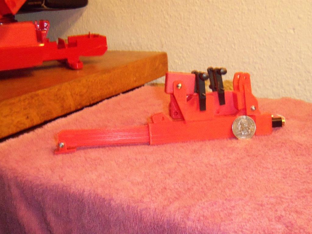

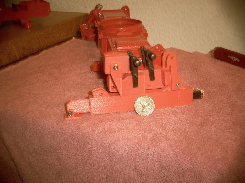

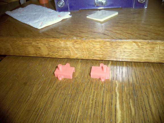

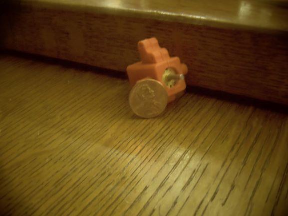

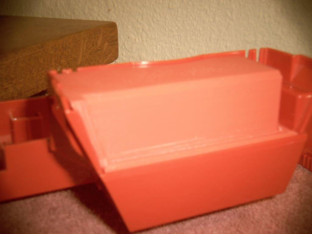

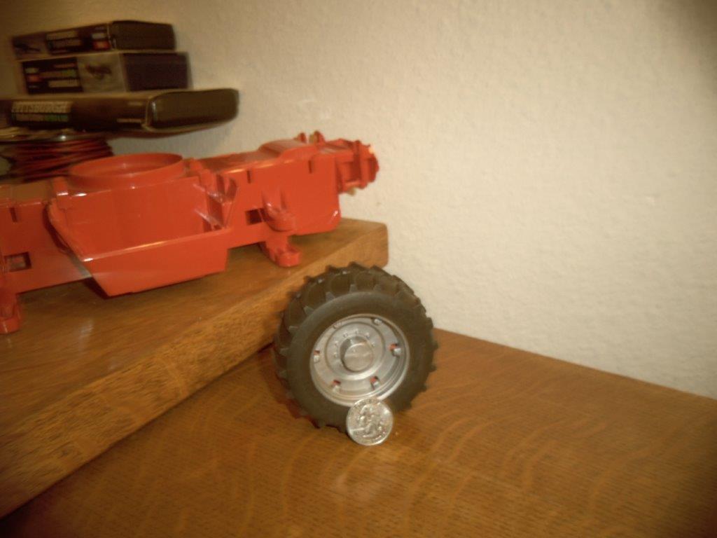

I did get a little accomplished, and I can prove it.  I've got pictures so it DID happen.  I'm attaching several pictures:

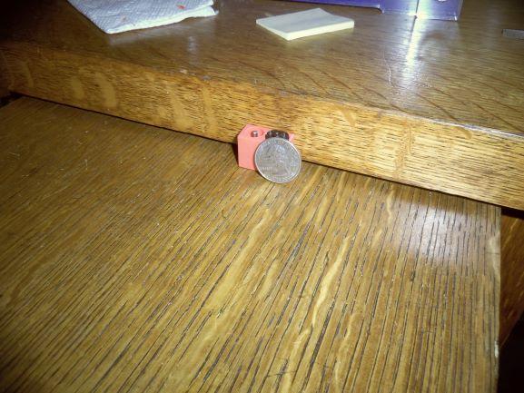

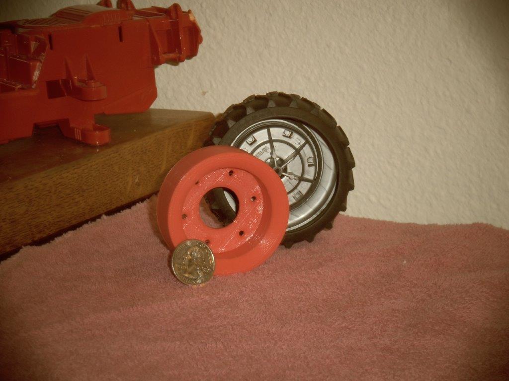

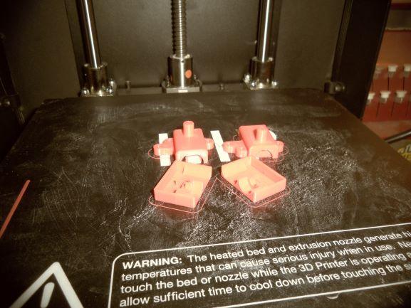

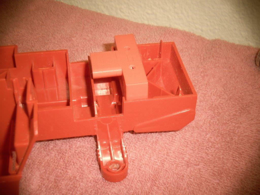

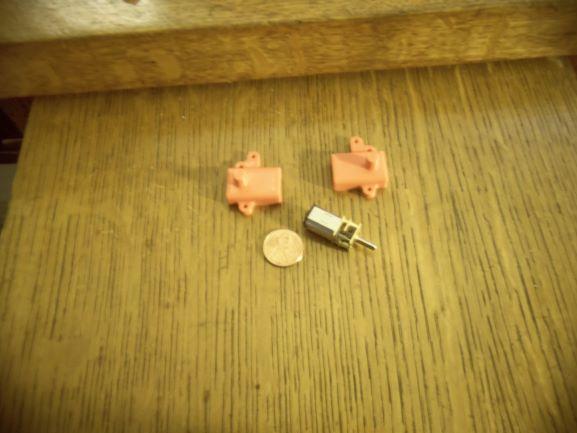

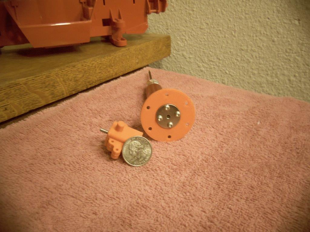

1) The first attachment is all 4 gearmotor covers on the printer when it got done printing.
2) The second attachment is the gearmotor covers for what will be one of the 4 wheelmotors.
3) The third attachment is all the parts for the wheelmotor, along with a penny for a size reference.
4) The fourth attachment is the wheelmotor hiding behind a penny.
5) The fifth attachment shows how the Type 7 gearmotor fits in the cover, along with a quarter for a size reference.  It almost fit like a glove.  I've got to figure out why the pivot hole in one half of the cover fit properly while the other side was too tight.  I know that the picture is badly washed out - sue me, I'm an engineer not a photographer.
6) The last attachment shows the ram motor trying to hide behind that same quarter, and almost succeeding.
I modified the covers for both the wheel gearmotor, and the ram gearmotor.  I was concerned about how thin the covers were. in some areas the covers are only 1mm thick.  I had plenty of room around the gearmotor for the wheel, so I increased the sidewall thickness to 1.5mm and I increased the top and bottom thickness to 2mm.  The top and bottom is where to joint with the king-pin is located.  I also radiused that joint, don't want any stress-risers at that corner now do we?
The Type 7 covers are also only 1mm thick, over the motor and in other parts of the gearbox, but I absolutely cannot increase this.  The motor is 10mm across the flats.  I allowed 0.25mm clearance on both sides of the motor - because FDM printers can get a little sloppy.  When you add 1mm on each side of the motor to that 10.5mm total, you're at 12.5mm.  I've got 13mm of space that I can fit this assembly into - JUST fit it into.  From the fifth attachment you can see that I've got NO room inside the cover to add any material.  I know if I got an SLA printer that I could get away with tighter tolerances, but that is another can of worms that I am NOT going to kick over at this time.  Worst case, I just print out replacement covers if/when they break.

I made some progress over the weekend, this was the first Thanksgiving in several years that I wasn't involved in a shutdown project or two at work.  Anyway, between laundry, cleaning and the other day to day necessities at home, I got a fair amount of prototyping accomplished.  I now have usable 3D models for most of the printed replacement parts that I need to make to convert the lower non-rotating part of the Bruder Manitou 2150 frame to radio control.  I didn't take any pictures yet, these are prototype parts to test for fit and interference, and in most they will not be used on the actual model.  I printed most of these parts using left over partial rolls of PLA from other projects.  I will reprint the correct amount of these parts in the appropriate color for use on the model.  I was going to include a list of the parts I had test printed, but since I don't have pictures that would be  worthless.  I think I'll take some pictures tonight to go with the list tomorrow.
I did model the front and rear steering servos and an 8 channel receiver.  The receiver sits under the engine cover.  At first I will be using a 6 channel receiver which will probably allow me to use the original Bruder "engine cover".  I do also have an 8 channel receiver which will not fit under the Bruder engine.  It's too wide  to fit in the engine compartment when laying on its' back, and when turned on its' side, it's too tall to fit under the original cover.  I have designed and test fitted a replacement cover that will work, but is very ugly - good thing the engine hood will hide it.
The next step is designing the switching assemblies that will allow me to control 10 functions with 4 channels. One of these switch assemblies will allow me independent control of these functions:

OK, I took a BUNCH of crappy pictures, threw the worst away and still have 15-20-ish.  Since I can only attach a limited number to each post, I'll break this up into 3 posts.
This post will cover the main frame of the beast and a little more.  The first attachment, Manitou 2150 001, shows the main frame of the model, this is split into the upper and lower frame.  The upper frame is about 30mm deep and the lower frame is about 24mm deep.  The second attachment shows the lower part of the frame.  You are looking at the engine side of the frame, and this would be on the operators right side when the cab is facing the front of the machine.  This is about 330mm long, about 55-60mm-ish wide, and 24mm deep.  The top part of the frame, because of the overhangs that support  the outriggers, is about 50-60mm longer than the lower frame.  That's a quarter for size reference.
The third attachment shows the front of the Bruder wheel.  It's a fairly well detailed wheel, on this side.  The next attachment, Manitou 2150 005 shows the back side of the wheel, my 3D printed "Inner Rim", and a quarter for size reference.  As you can see the detail on the back side of the wheel is not QUITE as good as the front.  You can also see that the wheels are hollow.  Bruder RC conversions are notorious for being "light-weight's", that's why I intend to fill the empty space between my printed inner rim and the shell of the tire with BB's and silicon seal.  That should add a significant amount of weight, and put the weight where the model doesn't actually have to carry it. The next attachment shows the assembled Bruder wheel and printed inner rim.  It's standing proud of the tire because the 6 ribs in the center of the wheel still need to be removed.  The quarter is still there for size reference.
The next attachment, Manitou 2150 008, is the two parts of the gearmotor cover that turn this into a wheelmotor.  You can see the kingpin sticking up from the part on the left, the part on the right shows the cavity printed for the gearmotor.  The gearmotor is a 6 volt 100 Rpm gearmotor which will give me a scale speed of about 16 mph.  You can also see the holes for the 2mm bolts that will hold these parts together.  The two nearest the center will hold the covers together, while the other will be the attachment point for the tie-rod.  The next attachment shows the assembled wheelmotor and the hub that will adapt it to the wheel.  The last attachment shows the wheelmotor and the assembled axle.  Both the front and rear axles will be identical.  The front axle will pivot while the rear axle will be bolted solidly to the frame.
That's enough for this post,
« Last Edit: December 03, 2019, 03:18:35 PM by ddmckee54 »

This post is the second in a series to three that show the modifications required for my RC conversion of the Bruder Manitou 2150 Rotating Telehandler.  This post will cover the modifications required to add my 3D printed axles to the original model.
The first attachment, Manitou 2150 014, shows the front of the lower frame.  You can tell it's the front because of the chamfer seen in the lower right of the frame, the rear does not have this chamfer.  This picture shows the front portion of the lower frame, you can see the molded in portion of the front axle sticking out.  About 16-17mm of the lower frame will be removed, including the lower front axle.  In the picture you can see the 3D printed part that will be used to bridge the front and main parts of the lower frame back together.  There will be four M3 bolts that hold these parts together.  The next attachment, Manitou 2150 023, shows the drilling guide that I have printed out to allow me to get these holes in the proper locations. Attachment 015, I'm not going to bother typing the Manitou 2150 anymore, shows the 3D printed part for bridging the lower frame main and rear parts together.  The 3D printed parts are sitting too high because I still need to cut the molded in ribs down to 3-4mm.  Then all will be  right with the world, at least with my little part of it.
Attachment 016 shows the 3D printed cover I made to hide the receiver.  I THOUHT that this one was a keeper, I was wrong.  Last night was the first time I've had both the upper and lower parts of the frame together for a while.  I've been working on this 3D model for a while and have been modeling the inside of one or the other for a couple of weeks.  If you look at the left rear part of my 3D printed part, you'll see two slots in the Bruder lower frame.  These slots are about 3mm wide and 6-8mm deep, forming a tab in the middle.  A molded in box on the upper frame fits over this tab, guess what I didn't allow for?  Yup you got it in one, this 3D printed part is junk.  I need to put a notch in the modeled part and re-print the stinkin' thing.
OK, that's it for this post.  The next one will deal with the outriggers and their attaching points.

« Reply #22 on: December 03, 2019, 03:55:36 PM »
We're almost done for the day, just the outriggers left.  But this is where it starts to get interesting, at least I think it does.
Attachment 017 shows the front of the upper frame, it's got the grill in it and the rear doesn't have the grill.  Other than the grill, the front and rear outrigger mounts are mirror images of each other.  The three parts sticking up are the outrigger ram pivots.  There should be four, but one was broken off when I got it - that's why I got this thing cheap.  Most of the sticky-up and out bits will need to be amputated anyway, so that pivot being busted off is OK.
Attachment 018 shows my 3D printed outrigger replacement parts prototypes, at least the latest versions.  I went through several iterations of just the outrigger before I got a version that I was happy with.  It's funny, a part can look just fine on the screen, but when you actually print it out you realize that either A) it looks like crap, or B) it's WAY to thin to survive for very long.
The rectangular bit just to the left of the clamp is the gearmotor that will drive the screw that will raise/lower the outrigger.  This motor is a 6 volt 100 Rpm Type 7 gearmotor which, using a portion of M3 threaded rod for the screw, will let me fully raise or lower the outrigger in about 30 seconds.  There is one of screw rams for each outrigger.  The black bit on the right hand side is the gearmotor that will drive the screw to extend/retract the outrigger arm.
Attachment 022 shows  the outrigger arm in its' fully extended position.  The gearmotor driving the outrigger arm screw is a 6V 200 Rpm gearmotor.  The screw will again be a portion of M3x0.5 threaded rod with a total length of about 120-125mm, and a usable length of about 100-110mm.  If I'm doing the math right it should take about 30 seconds to fully retract or extend the outriggers.
Thus endth the rant for the day,
