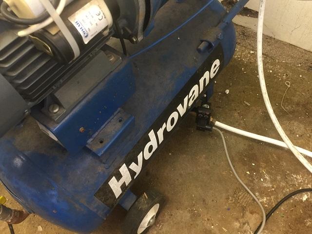

Guys
how practical is it to dry air before the compressor ? Reason is I’ve just bought a 6 month old compressor ( the guy ,I am sure NEVER drained in in the time he had it, so there was a fair amount of rusty water in the tank. I have drained it, allowed to stand open but mus5 admit I’d like to sluice inside with isopropyl or something to ensure it’s dry.
Is there any practical way t9 dry the air before the compressor pressurises it? I know I should drain after every session. but sometimes forget and an nervous about a 50l tank at 150psi sitting there. OK it’s only 1 year old now but  avoidance of a problem always seems a good idea to me.
i do have water trap on output etc so no issues with tools in use.
all suggestions welcome provided they’re legal.
regards Ian

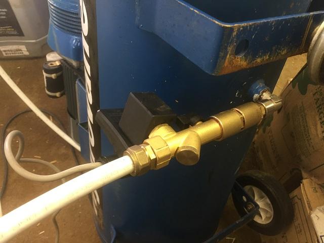

« Reply #1 on: March 15, 2020, 01:47:20 PM »
Fit a timed electric drainer. They cost peanuts on eBay and work really well

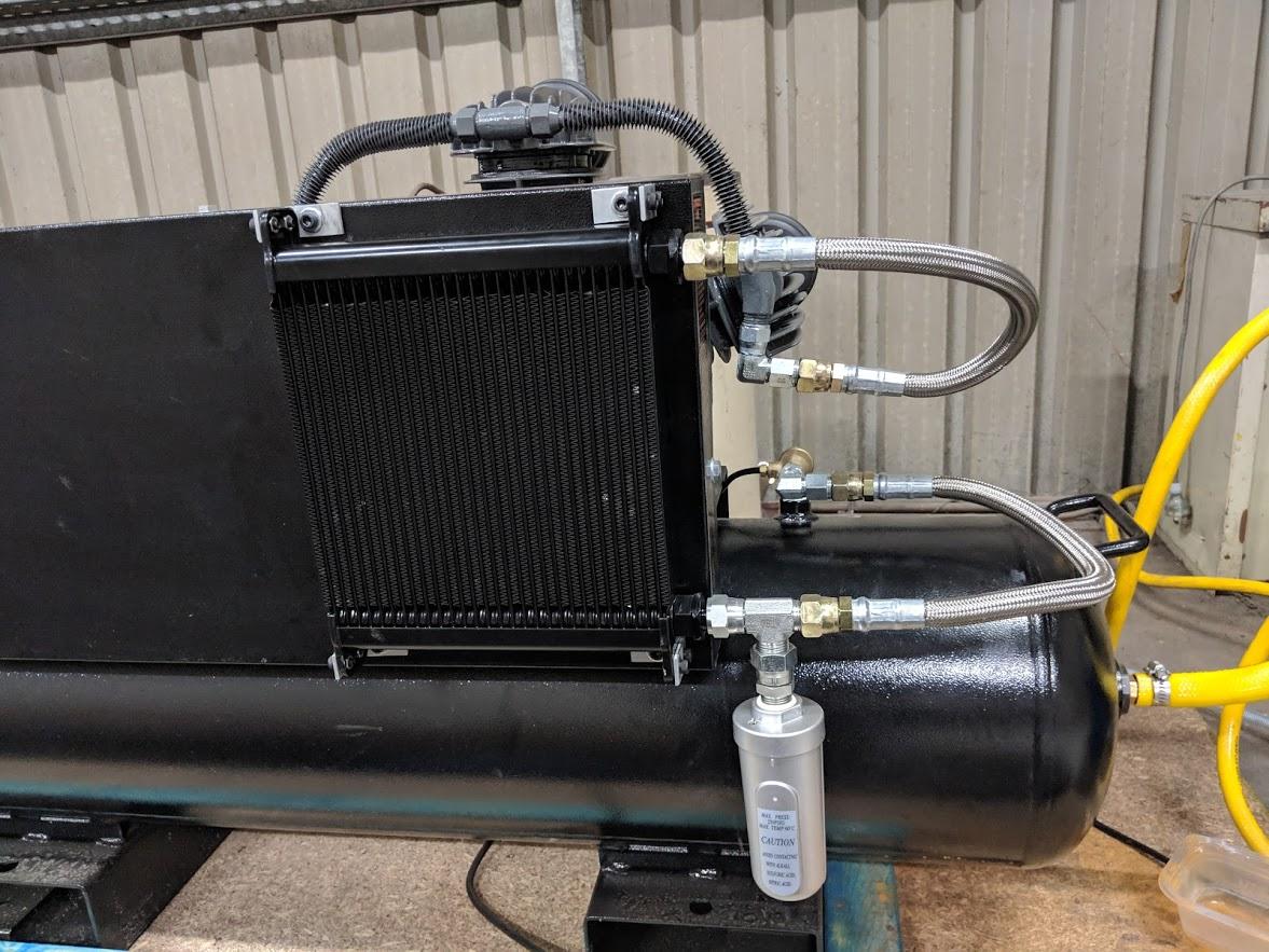

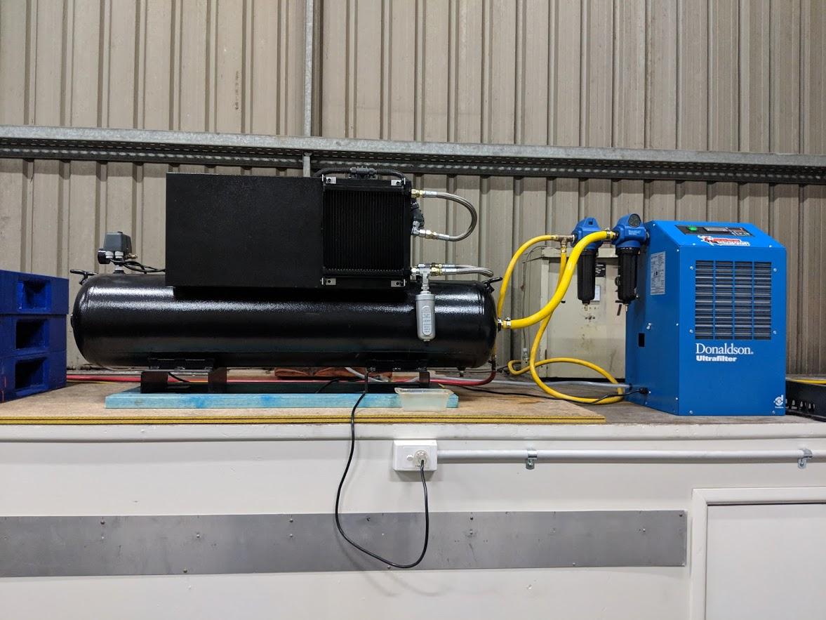

« Reply #14 on: March 29, 2020, 05:54:14 AM »
When I researched this, Commercial systems typically had a compressor, a precooler, a storage tank in that order followed by a refrigerated drier.
So the key to this is to get the air inlet temperature down low enough so the temperature drop that the drier can achieve hits the dew point to maximise water removal.
So my solution to this was to add a transmission cooler and some flexible hydraulic hoses between the compressor and storage tank so that the fan in the compressor pulley draws air though the precooler. I placed an auto drain at the lowest point. This is extremely effective in cooling the air entering the tank and removes some water. An electric autodrain  drains the tank at regular intervals and is not expensive at all. The inlet to the pre-cooler is too hot to touch and the hose into the tank is always cool to the touch. I've been meaning to alter the plumbing so the air travels up from the auto drain so there is more chance of water flowing back to the drain.
So when the air hits my refrigerated drier, it is reasonably dry and the dewpoint is always hit. The drier came with self draining pre and post filters and no further filtering is required I now have perfectly dry air all the time.
