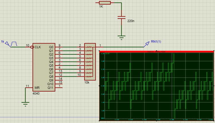

So this is going to be an attempt to make sense, of what kind of simple circuits could be used with analog hexaphonic guitar pickup.
I felt that it isn't fair to clog the optical pickup thread with this subject, so here we are.

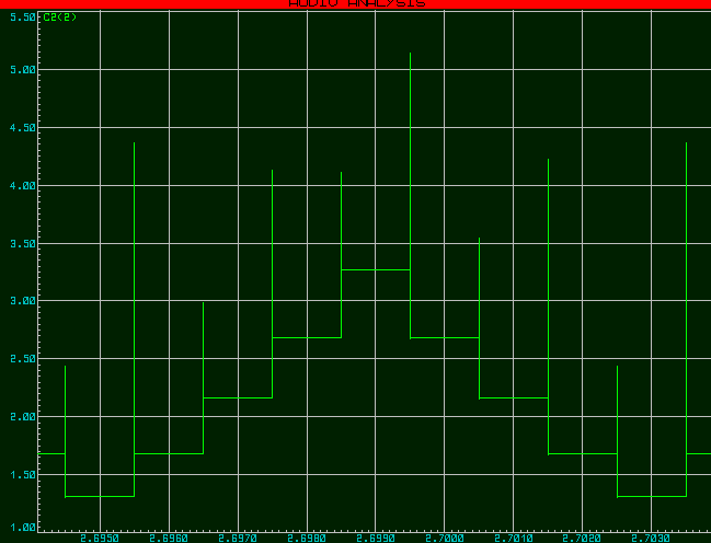

But to the point. To get started, I'm aiming for outputs, that have more harmonics in them, than the plain square waves, that the pickups produce(there are clips on the optical pickup -thread).

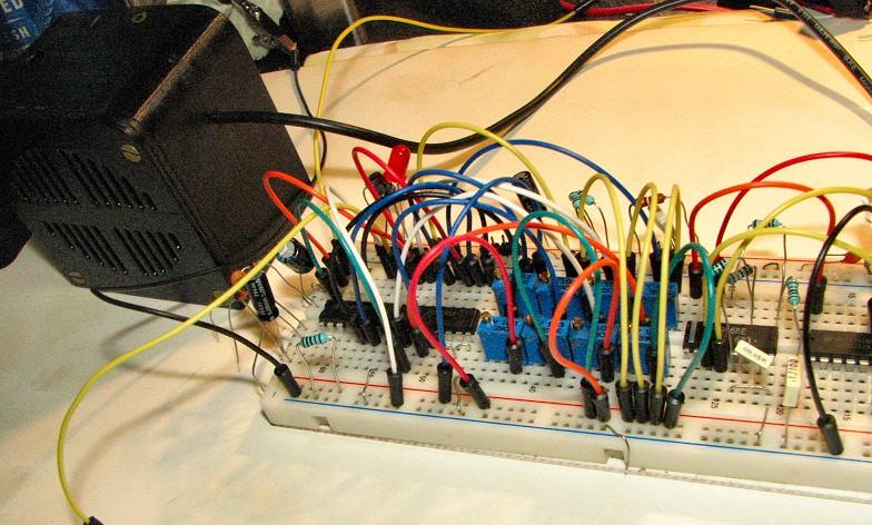

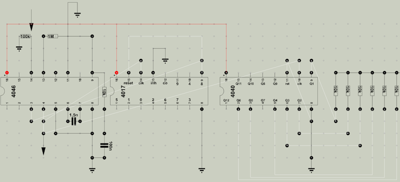

Here is the first circuit, that I have already simulated, and tested on breadboard:
That waveform isn't in sawtooth form, that I was after earlier, as it was used on many analog synthesisers. It sounds like this(saved from the simulator, but the breadboarded circuit sounds practically same):
It has one drawback in it, though. The fundamental frequency of the output is input divided by 8(In this case the input frequency was 1000Hz, and output was 125Hz).
There was only one thing, that I could think of, to multiply the input by 8, to get the input and output frequencies to match - 4046 pll(phase locked loop).
As the form of the input is square wave, it wasn't problem. That 4046(standard version) requires input to be close to the supply voltage, which was 9 volts.
The amplifying circuits of the optical pickups provide enough output, so that the 4046 is able to track the input signal.
I'm not too good on drawing schematics, but here is the circuit, as it was breadboarded(10k resistors on the right present resistor network):
In practice, it seems to work.
Then, after some searching on the net about "staircase generator", I found something like this, kind of "sampler" that is based on 4051(8-channel multiplexer):
It sounds like this:
For some reason, it also has fundamental output frequency, that is divided by 8. The 10k resistor network might not be necessary, but the point is, that the resistors on the 4051's outputs could be replaced with trimmer pots, to adjust the combined output to make arbitrary waveforms.

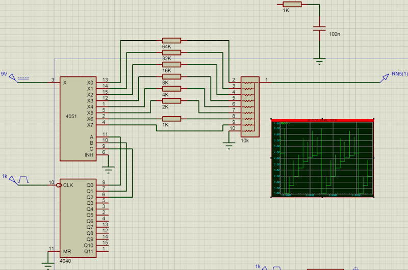

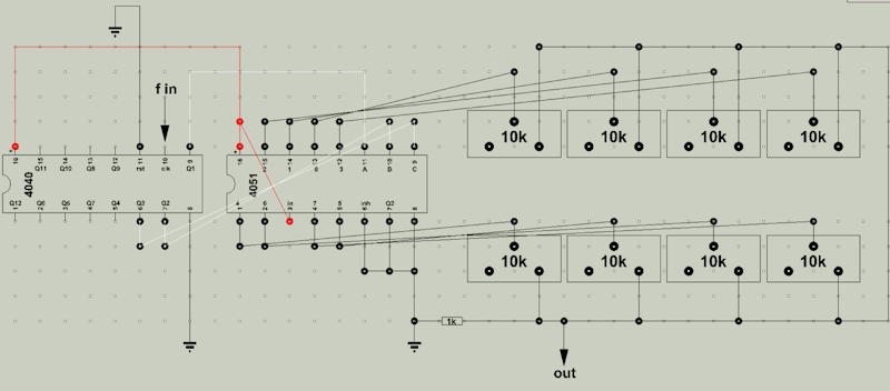

The 4051-based idea of arbitrary waveform 'generator' is now tested on the breadboard, and it works. The circuit:
And same on the breadboard:

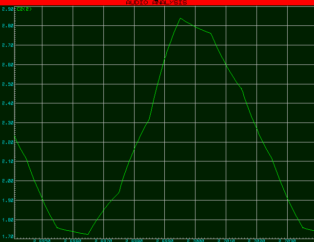

The stepped output waveform is easily modified with trimpots. As there are 8 outputs, there are also 8 adjustable steps in the wave. Triangle-ish one:
And same after filtering:
One thing, that I noticed, when looking the combined waveforms on the scope, is that it couldn't track them too well. All kinds of wiggling happened. Maybe the produced waveforms are more complex, than they look.
But on the other hand, I think I'm going to build(at least) two or three of those 4051-based contraptions. Perhaps some with fixed waveforms. For the adjustable ones, some kind of futuristic, retro indicators would be nice to have, to visualise the form of the wave without the need of using scope. Something like 8x8 Led matrix comes to mind. But we'll see.
As mentioned before, that circuit also divides the input frequency by 8, and therefore needs 4046 and 4017 before it, to multiply the input frequency first by 8.

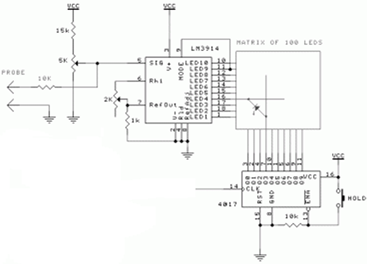

So now I'm hooked into testing/making a visual waveform indicator for that 4051-based generator. As usual, the simpler it is, the better it is.
One possible candidate is something like this:
I already have the two 3914's(actually from an ancient led-oscilloscope project) and 4017's on my shelf. Plenty of leds also(from the same scope project).
I tried to simulate the above circuit, but the results were very quirky and useless. That's why I'm not a big fan of simulations. Certain rules must be obeyed, or the result is garbage.
So not much of  'diy circuit bending' allowed.
Usually at that point I move straight on to breadboarding, but this time both boards are occupied by other circuits, that are still under testing. Jolly good.
But no matter what, I'm going to test that circuit above, to see if it's clumsy or useful in practice.
In fact, even if there are several of those 4051-based devices, only one "plugin"- 'display unit' is actually required. After all, they need visual indicator only, when adjusting the waveform. Multiple, permanent displays would be a lot nicer, though.

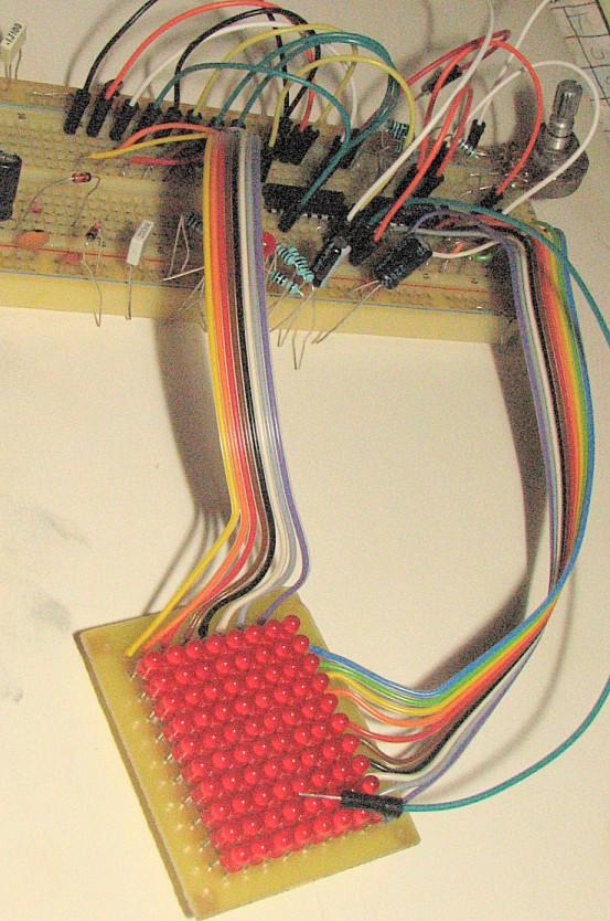

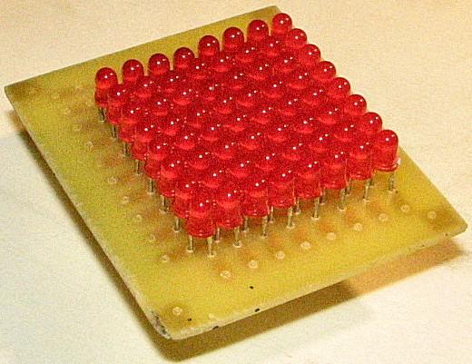

Led matrix isn't easy to breadboard, so I decided to build one, for 10x8 leds. Last two rows will be added tomorrow, and rest of the wiring:
So far, all the rows seem to work, as expected. Needless to say, that it's rather tedious to build things like that. Local suppliers have a very limited selections of the led displays, so one should see what's available on Ebay. But for now, I'll skip that option.
On the other hand, what could be better, than recycling components, that have gathered dust for years on the shelf?
What comes to that 10x8 led matrix, if the idea, that I'm after, works, it could be used as a single display for something, like three 4051-based generators. Not really multitasking, but for one generator at a time, when checking/adjusting the waveform.
While scavenging leds from the old led-oscilloscope project(it had 16x10 leds), I got an idea, that the 8-step waveform generator could be extended to have 16 steps for finer adjustment. Probably not worth doubling the parts count, as it could still sound the same as 8-step one does.

So the led matrix is built, and the circuit is breadboarded:
The led "display" shows different waveforms, but not exactly in a way, that I was after.
As on the oscilloscope, there should be a trigger function, which keeps the waveform from wandering back and forth. It is possible to do, by adjusting the 4017's frequency, but the "triggering" depends also on 3914's input signals frequency.
One might wonder, why I'm so eager to add a visual indicator for that 4051(8-channel multiplexer)-based waveform generator. It's simply because I just love all the bells and whistles it could be a lot easier to remember, what kind of set of adjustments sounds good or bad.
Like a connection between aural and visual 'image'. For example, a guitarist, that uses one or more effect pedals, has an image in his mind, of what his favourite sound 'looks' on those pedals in a form of settings.
Currently, the 4051-based circuit is on the breadboard, and has 10k multiturn trimpot for each channel. Dirt simple option could be to use slide potentiometers instead, for a good visual reference.
Although the slide pots tend to be quite pricey(at least the decent ones), I consider that as a plan b, if that led display-based idea fails.

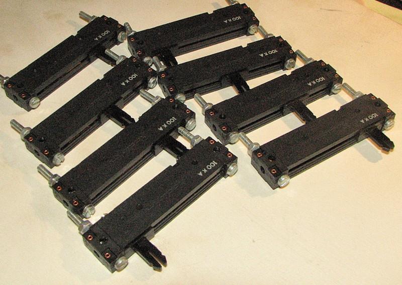

Well, I did tinker with that led display, and it was hours of fun, but to make it usable.. too much of a hassle.

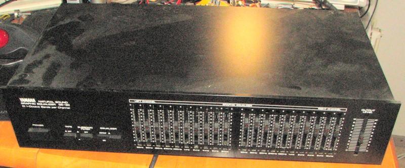

Now it's time to get back to actual sound making circuits. Next thing is going to be to test, how these can be used, instead of 10k trimpots(to adjust 4051's output levels to form the waves):
They are 45mm ones from Velleman's graphic equaliser kit, that I once built, but never used.

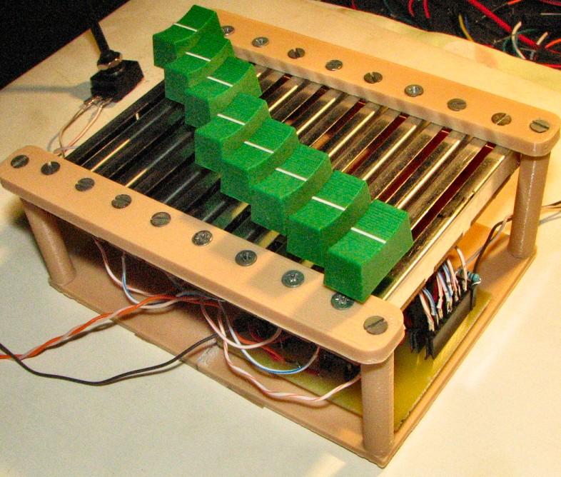

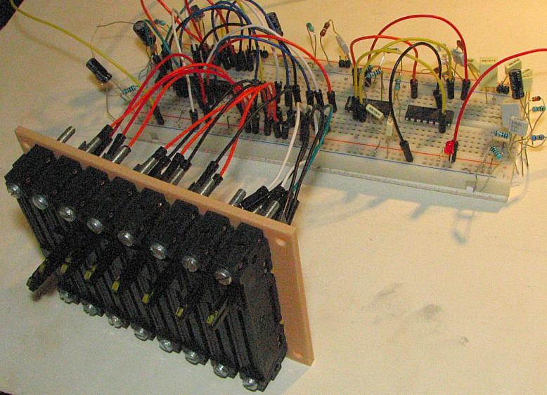

Test setup with slide pots:
Although the pots are logarithmic(audio), they already feel a lot more natural, when adjusting the waveform. Almost like kind of an audio mixer. But instead, they adjust steps of the waveform. If it was an audio mixer, log pots should be perfect for it.
But is it(an audio mixer), as its output is audible, but the signal is made of dc voltage? Beats me, as there are plenty of different elements in project like this, of which I can't make any sense at all.
So after all, linear slide pots would be a better option for a visual reference of the waveform, and I'll probably order some in the future.

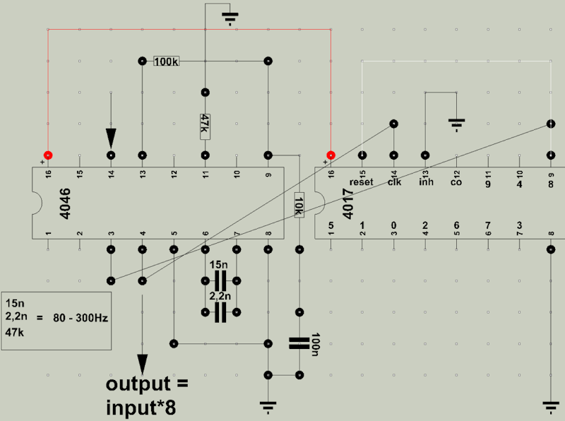

This time a bit about 4017-4046 -based frequency multiplier, like it's wired on the breadboard:
4017(decade counter) divides its input frequency by 2 to 10, depending of how it's wired. On the above pic it's wired to divide by 8.
Quite straightforward, when compared to 4046 (phase locked loop), that does the exact opposite - frequency multiplying, by the factor, that 4017 divides it. 4046's output frequency is then input * 8.
That output is then fed to 4051-based stepped waveform generator, and as it is 8-channel multiplexer, it's output frequency is divided by 8(took me a while to figure that out).
Anyways, that 4046 needs some 'tuning', to get it to work on a desired frequency range. It's easier to do that on higher frequencies, but under 100Hz it gets finicky.
On a guitar(using standard tuning), lowest frequency is about 82Hz(e).
It's not a problem to get the 4046 to track even lower frequencies, but, lower the needed minimum frequency, the narrower the range. There might well be more 'advanced' ways(meaning, that I should understand, what I'm reading) to expand the lower frequency ranges, but, again, simpler it is, the better.
After some fiddling, the above circuit now works from ~80 to ~300Hz, using 9V supply. That should be enough for the three thickest strings(e-a-d), if played on the 12th fret, or lower.
When adjusting, or 'tuning' the 4046, using first potentiometers, makes it a lot easier. But not so on capacitors, as the variable ones seem to be on the picofarad range only(as far as I know).
Then I got this idea of making sort of adjustable capacitor board, by using a rotary, or other switches for the range of 1 to 470 nanofarad. After all, it could make dialing between different values more sensible, instead of having dozens of capacitors, that need to be plugged in and out one by one.
Don't know yet, how to achieve that, though. Maybe it's good enough subject for the next sub-project.

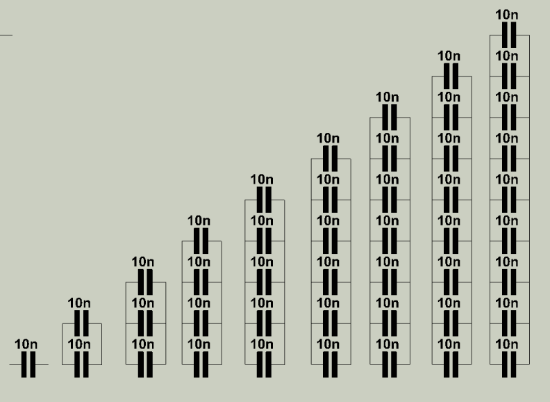

To get back to that previously mentioned 'variable' capacitor board, I had this in my mind, where caps could be added one by one, in parallel(to add capacitance).
But naah, I can't figure out, how to do it that way. Then on to the net to see, what kind of devices are available. Decade resistor boxes, also some capacitor ones, but not really anything dirt and cheap enough for diy purposes.
Actually, just minutes ago, when writing this, this half-baked idea popped out of thin air:
So then I thought: hmm, why not use 45 caps instead of 9, to make steps from 0 to 90nf ?
Using the same pattern, first select hundreds, then tens, and then ones, if needed. Three 10-step rotary switches for that perhaps. Definitely not as pocket friendly, as the potentiometers are.
135 caps for the range from 1 to 999nf. Plus three rotary switches. Plus I have no clue, does it work in practice.
Price of the components shouldn't be too prohibitive, if the aim is to use that contraption for lo-fi audio, or other such things.
I have one old rotary switch somewhere, if memory serves. If I manage to find it, I'll do some testings with say, 6 cap sets, using probably other switches too.

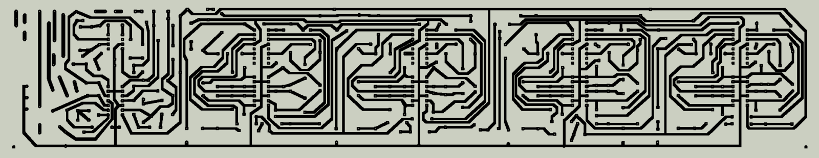

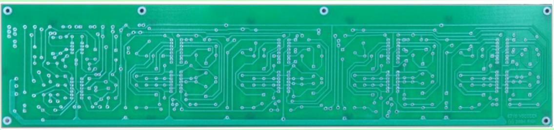

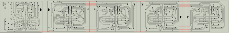

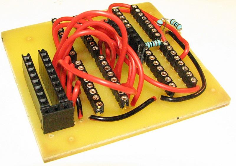

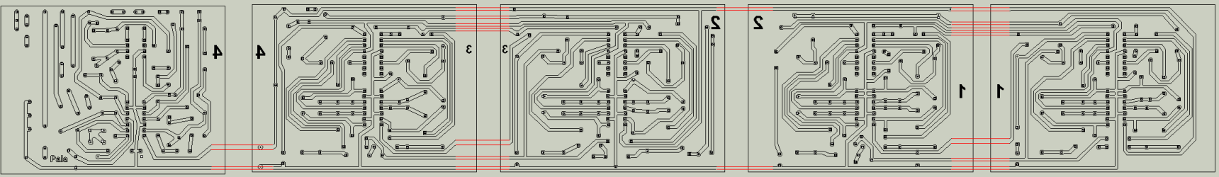

Almost finished new board for frequency multiplier 4046-4017 and waveform generator 4040-4051:
I used headers for the parts, that adjust the capture range of the 4046, so they can be changed, if needed. Longer headers on the left are for slider pot connections(and also for future testings with something like ldr's).
Sometimes I wonder, why on cmos counter chips(like ones used here), the outputs are in awkward order. Should need hair-thin pcb traces to get them all to the same side in order, and even then, some of them cross each other.
On the other hand, that shouldn't be a problem, if one was able to make two-sided pcb's. I have some in my shelf, but haven't yet got that far, to start testing different methods/techniques.
Could very well be worth it, because I just hate using many jumper wires for a pcb, like above. Lots of room for stupid mistakes.

Circuit with correction in red:
Now it works, as it should. 1M pot on the right side will probably replace the 100k resistor, to make 4046's tracking speed adjustable. That together with 100n capacitor(can be anything from say, 10n to 10uF) provides the "timing" for it.
As mentioned before, 4046 has plenty of options, of how to make it sound/behave. In the past, I once found(accidentally) a combination for 'portamento' -like effect.
Back then, I used guitar with standard monophonic electromagnetic pickup, as a signal input. In certain frequency range, it sounded like a Theremin(https://en.wikipedia.org/wiki/Theremin), that 'slides' between notes.
Outside of that range it just went nuts, and sounded like farting bagpipe. If memory serves, I recorded that. Not sure if it still exist on the hard drive, though.

Not much of a progress, as I'm still waiting for those linear pots. In the meantime, the mixer now has an enclosure:
For now, I'll probably use two 9V batteries to power it, to keep amount of running wires as low as possible, as it needs bipolar supply.
After I manage to make few more devices to form a 'basic' effect setup, then it could be sensible to gather them in one single, larger 'panel', where connections between devices could be made by using patch cables. A bit like an oversimplified version of this (https://synthesizers.com):

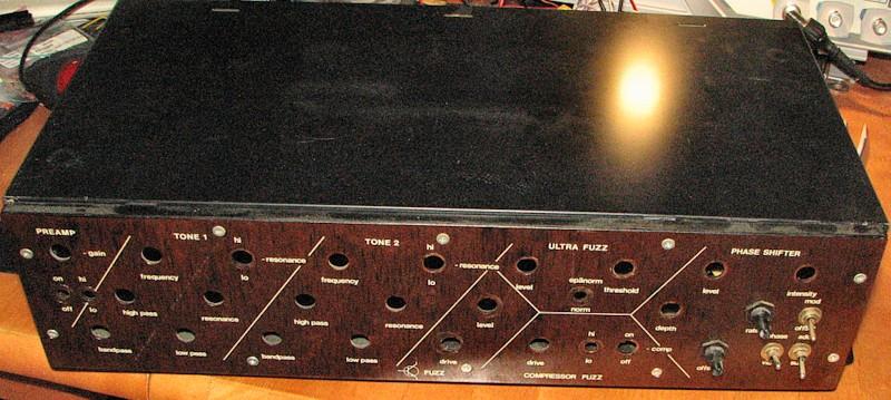

I have one of those 80's cassette player enclosures ready for that. As can be seen, it was once used for a project, that never happened:
Another one is this stereo graphic equaliser, which should still be in working order:
It could have its uses, as a part of the effects board, as it is now. But if not, again one enclosure more, to use for something like a vocoder. After all, it has been gathering dust for last 15 or so years.
So the overall possible scenario might look rather ambitious, but I don't care too much about that. One step ahead, at a time, and sometimes(in my case often) two steps back.

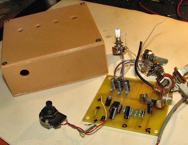

Circuitry with linear slide pots:
It has a skeleton 'enclosure', as I'm not yet sure about possible additions. 1M pot on the left is for 4046's tracking speed, but it needs one of the timing capacitors to be  "variable" also. It needs to be tested, which cap values are most usable, though. Then rotary switch to select between them.
This current circuitry's output should be made ready to be fed to more than one devices, like mixer, filters, or echo/delay simultaneously. So It might need a buffer/splitter for its output. There is a project 26, 'Spluffer' in the Craig Anderton's book, which does exactly that.
Once I get the mixer together, then could be a time for a bit of break in building, and trying to figure out, how the hex pickup setup works/sounds with this circuitry, that is monophonic after all, meaning, that it should handle single notes(like on single string) just fine, in the range of 80-300Hz, with current 4046 configuration.
So it should be good to use with thickest string(e) output to accompany other strings. But we'll see, how that turns out in practice, as there are already many(so far uncertain) factors involved.

Today, when testing the mixer, using function generator and a scope, I found it to be mesmerising to watch the waveform to morph from one shape to other, as I turned the mixer's knobs.
Yes, I'm easily amused by things like that.
But anyways, there were only two waveforms to play with, and I haven't even yet listened, how they sound, when mixed together. Should be hours/days/weeks of fun. Especially, when third waveform/source, or filter is added to the mix.
All the stuff are almost ready for aural testings. If(when) that works out as expected, then it's time for replacing the tiny, battery powered audio amp with some kind of headphone setup, to hear the nuances better.

I was going to test the hex pickup today, with the step waveform generator. I had completely forgotten, that it has a very quirky power connector, that needed to be wanked around to make a contact.
Like wallwart ones, that has a center hole in the plug. Both the plug, and socket are brand new, so perhaps they are of different size.
But yeah, that bugger ended the testing session effectively. Instead of feeling like flattened pancake, I'll get armed with the trusty stomping shoes.
I'm thinking of ordering mono jack -type connectors instead. Also the whole power supply scenario needs to be replaced with something more 'universal', or 'centered', having several regulated 5 and 9 volt outputs, and (possibly variable)split power supply outputs for 15-18 volts too.
Hmm. So many plugs and sockets, and wires. Maybe it would be a better idea to gather all, so far built circuitry, including power supplies, in a one larger box, that was mentioned earlier.
So that will be the subject of the next sub-project.

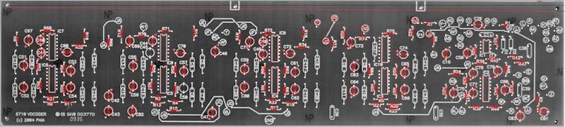

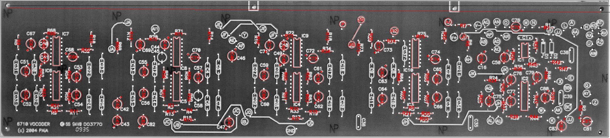

The 8-channel vocoder, that I mentioned earlier, I found stuff about it on my hard drive. What makes it better, is that it's so much simpler, than any other ones that I've checked so far.
I'm going to draw the pcb using this image, as I haven't found any better images of it:
Length of that pcb is about 430mm. Too big for me to make, so I'll divide it to 3 or 4 parts.
« Last Edit: October 02, 2022, 01:39:38 PM by vtsteam »

The vocoder pcb almost redrawn:
It has some tight spots, that needs to be taken care of, though.
I'm redrawing the component designators also, as the image is too blurred to be (possibly)transferred to the component side of the pcb(haven't done that before, but well see):

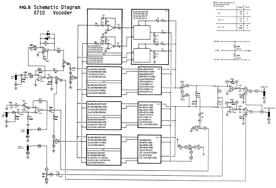

As can be seen, it's Paia Vocoder. Originally it was published as a project in Keyboard Magazine by Craig Anderton, in the 80's.
There doesn't seem to be too much info about it on the net, as many of the builders seem to look for fancier, 12, 14, 18, or even 24 channel ones.
I have a feeling, that this humble, 8-channel one is overlooked. One reason for that could be, that the actual kit on the Paia website is out of stock.
But on to the pcb itself. As mentioned before, it will be divided to 3, 4 or 5 parts, and probably stacked together, to make it a whole lot narrower.
Of course there is one major factor, of how to verify, that the redrawn pcb actually works, as it should? I'll be doing some checkings/comparisons with component designators, and what not, before dividing it into smaller parts.
It uses 5 x 4136, and 1 x 301 -op-amps, which are fortunately available from my local supplier. It also uses 4 x 570 or 571 compander chips, that I already have in my shelf. Rest of the parts are resistors, pots, caps, switches, and connectors.
It requires bipolar -15/+15V supply, which takes us back to the previously mentioned need to make a more 'universal' power supply.
After all, I have to remind myself(all the time) to take only one step at a time.

Divided vocoder pcb:
I decided to use 75 x 100mm pcb's as they are already available in that size. Cutting the pcb is something, that I've never managed to do properly.
On the other hand, I have only used 1,6mm boards, and have scored them to get cleaner results, but they seem to be too thick for that, and the edges tear. Maybe 0,8mm ones, which I'm going to order next, are more suitable for the 'score and snap'.

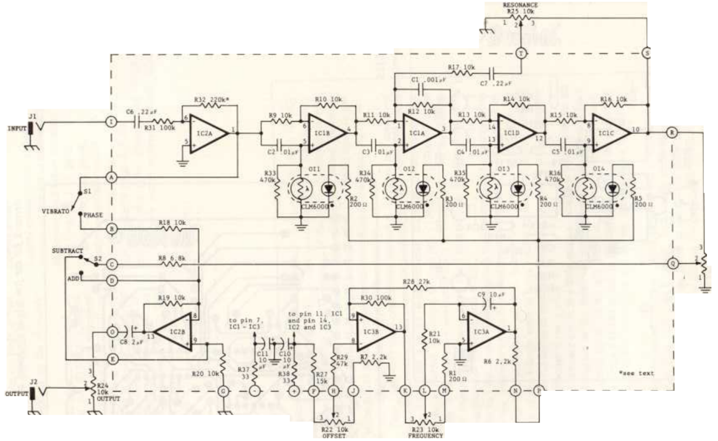

While reading through the vocoder's assembly and user manual, there is a mention about "clarifying mod". It uses 4 x 084 op-amps, and some resistors, so I'll order parts for that too.

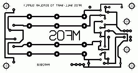

While waiting for the ordered parts, I made a 15V split power supply pcb: http://musicfromouterspace.com/analogsynth_new/WALLWARTSUPPLY/wallwartbtmcopper.gif :
It needs an ac wall wart to power it. I have only one, that is for 12V. I was ready to order 15V one, but then thought: hold on, doesn't dc wall warts have already an ac output in them, that is rectified by using diodes to make dc voltage?
So I had to look, what I have in my boxes of 'stuff'. Surprisingly, there was 15V/500mA dc adapter, that didn't seem to belong to any device, that I use. I managed to open its enclosure, and took some measurements with multimeter. Yep, it could perhaps be used for the purpose.
Only two wires needed for straight ac output. Actually I'm going to use its dc wires for that, as they have a nice strain relief clamp already. No extra wires or holes needed.
But there is one very serious precaution, though: to do something like that, one must be extra careful, as there is live 220V(in Europe) involved, when that adapter is connected to mains.
Disclaimer: If in any doubt, don't do it. If one still insist doing it, that one takes full responsibility, of what he's doing.
Only once I've had 220V shock, and yes, it was indeed very nasty, so I'll do my best to avoid messing with it.

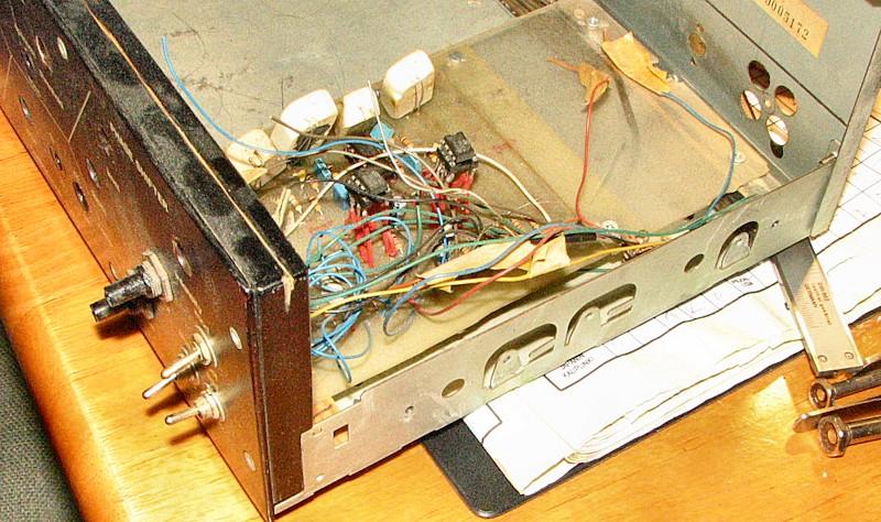

When looking inside of that previously mentioned ex-tape recorder enclosure, there was dust and a phase shifter:
I doubt, if it's still in working order, after two decades, due to corrosion of the pcb traces. As can be seen, two ic's are configured to substitute original op-amps(super-rare 4739's). White blocks are diy optoisolators(led/ldr), to replace original Clairex CLM6000's(that were probably never available outside US, but what do I know).
Quite a mess, that is worth only for looting socketed ic's, pots and switches.
I'm considering of rebuilding that, but what comes to optoisolators, they need some fiddling(when using ordinary leds and ldr's) to get them to the 'working range'.
Or just re-use the components inside white blocks, and look, what kind of mods I did use back then, to get them to work.

The pcb for the vocoder needs thorough cross-checking, using the schematic(down-sized to fit for the page):
Luckily most of it is repeated 'blocks', like op-amp and compander sections in the middle. Only the component values vary between them. But still, tedious task to do, so I'm expecting to take a break of it at some point, and do something else, like building the phase shifter.

Cross-checking that vocoder pcb is indeed very slow thing to do. I had to restart from the beginning a few times, to find better ways to approach it, and perhaps learn something in the way.
So far I've found several missing traces, and errors, when compared to previously drawed one, using that blurry image.
But after all, no matter how long it takes, I guess it could be worth the effort. If not, there are always plenty of other vocoders to choose from.
In the meantime, I have also had some ideas, like making the filter sections 'variable', using headers for their capacitors. Originally the cap values are for 200, 400, 600, 950, 1300, 2200, 3000, and 4900 Hz. But we'll see, once I get there.
