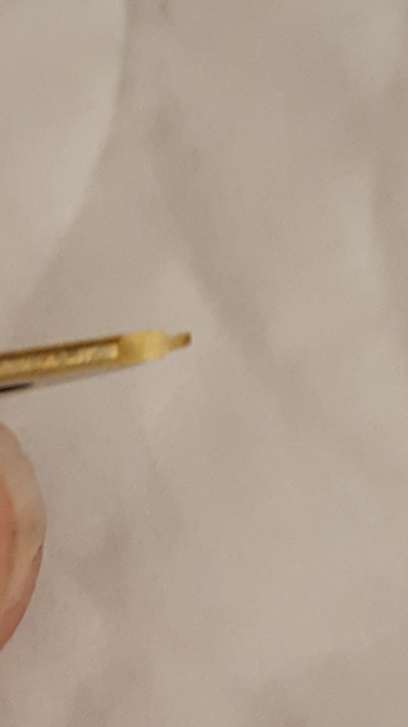

I need to machine a circlip groove in a 3mm silver steel shaft for some circlips.
Circlips themselves are 0.6-0.7mm thick and are 2.3mm.
So to the collective, I put it to you, what’s the best way to tackle this?
I tried an abrasive disc ( my fav method.) in my Dremellookalike but the end brg is knackered so it wobbles like a jelly….I tried Stew Harts method using a slit saw….hmmmm some erroneous noises made me abandon that idea…
Silver steel doesn’t machine like EN1a sadly….so open to suggestions please….
What works for you?

Grinding bits of Eclipse hacksaw blade, just below the teeth, if you have something that can hold it like a parting blade.  Otherwise sacrifice a small HSS drill bit in some metal stock you can hold in a toolpost. Your dodgy Dremel can part profile it, do you have diamond stones for finishing ?  Keep stick out to a minimum unless you have a pile of small drills to use.
Oh !!!  Is your silver steel part unhardened ?

Steel is not hardened…
I’m thinking using a broken 1/8” centre drill suitably profiled to make the groove, sharpened on my t and c grinder..

« Reply #3 on: March 19, 2024, 02:16:25 PM »
Sounds like a good approach to getting it sorted.

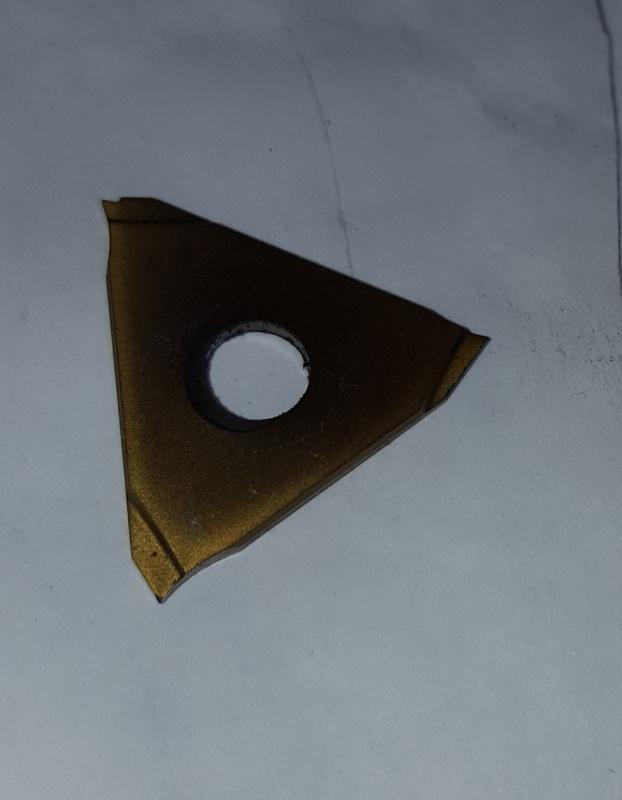

I found a used carbide grooving insert 0.75mm by my measurement.  Might have one good edge, or would sharpen on a diamond lap.
Ph Horn 312.0070.15 1N32
Pm your address and I'll pop in the post

That’s a great gesture….I’ll bear it in mind. Does it need a holder of some sort?
In the meantime, I’ll give some other ideas a go…

Side on it's triangular with a hole in the middle.
Ideally it needs to sit in a V open at the bottom . It's not difficult to make if you have a mill.

Nice insert Bill, that's given me ideas for my own tooling cut from hacksaw blade.  Times like this I wish I had an EDM machine  :thumbup:
