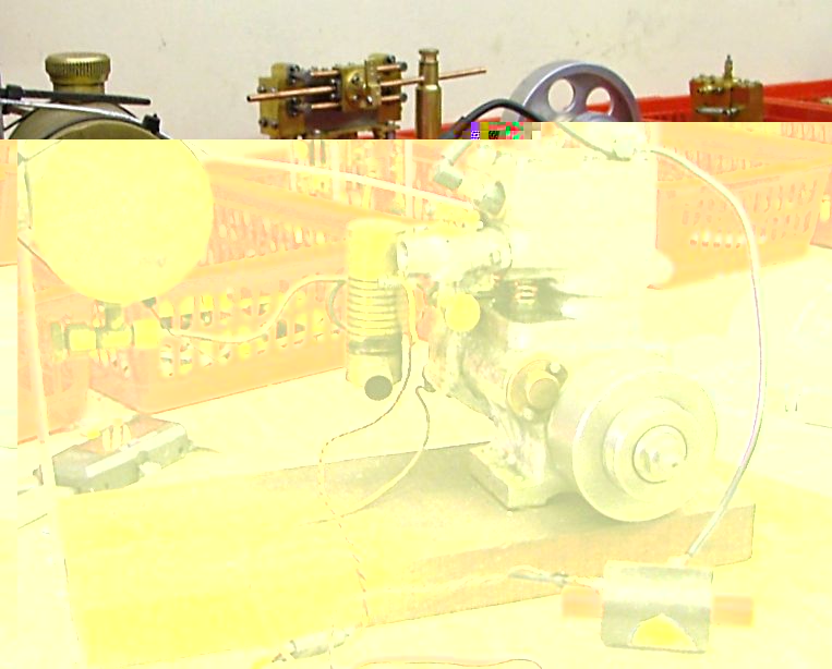

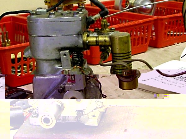

Here are a couple of pics of the last ic engine I made, after having a long running in session. It is still sitting in my shop in the same condition. I never wanted to, or ever will finish it off after getting it to run OK. It just knocked ic engines completely out of my system, after struggling with such terrible castings. It would have been ten times easier to have made it out of bar stock, as you have done, and how I made previous engines.
The second picture shows the mounted hall sensor and the magnet was mounted in edge of the small ali disc. Those two parts take the place of the points and condenser. No wear, and you can cover it in oil, and it still runs perfectly
Bogs

The engine is actually the Westbury Whippet, and the castings for it are available from Hemingway. But they are so bad they are almost unusable, especially the head area ones. I had to get a friend to build up areas of the casting with ali weld, just so that I could carry on with it. They were up to 1/8" out in places.
Those coils are now not available, and were made for fitting into model aircraft with 4 stroke petrol engines. They are only about 3/4" diameter.
The inline switch is in fact where you would mount the contact breaker or in my case, the hall sensor.

Is there any other way to accomplish that?
Easiest way could be to buy a whole new needle system. But not yet.
In the meantime, I'm going to make a vapor carburetor, as it surely can't flood the engine :dremel:.
