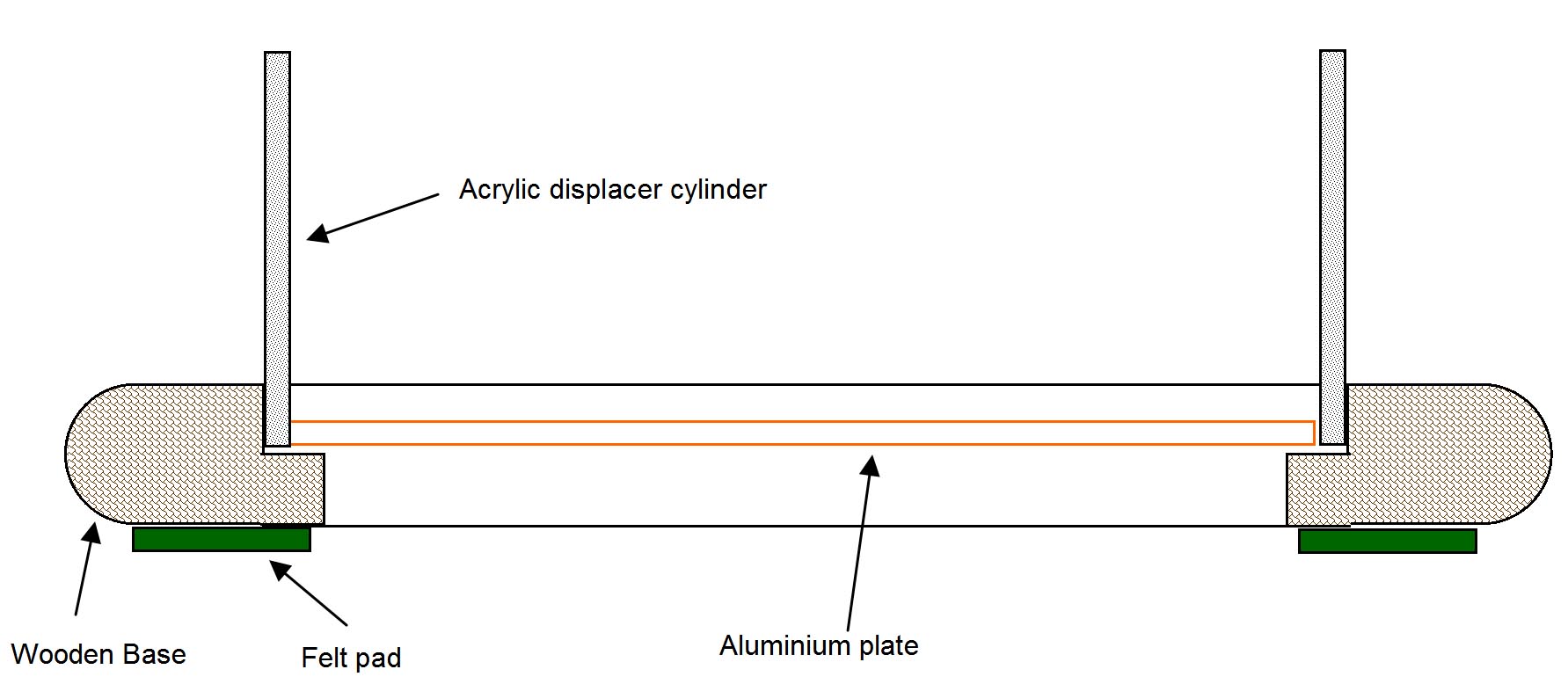

Been thinking about  the economiser idea, fattening the displacer piston and filling the inside with aluminium mesh or whatever to make a regenerator. By doing this less heat /cold would need to be added/subtracted from the working fluid which would reduce the thermal impedance issue as less energy would need to be transferred. The outer sides of the displacer could be made from foam with a cutout in each side, diametrically opposite, to force the working fluid to pass through a long cavity with the mesh.
One part of the current designs for coffee cup engines I find fundamentally flawed is the use of a base made of aluminium. Only the part over the cup needs to be aluminium, the surrounding part could be a ring of wood/ plastic or any other reasonably insulating material. Just changing this will result in an increase of available energy and a longer running time. A base of wood with a green felt bottom which had a 90mm hole with a 95mm recess for the circular aluminium plate and displacer cylinder, would be a functional and aesthetic improvement. (see dodgy skectch). I'm not sure that I'm up to making that but if I can pick up a preshaped circular base putting a hole in it should be a piece of cake. Of course a wooden base would preclude the use of running it off of a tea light.

Hi all, just as a matter of general principle, your dwell time/surface area for both the heat and the cold surfaces fairly equal all factors considered.  I would think you'd be better off with equal factoring between dwell, temp differential, and surface area to keep the engine balanced fairly evenly.  As for regenerator material, stainless steel is the ticket as it absorbs it and transfers it very poorly, so it won't transfer heat from hot to cold side by conduction, and the movement of air through the material is relatively constant, just changing directions kind of like a sine wave if you graphed it over time.  The smoother the cycle, the less energy absorbed by the bearings and available for drive.  Just some thoughts I've had on the subject, not as if I'm an expert, just interested amateur. :smart: mad jack
