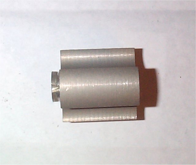

About an hour of tumbling with good old Steel BB's. Taken the sharpness off the edges with no other noticeable material removal. Ill give it another hour or so and take a peek.
All I'm looking for right now is a repeatable, easy debur operation.
Robert
Looks good. I forgot, are you using a rotary, or vibratory?
I have jar of my sons BBs here, but there the copper coated ones. Wonder what would happen if............ :scratch:
Offline foozer

« Reply #54 on: February 06, 2011, 11:58:18 PM »
Rotary tumbler, from what I have read this type works better at debur while the vibratory does better at finish.
Oh  current run is with 1/2 cup of the copper coated BB's dry. Part if left in overnight will get a dull black color to it. Might just leave it in overnight, the BB's wont remove any material so . . .   famous last words? Maybe Ill go down and check it
