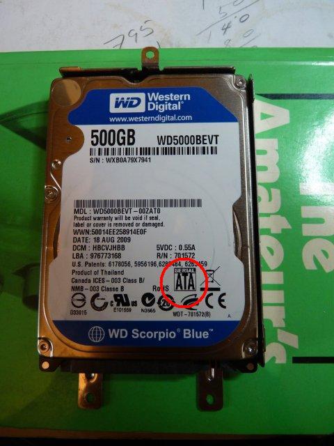

« Reply #6 on: June 26, 2013, 03:16:48 PM »
Well that was easy ,,,,,,,,, no hammering needed
any clues  :scratch:

....any clues  :scratch:
On your photo, just above/left of the CE is a "Serial ATA" logo - so its a SATA drive and you want to look for a SATA enclosure or adapter.

Good point Dave
The drive could be dead  :palm: , i will order a SATA enclosure .
