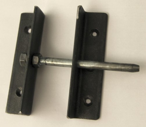

Use one 1/4" and one 5/16" pin so you can't reverse the cope and drag.
The Alloy Avenue guy mentions that carriage bolts with the head sawn off make good pins, and I can vouch for that.

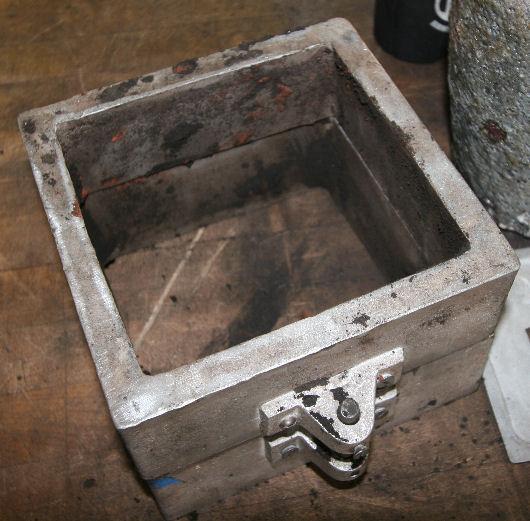

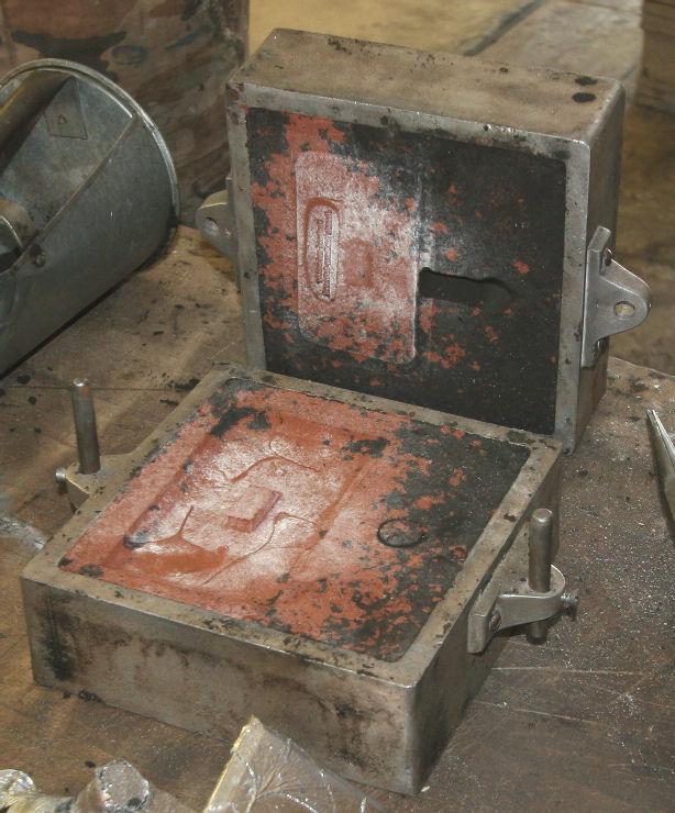

Pat, this is what I'm talking about wanting to make:
MetalCaster
Re: Oil fired crucible furnace
« Reply #40 on: July 20, 2013, 12:39:26 PM »
Ironman makes it look easy.
Not only has he mastered iron, he has mastered green sand.
My sand too often is to wet, or too dry (I use oil-based sand), or something else goes wrong with the sand, and just about time I get the mould done and all the gates and risers cut, it all falls out of the flask half.
Some put a groove or two in the walls of the flask, but if your sand is right, you probably can use a bare inner wall.
Here are a few made locally.
I would try and make the tabs on either end cast integral to the unit (I think in the photos below they are screwed on).
I will have to review Ironman's tabs to see if they are cast on.
And the pins seem abnormally large in the photos below, but the flasks I have which use 1/4" carriage bolts on one side are prone to getting out of alignment.
In the future I will use 5/16" and larger bolts for the pins (different size either side).
I only have wood flasks at this point, but hope to make some metal flasks one day.
Metal ones last a lot longer than the wood ones.
Edit:  Yep, ironman uses an integrally cast handle, as I suspected he would.

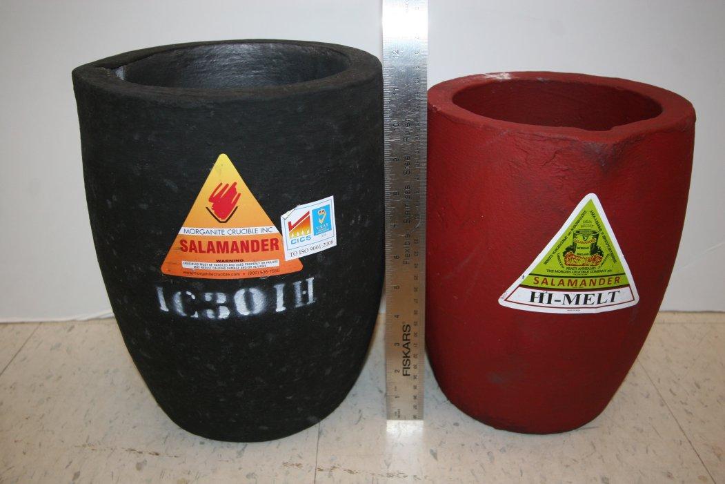

I have not had any problems with the Morgans, but there are different grades even within one manufacturer such as Morgan.
The rep told me that for non-ferrous work, the Morgan "Hi-Melt" was the most long-lasting, and this is a silicon carbide crucible.
The "Hi-melt" is rated 1000-1400 C (1830-2550 F).
For ferrous work, he recommended the "Salamander Super" which is rated 850-1600 C (1562-2912 F), and these are clay-graphite.
The brochure mentions that they can also be used for non-ferrous work.
Note in the photo below that both are labeled "Slamander", which is very misleading given the fact that one is only rated for 2550 F and non-ferrous work.
I think you would get good service from either of these two units if used with the respectively rated metals.
I have also heard reports of crucibles cracking if not placed back into the furnace to cool slowly.
I put mine back in the furnace just to keep them clean, dry and protected until they are cool and can be stored sealed in a plastic bag.
Morgan mentions many things that will damage a crucible such as heating them too fast when they are cold, causing uneven thermal expansion and cracking, improper loading, lifting and supporting from the wrong position, not keeping them dry, etc.
I think the silicon carbide units have to be fired at least once to seal the glaze before they are used to melt metal.
Morgan also mentions not letting the flames impinge directly onto the curcible.

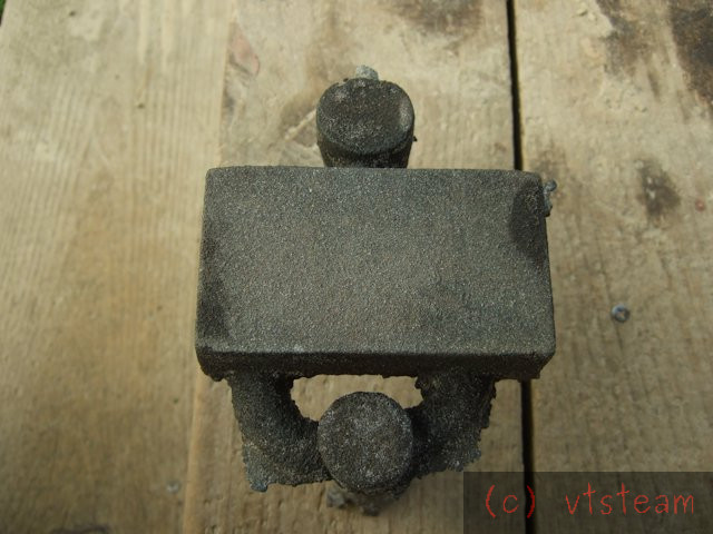

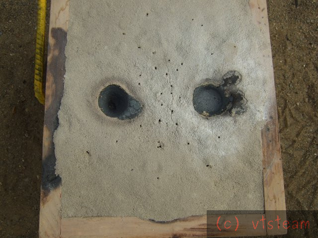

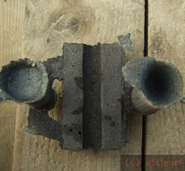

I made several changes and cast iron today.
First change was the enlarged exhaust hole in the furnace lid.
Second change was reducing the size of the sprue from 1.25" to 1" in order to keep it choked with metal.
Third change was to add some of my 140 mesh sand to the 60 mesh greensand I have used recently. About 15% was added.
Fourth change was to ram somewhat lighter
Fifth change was to use no sodium carbonate as flux
Sixth change was to preheat the new crucible to red heat at moderate burner throttle before adding metal.
Seventh change was to alter the pattern to include a semicircular groove to form a greensand core. This piece willl later be bored out, and the cored channel will make this easier. It also reduces the the mass of metal poured..
First Try:
I'd like to say everything worked out, but unfortunately I poured short. The much larger amount of slag of a very pasty consistency fooled me into thinking there was more metal in the crucible than there was -- and that it was hotter than it was when i dipped in a poker and it came out clean. Also the gates were a little shallow, so basically I ended up with a nice bar ingot of about 3/4" thick, but not a part.
Second Try:
I could tell the pour was short, so I didn't wait very long to unmold. I decided to use the residual heat in the furnace to attempt another melt. So I quickly broke up more scrap, and fired up the furnace. While it was heating I rammed up a new mold. I decided that I'd try a riser in this one as an additional change, but make sure the crucible was full of metal, not just 1/3 slag. I figured my smaller sprue, and the new core groove would give me enough additional metal in a full crucible to afford an 1.25" riser. Also I'd put in slightly deeper gates, and be absolutely sure the metal under the slag was fluid.
I pulled the crucible out when I thought it was ready, and scraped the very thick sluggish slag out of the way where I would pour -- I couldn't scoop it all off easily, as I had when I used Sodium Carbonate -- that stuff really liquifies the slag.
I poured and watched the riser fill to the brim, and had enough metal left over to pour an ingot as well. Good!
In a couple minutes the riser started to shrink down -- which I took as a good sign! Both the sprue and riser dropped quite a bit. Here's a pic:

The part came out well!  The surface wasn't smooth I still don't have seacoal for a facing sand, but the added 140 mesh sand seems to have made for a finer surface grain than before. The lighter ramming doesn't seem to have caused any irregularity or coarse patterns, and the corners look good.
Bottom of the part:
« Last Edit: January 14, 2018, 10:41:08 AM by vtsteam »
  • Posts: 6940
« Reply #48 on: July 21, 2013, 08:57:24 PM »
The top surface shows a big improvement over the last pour of this part. There are only 3 small shallow blow holes -- these will be easily removed with the machining allowance, and when the part is bored -- unless there are some hidden holes. I have a feeling that's all there are.
I believe the reduction in ramming pressure and smaller sprue (which I kept choked while pouring) helped trap less gas, and relieve it where present, creating fewer and smaller pockets. If I go to a shallower cope, it's possible venting and permeability will improve even further.
The greatest improvement was the elimination of the shrink depression. This was probably due to the addition of the riser. The greensand core that formed the channel might have helped as well by reducing the thickness in the center of the casting. Less thickess, less retained  heat at the center. Since the channel also makes machining easier, it was definitely worthwhile adding it to the pattern.
I'm very happy with the results and  feel I'm on the right track. Plus I have a good part!
Here's the top  (dark areas are dampness from a rinse):
« Last Edit: January 14, 2018, 10:41:55 AM by vtsteam »
  • Posts: 6940
« Reply #49 on: July 21, 2013, 09:08:18 PM »
And as a follow-up for furnace operation, the furnace consumed 2.5 gallons of diesel fuel total over the two melting sessions during a 4 hour period.
Actual time to melt for the first pour was 1 hour 5 minutes from lighting, and after a 45 minute cool down, the furnace ran for an additional hour to achieve the second melt -- which had more metal.
The crucible looked in good condition, though I couldn't remove a fair amount of pasty slag this time because without flux it was tough stuff  to try to scrape out. I put the crucible back in the hot furnace to cool slowly, so I'll get a better look at it tomorrow. I think it is retaining wall thickness better than the first one had. It felt solid, not leathery during the pours.
