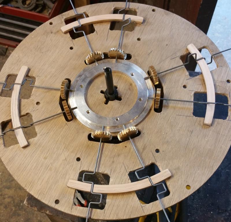

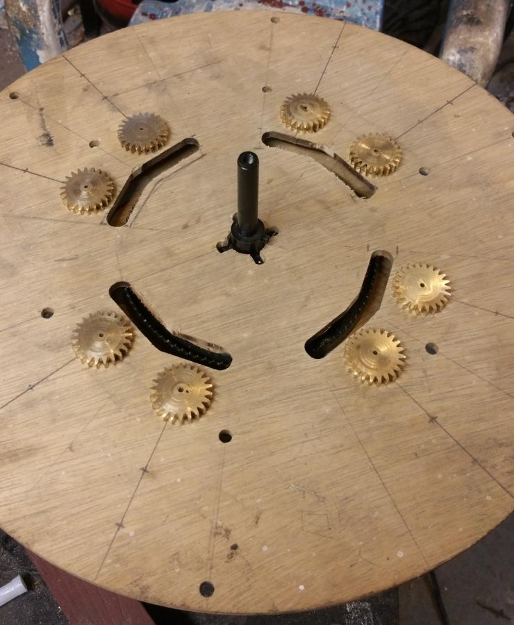

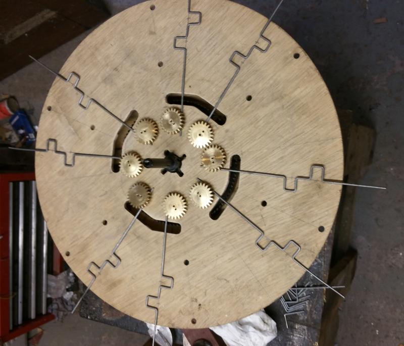

Finally have progress to report on this long drawn out project. The major stumbling block (apart from getting sidetracked with other things) has been gearing to move the horses up and down and I have finally solved this problem I brought a 115 tooth 20dp meccano crown gear and after many failed tries I have made 8 off 22 tooth gears to match it.

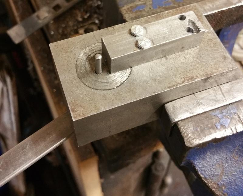

Then I finished the little jig for bending the wire which the cams are formed from, it is 2mm fencing wire. so third picture shows all the bits presented in place on the top board which has already had the slots cut to allow the gears to mate with the crown gear underneath. I may have to increase the size of these slots a little as the wire is a little thick to bend sharply for holding the gear in place, I also need to cut out the openings for the cam sections of the wire.
Now I have got over this major hold up I am hoping that progress will be much better now.

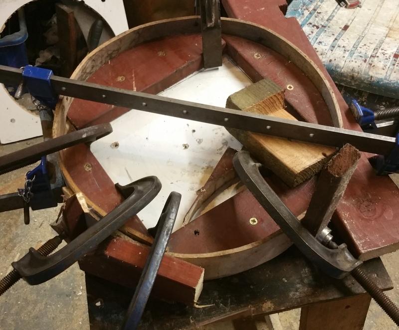

Well after so long with nothing at all to report on this project the progress is dizzying  :lol:

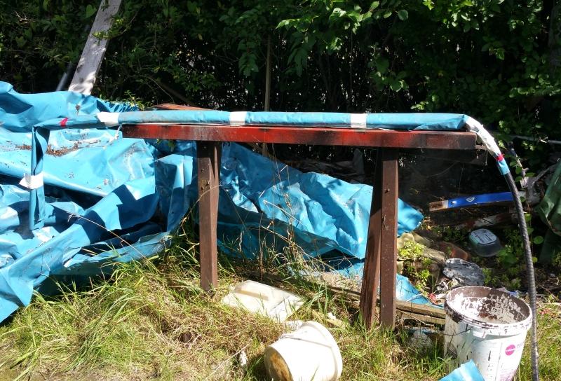

Bank holiday today (sorry Scotland didnt mean to rub it in  :lol:) so first off went around my mates to use his bandsaw to rip a bit of wood into 6mm strips one of which I wrapped in plastic and inserted the pipe from a wallpaper steamer in one end so I could make a circle for the decorated top bit. While at mates workshop I made use of his sander to clean up some little laminates I made as supports for the middle of the cams.
Once I got home I did the circle which took a bit of work as the wood I had was some old stuff which had nail holes and these made keeping a circle difficult I may have to redo this with some better wood but we will see. I glued the supports to the top and once dry I made the channels that the cam wire sits in.
I am still a little unsure how best to secure the gears to the wire, I am thinking of soldering them together but any ideas would be listened to.

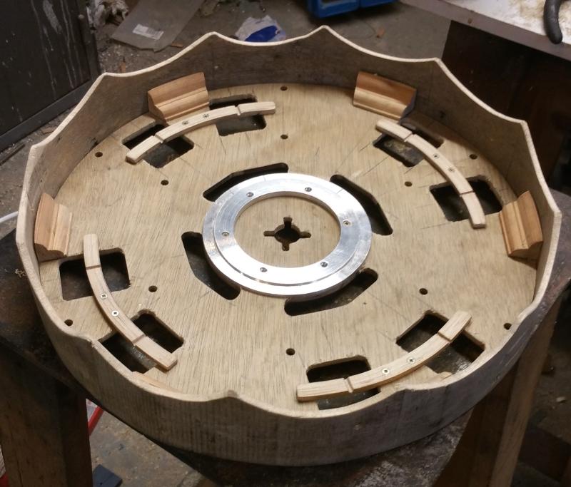

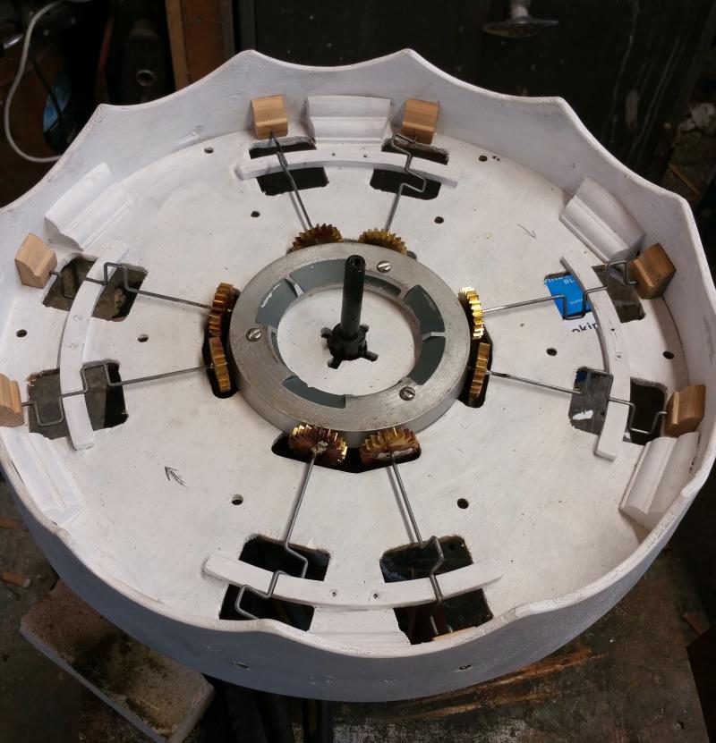

Most of the work on the mechanical bits has been done this weekend and it can all be stripped off again to tidy it all up.

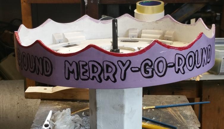

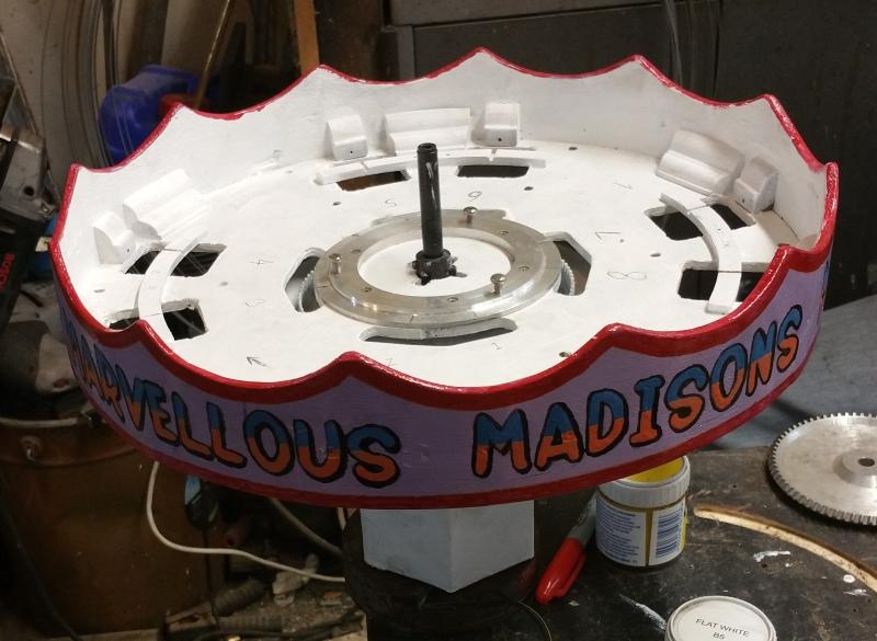

Well not entirely happy with my attempt at the artwork but I guess it will show its all done by hand  :scratch:
The outlining is done and started to do the borders but was not going straight enough so will leave it to dry and mark a guide line before I continue.

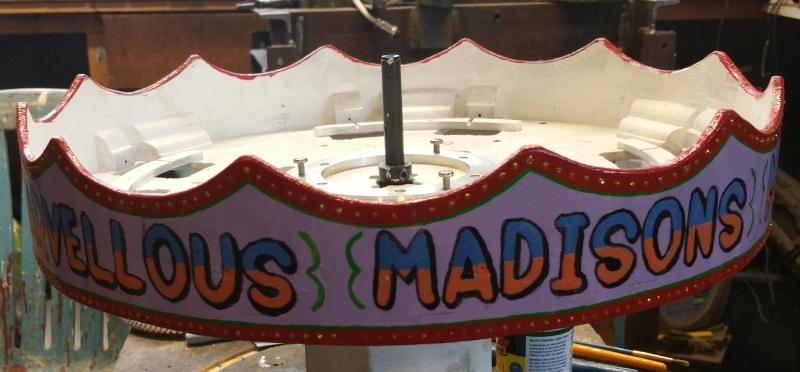

« Reply #41 on: September 10, 2016, 05:27:24 PM »
Bit better

Anyway added some bling today.
editted to put correct photo in post.
