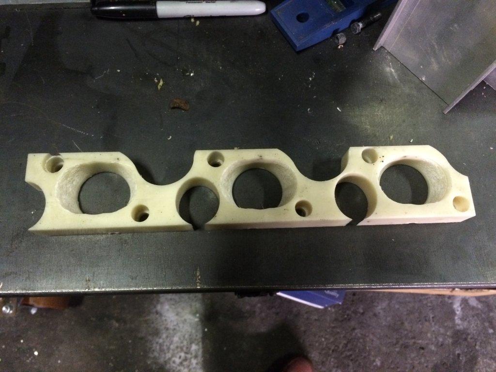

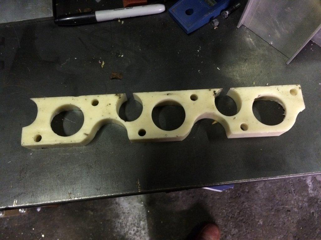

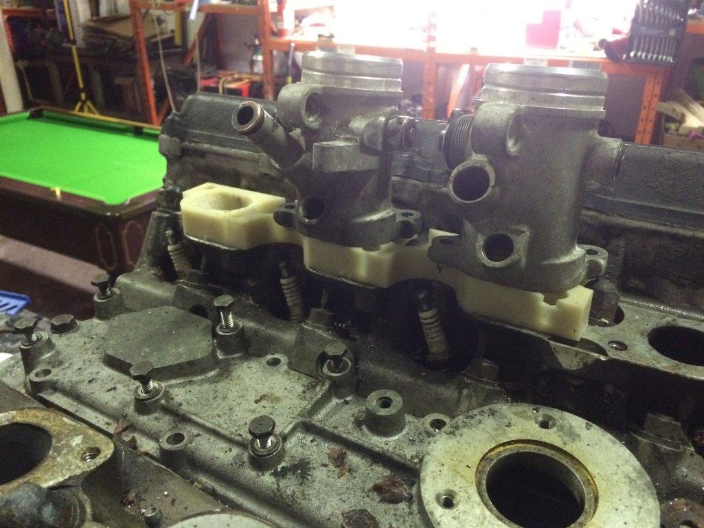

Meanwhile, over on the engine bench, the manifold adapters are starting to take shape. As ever, a wax prototype is called into existence, it's cheaper than trying in aluminium, and if the tool paths go a bit awry, you don't damage your cutter.... It's not really visible in the finished item, but the left-hand intake hole actually started cutting half-way down - a 10mm plunge which would have destroyed the cutter bit or the workpiece - or both - had it been aluminium...
  • Posts: 2492
Re: Jaguar XJS V12 racing car
« Reply #33 on: September 29, 2014, 12:40:32 PM »

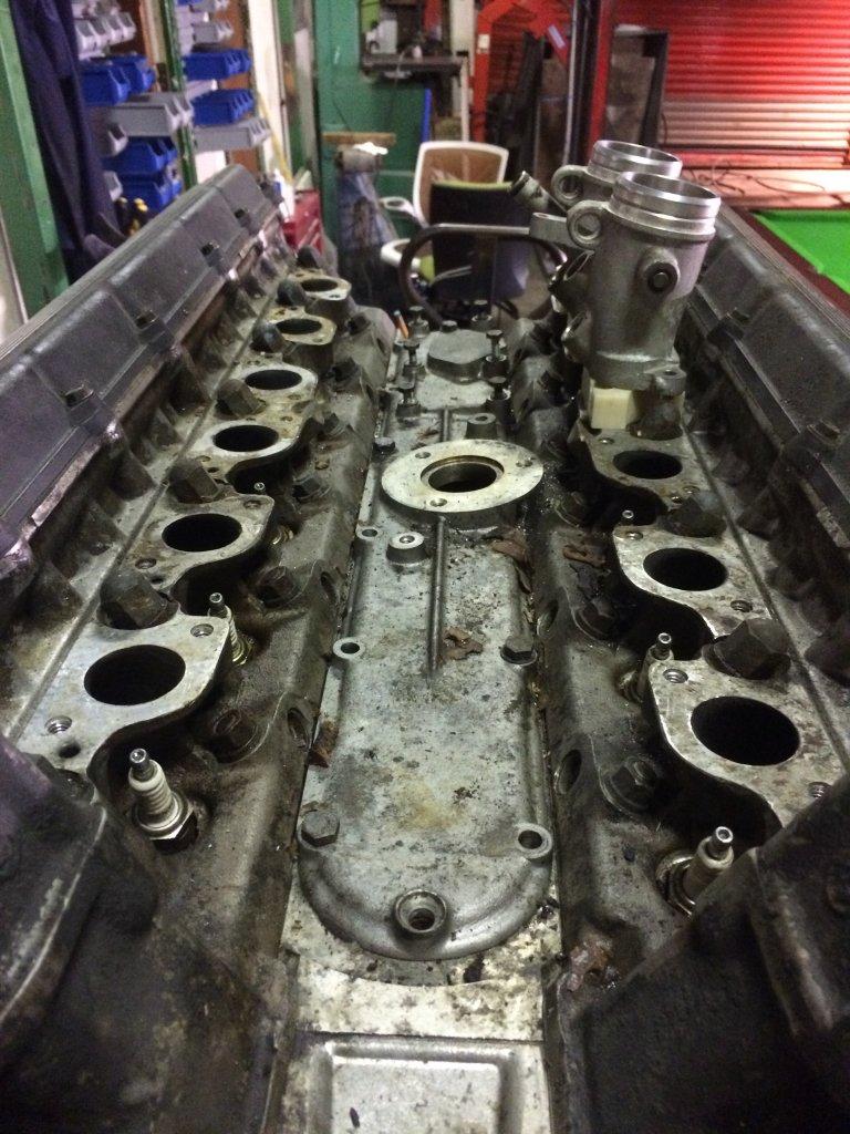

There's a bit more to do on those adapters yet - there's another "layer" to go on top which will hold the ITBs; the two layers will then be bolted together. The reason for all this malarkey is, the bolt patterns of the Jag head & the BMW ITBs interfere something chronic. A single piece adapter is not possible because the Jag head bolts interfere as well. It's almost like it wasn't meant to be...
...but by 'eck I'll make the damn things fit.
Obviously the final version will have smoothed & gas flowed profiles; depending on the flow testing (bench is on the project list), the final shapes might end up being hand-cut rather than CNC machined.
2 pics showing (approximately) how they'll be installed. Note the new distraction in the corner of one of the pictures....

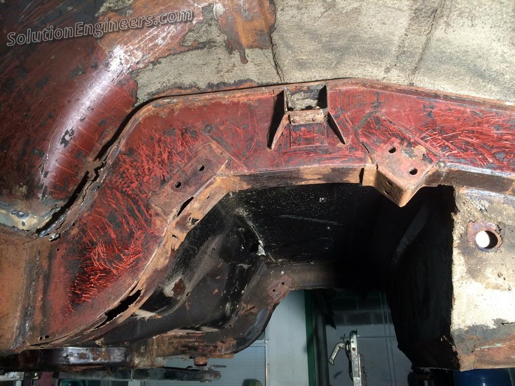

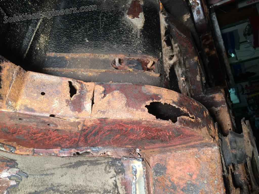

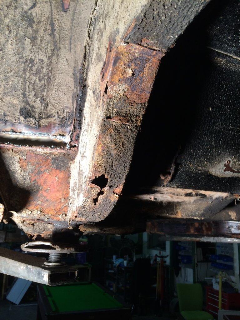

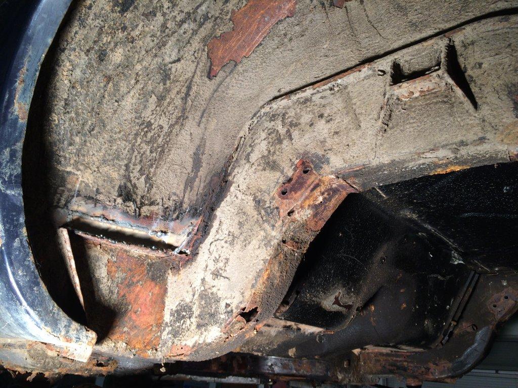

OK, so I managed a bit more time on the old girl yesterday. First up, plenty of heat-gun action on the underseal, followed up with a paint scraper - and, where necessary, use of the plastic mallet to help the paint scraper along. This is tedious mud-in-the-eye rust-in-the-hair above shoulder height work which leaves you knackered, aching and wondering if it was worth it after all.... since it tends to reveal even bigger scabs and holes.
The attached photos are what's left of the nearside rear chassis rail as it passes over the rear subframe. The suspension is mounted to the big plug shaped piece that the car is currently sitting on; if I'd left the chassis alone, this area would be taking some massive forces just in normal racing, let alone taking the odd tap or bash.... An MoT man would have kittens if presented with this much rust to look at...

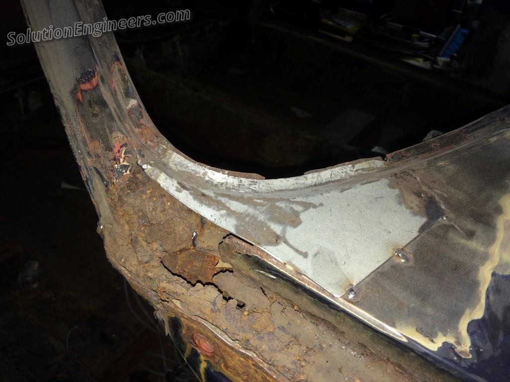

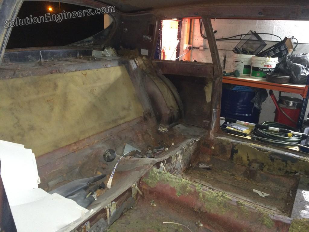

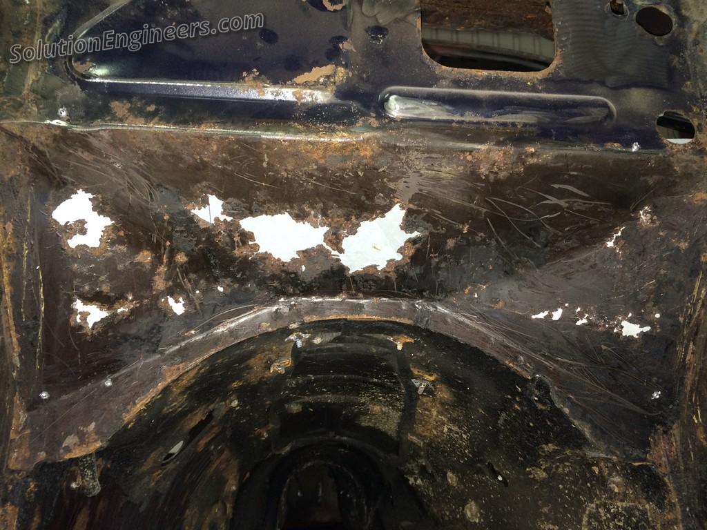

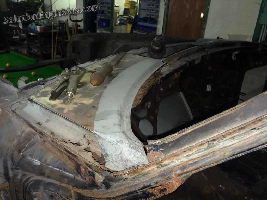

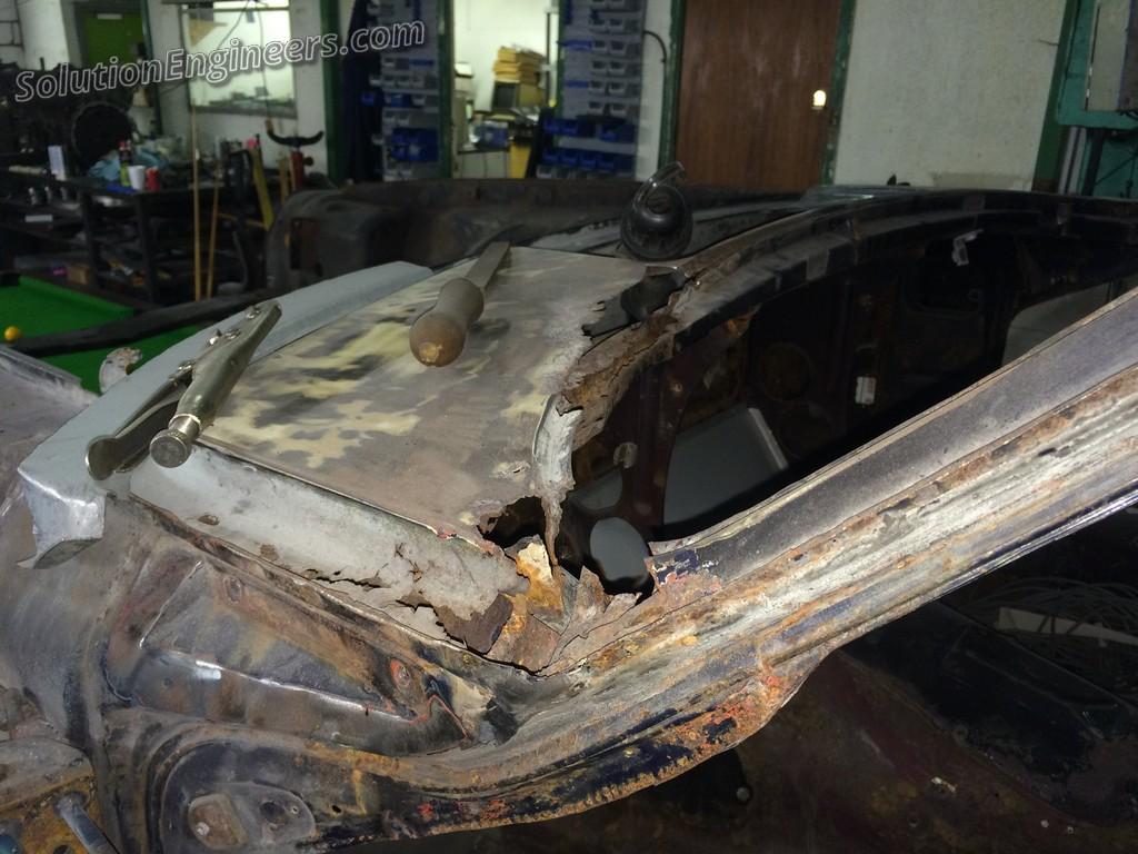

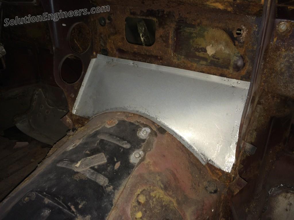

The rust is not confined to the chassis either.... the valance/windscreen pillar bases have taken a hit, and there's more grot around the back  where the rear deck attaches to the buttresses. The first photo shows the problem, the 2nd & 3rd show some repair panels going in place. 4th & 5th show the repair panel that used to be covered by the heater unit - obviously it leaked at some time...

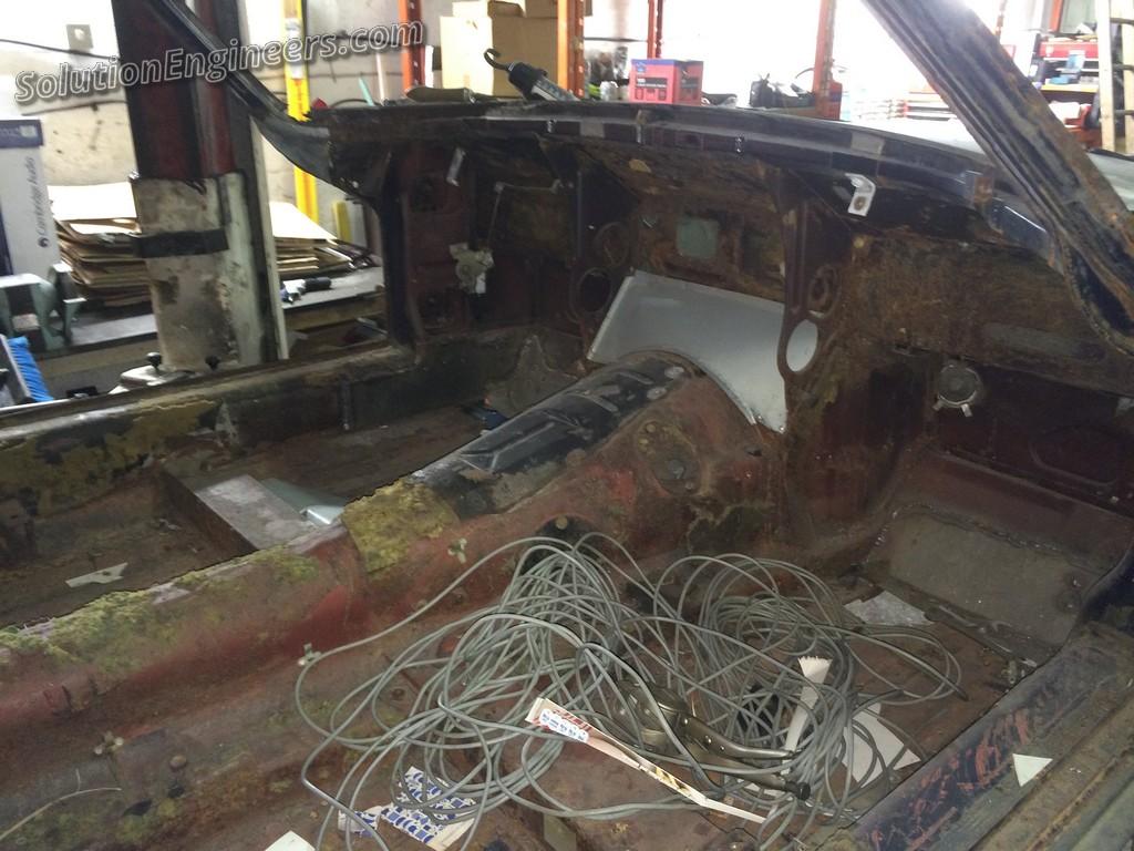

This is what the Big Cat looks like, once you've taken everything out...

Thanks all! Yeah, this shell is probably little better than scrap - and the more underseal and/or paint and/or gobbo (filler, bondo, various other names few of them polite) I remove, the scarier the story gets. Still, it's not all bad. Today, I actually welded something back onto it!
Unfortunately, I only have the "before" photo on my phone (careless!), I will take an "after" photo in a day or so and post them both up at the same time.
