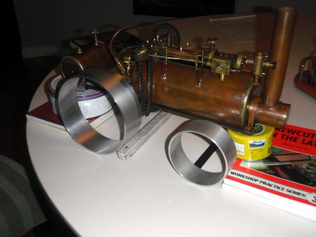

 Having found some aluminum wheel rims I am looking to make them look more authentic like steel rims as I cannot find steel of this diameter.
Can anyone suggest a good way to stain, darken or paint them so they do not look so much like aluminum.
Cheers Mick

Thanks for all the feed back, Would iodizing not just change the colour and highlight that it is made from aluminum. The effect I am really looking for is to have them looking like steel as would be used on a real steam tractor.
Would chemical bluing do this?
Cheers Mick

I totally missed the part about the wheels going on a model engine (not on a car).  :doh:
Sand blast them and paint them the color of your choice. Don't know if you can get it there, but Eastwood sells a paint called Brake Gray for brake cylinders that has powdered metal in it and looks a lot like steel.
Tom

This might be a way to go,
Cheers Tom
